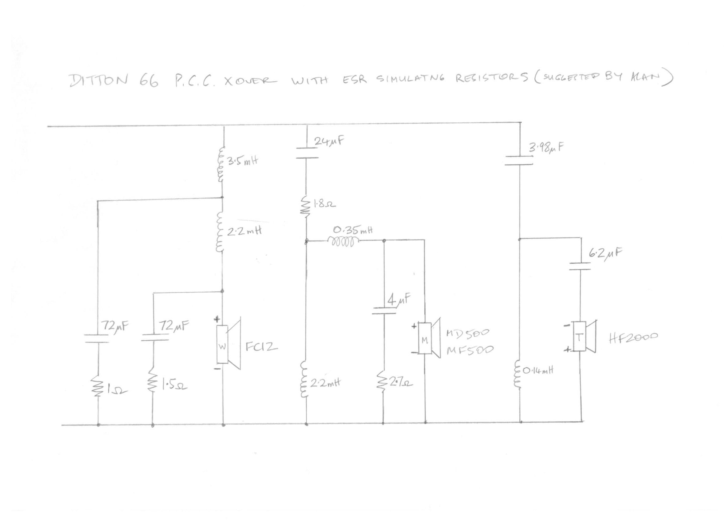

This one someone posted used the SEAS tweeter:
I used Hiquphon in mine and I think the values were similar but not quite the same. Don't have my notes to hand atm.
With thanks to Alan of course ...
could some one send me the diagram for the new improve crssover the links do nt work
I think this is the one you are referring to. It is based on the original drivers and the Celestion revised (printed circuit) X-over design. The ESR simulating resistors shown are the values I used and were originally recommended by Alan.
The design is based on the use of low ESR metallized polypropylene caps like Solens (cheaper) or better sounding caps like Sonicap Gen 1 or ....... There is some support for using Solens for the 72uF caps and more expensive caps in the mid and tweeter circuit in order to reduce overall cost.
the crossover

both crossover schematics posted by Patrick Dixon and DennyG are correct,
but if you have the original Celestion HF2000 tweeters, then use DennyG's schematic.
For moderate sized capacitors of good audio quality for the tweeter and midrange filters
use the 250 volt rated ClarityCap ESA series now available from at least two UK sellers,
or the Sonicap 200 volt rated from the USA manufacturer's own web-site.
3.9uF substitutes for the 4uF; and the others can be 6uF or 6.2uF, and 24uF or 25uF.
For the caps in the bass filter the 250 volt rated Solens direct from solen.co
or 250 volt rated AXON from Parts ConneXion - The authority on hi-fi DIY parts and components are smaller than the 400 volt rated Jansons,
thus will fit on the boards more easily.

The ESR simulating resistors used in my crossover were Mills MRA-5 (as recommended by Alan). They are available from Parts Connexion.
could someone please send me the information for the improved crossovers
Hello Kim,
Correction to #846 , plus additions ...
I posted fast, didn't Proof-read, but logged off and left, and now I read a mistake in my last post !
For Solen, it is not .co , it is .ca - at: Untitled Document
Also, there are not currently any exact 72uF, nor 70uF, polypropylene capacitors made,
thus for 72uF, use 33uF + 39uF connected in Parallel, as in Patrick Dixon's schematic,
or use 36uF + 36Uf connected in Parallel as both Axon, and Solen in their 250 volt SA series, currently have 36uF.
If you do not want to connect two capacitors in Parallel,
then I recommend you use a single 75uF cap for the central position - connected to the junction of the two inductors,
and a 68uF cap for the output position - that is directly in Parallel with the woofer connection.
At least one 66 owner in this thread has reported results using 68uF and 75uF as above.
The Mills MRA-5 resistors are available from both Parts Connection and Sonicap's web-site.
Do use the 1 ohm and 1.5 ohm resistors even with 75uF and 68uF caps.

Regarding the 24uF//6uF summing to 30uF in the earlier 66s mids' filter:
Given the various plots that contributors have posted in this thread,
I think 30uF is too much for the MF500, and that 24uF, {or 25uF if buying from a brand that has 25 and not 24 }, is more suitable.
Further-more, given the plot from jt954 in #804 on Page 81, it seems that 24uF may be too much for his samples,
at least in conjunction with 1.8 ohms Series resistance there.
If his measurement is valid, I recommend trying 22uF and 1 ohm resistance.
For Electrical and Electronics' applications, the word "cascaded" usually means: connected in Series.
The small capacitors in the tweeter filter are connected in Parallel with each other to form two bunches of paralleled capacitors.
The old word used for Parallel in Electronics was Shunt.
You don't have to "shut up" - you can say whatever you wish to here, if you think such will assist readers.
If you still have the original capacitors in your 66s I think you should install new ones before you do more listening,
even if only for the input capacitor for the midrange filter if you decide to try listening without the tweeter,
because if that old capacitor starts to leak significantly the mid-driver will be damaged,
as similarly will the tweeter if any of its filters' caps leak significantly.
You could install a low price 22uF from a local seller, or Parallel pair of 10uFs or 12uFs in the mid-filter for now if you decide to try listening without the tweeters ,
and buy better caps later when you upgrade all the others.
The Shunt connected capacitors: 4uF in mids and 72uF in bass, if leaking will not damage the drivers,
but if they short-circuit excess current will be drawn from the amplifier, and it may be damaged.
So, post here what you have currently in your crossovers ?
You can buy some very good capacitors when you are in the UK, and also have some new inductors wound for the bass filter.
Ask here and I will advise further.
For the bass filter lower DC resistance inductors will allow better controlled bass response.
The inductors in the midrange and tweeter filters do not need to be changed {if not damaged},
because low DC resistance is not beneficial for the Shunt connected ones,
and the DC resistance is part of the Impedance of the circuit for the .34mH in the mids' filter.

Hi, me again.
I was just looking at the two crossover diagrams above and realised they were for the later model printed circuit board.
According to the papers Celestion sent me the earlier "black faced" Celestion crossover had a total of 34 microfarads in the midrange,
eg. 1 x 4uf, 1 x 6uf and 1 x 24uf .
Not sure what the difference is but Bhu 108 might like to know.
Also, they cascaded (is that the right description) a lot of little capacitors in the tweeter circuit.(6 x 1.5uf and 1 x 1uf).
Anyway, I'll shut up now. Reggie

Presumable you are talking about the resistors in series with the 72uF
capacitors that were not in the original crossover? The DIY Audio team have
suggested inserting resistors in series with the capacitors to make them
nearer to the originals - I personally have a problem with this - let me
explain: the original 72uF capacitor were Bi-Polar Electrolytic types -
these are pretty crude capacitors and have 3 major problems (1) they are not
linear with frequency (in other words their capacitance value will be
different at different frequencies which can be a big problem in a filter!),
(2) they have a high ESR (Effective Series Resistance) this is an intrinsic
defect - an ideal capacitor would have zero ESR. There is a problem with ESR
in that it is unpredictable - you can have a batch of capacitors that will
all measure in spec for capacitance but they can all have different ESR
values - so it's impossible to say what the original ESR was. (3) both their
capacitance value and ESR will drift over time - which again is a problem
when using them in a filter circuit where you are relying on accurate
component values. Contrast all this with a modern polypropylene capacitor
that will have a very, very low ESR (something like 0.01 ohm or lower) and a
capacitance value that is both stable with frequency and will not drift over
time. So why would you want to (a) deliberately degrade the performance of a
high quality capacitor by adding a high ESR? and (b) if you did want to add
a particular resistance value to purposely dampen the Q (reduce the gradient
of the slope) of the filter, how do you know what the original ESR was?
The remaining resistors should be in circuit because they provide response
shaping (in case of mid-range) and attenuation in the case of the tweeter.

I have explained the reasons for adding the resistors in Series with some of the capacitors when substituting polypropylene types for the old electrolytics,
but it seems that John does not understand how this resistance keeps the crossover from being excessively resonant ... especially for the midrange filter.
Three-way loudspeakers are NOT easy to design - that is why there are so few good ones on the market, other than very expensive ones, and the messy sounding cheap ones.
The midrange filter is always audibly resonant, except when it is a 1st Order filter -{and that type is not suitable for the 66 drivers }-,
thus one has to design it very carefully so as to minimise the resonances.
John's computer designed crossover does not do that.
Computers cannot hear resonances. The designer has to be able to recognise when a midrange filter will be excessively resonant.
Using 10uF and 1uF in Parallel for 11uF will cause a sibilant sound - I have explained why earlier in this thread.
Better is to use a pair of 5.6uF in Parallel which sums to 11.2uF, and that is close enough, and possibly better if this is for use with a modification I posted earlier in this thread.
