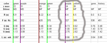

Additional Plots
Hi Alan,
Thanks for your messages. I have a couple more plots, the one you mentioned you didn't have plus another which I've just found. The copy of the mail I showed was pasted into the message, the spacing seems to have disappeared. But the copy I sent was OK
I still haven't heard anything back. Do you have some advice on how to prompt a reply?
Best Regards
Wayne

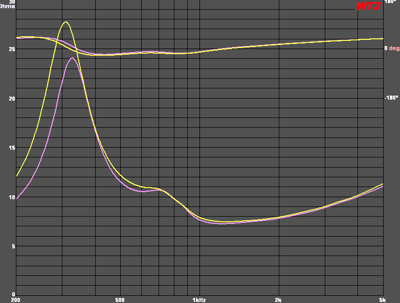

New Plot
Hi Alan,
Here is the plot I mentioned. The previous uploaded .bmp file was empty. I hope you can see it now as it's taken me hours to send due to maximum sizing placed against file extensions!!!!
I could only send it as a 'zip' file.
Best Regards
Wayne
Hi Alan,
Best Regards
Wayne
