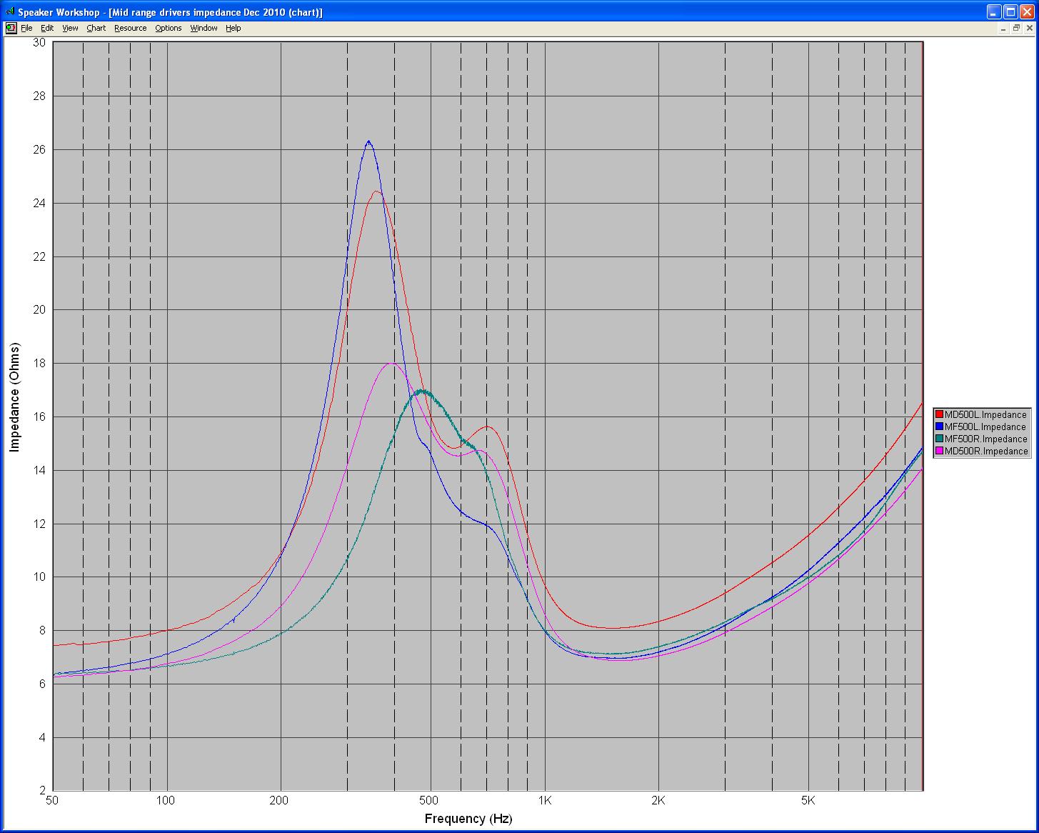

Measure the DC resistance of both your mid domes
-{and add or subtract any meter error if necessary, using 2.7 ohms as the Reference}.
If an MD measures less than 6 ohms, then buy 82 ohm in Mills MRA-12 for use with it.
If MD measures between 6 and 6.4 ohms, then buy 75 ohm to use with it.
If measures 6.5 ohm or a little greater, then buy 68 ohm.
Both MDs do not have to have the same value resistor, and if they differ by 0.3 ohm then using a different value resistor with each, as above, will cause them to match a little closer in sound in the upper midrange.
Buy also two of MRA-5 in 11 ohms, {or 10 ohms if 11 is sold out}.

If you need sufficient time to listen to decide about the effects of the 82 ohm resistors, perhaps Sonic Craft will put your Order on Hold for a few days.
To date no-one's mid domes have measured larger DCRs, but if yours do, then Post here, as they may be OK to use 56 ohms resistors with.
Why this can work is that with slightly lower Impedance at the effective Load, the .34mH inductor will drop a little more of the upper-mids' signal.
There is a limit to how low in resistance the effective load can be made before an audible annomoly occurs elsewhere.
There is another way the upper mids can be reduced slightly, which I will explain when your new caps arrive.

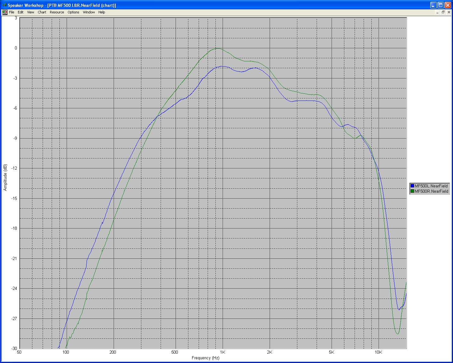

Hi Wayne,
of the 3 Files you included in Post #679 , the 1st and 2nd you had posted previously.
The 3rd one:
"measurements using new crossover.doc"
you had not previously posted.
This one shows part of what is wrong with that crossover, and as I had expected would show, and this is part of what you are hearing.
Basically, whilst attempting to alleviate a small audible anomoly, "John" has created a larger audible anomoly !
{perhaps inadvertantly}.
Before I type many words to explain that, open the File and look at the top lines above each graph.
First line is "Graphs".
Second line is "Print, Copy, Export, ..."
Third line is "SPL mag / SPL phase / Impedance / ... " , and in this third line you will see "Time domain".
Note that "SPL mag" is the selected option displayed as the graphs.
The same test signal that the computer received to obtain the "SPL mag" from has also given the computer the information for "Time domain",
and the information is already processed.
Now all that has to be done is the required button be pushed for the "Time domain" graphs to be displayed, from which they can be printed,
and likely the Files can be emailed to you.
Ask "John" to send you both those "Time domain" graphs, and Post them here.
You have paid for the Testing, thus you are entitled to see the results.
What you are hearing correlates to both what is in the "SPL mag" and in the "Time domain" graphs.
It will be simpler for me to explain both at the same time.

First, check the accuracy of the low ohms range of your multimeter. The 2.7 ohm Mills are +/- 1% tolerance, therefore both will be within 2.67 <---> 2.73 ohms. If your meter did not show within that range, then you will have to add or subtract the meter reading to/from the below:-
I did measure one MD500 a while back and it was 7.2 ohm. Needs remeasuring as per your suggestion as I can't be sure of the accuracy. Also previously measured the two mids (MF500) I have in a non Celestion system and they were both 6.1 ohms.
As mentioned in previous post one MD500 may be 7.2ohms.

As you have already the 82 ohm in Mills you could try those with your MF versions of the mid-dome as they may be of close to same Impedance through-out their useable bandwidth.
DCR is only an estimate of what may be the case for Impedance through AC
- see all sba's measurements - and I note that his MFs are closer to equal than his MDs, though one of his MDs is more deteriorated than the other.
Really you would have to plot Impedance versus frequency to see the degree the samples may differ, thus what I have recommended for resistors is only an estimate, but it will get you closer than otherwise, and will work OK enough ... and if you do hear significant difference between each MD, {or each MF}, then you will have to investigate impedance versus frequency, etc ...
As you have the MF domes, those can be used in your 66s if one an MD fails.

I see that both Parts Connexion and Sonic Craft have MRA-12 in 62 ohms,
and that would be a better option than 56 ohms, unless one MD is a lot higher DCR than the other.
My point about differing by more or less than 0.3 ohms is relevant to each type of dome only, thus don't worry if both MDs are higher than the MFs, but Post here if the MDs are very different to each other.
Do measure again with reference to the 1% accurate 2.7 ohm Mills pair {measure both of those},
because meters are often not very accurate in their low ohms range.

"1. Near-field (measuring microphone at 5mm from dome grill) frequency response for both drivers. The manufacturer’s specified operating range is stated as 500Hz to 5kHz and this does appear to be the case (however, driver-A has a 5dB dip at about 4.5kHz compared to driver-B). With correct band-pass filter applied this driver could usefully be used in the range 500Hz to 4kHz, however fundamental resonance flattening (as shown above) is required.
Note: the SPL scale in this measurement is not an indicator of sensitivity due to the closeness of the microphone – driver sensitivity (2.83v/1m) will be measured when driver is mounted in a baffle. "

As soon as "John" saw the differences between the two drivers he should have advised you one or both the following:
(1) - look in advertisments for at least 1, and preferably 2, more MD domes,
and have them measured in identical conditions to the two you own.
Hopefully another will be closer to a match with one of your domes,
{and there is reasonable likelihood of getting close to one of these},
and then the crossover will be simpler to achieve, and with less audible compromise than will be the case after trying to get these two to match.
Given the TWO distinct differences between the two MD samples
- the 4.5kHz region, and the 5.5kHz <--> 11kHz region -
it is not possible to match them via crossover at 4kHz.
Crossover would have to be about 2kHz to allow an Octave of same response from both drivers through the roll-off region.
{Wayne, you have seen only the frequency response for the smoother MD crossed to a tweeter. If you saw the plot for the notched MD, you would see that the notch is there in the combined response only a little reduced in level, and of the 5k5 <--> 11k region there will be a bit of a hump around 6kHz in the combined response.}
Crossing at 2kHz will result in a narrow bandwidth bandpass filter, and that sounds unpleasant - "shouty" would be how a reviewer may describe it.
3 octaves is about the minimum a bandpass filter can be before it becomes audibly unpleasant, and wider bandpass is audibly preferable if the drivers will allow for such. Note that the Celestion specification is one Decade bandpass, which is about 3.4 octaves.
(2) - a new mid-dome with very similar Frequency Response shape, and very similar Impedance versus Frequency shape, is the Morel EM 1308.
{ "John" sells these, thus he can measure samples and choose a closely matched pair in both Frequency and Impedance.}
This can be got to work with the existing Celestion specification crossover.
{EM 1308 specifications show slightly higher Impedance through the bandwidth, thus a suitable value of resistor can be connected in Parallel with the driver to reduce the entire Impedance to very close to the average of a Celestion MD500.}
The only consideration is whether EM 1308 can be got to fit neatly into the 66 baffle cutout.
{Likely it can - look at the published dimensions, then measure yours and compare.}
I do mean the Morel 1308 only, and not the MDM 55 because MDM 55 will require a different crossover circuit AND can not be got to work to as low a frequency as the Celestion domes, thus would have to be crossed higher and that will allow the resonance fault in the Celestion woofer cone between 700 and 800 Hz to be more audible.
Also, I do not recommend the Scan Speak Discovery mid-domes
{which John also sells}
because despite being "ScanSpeak" manufactured these are not the equivalent of the higher quality Scan drivers.
The Discovery series of drivers are average quality drivers built down to a price to compete with other manufacturers' mid-price drivers,
and neither version of their mid-dome can be got to work with smooth response of sufficient bandwidth to better the Celestion domes.
I strongly recommend you consider the above and decide one of those options, because your money will be better spent there than on expensive crossover components which can NEVER cause your existing MDs to match.
If you end up with four MD domes, you can easily sell the two you don't want, because there are plenty of buyers who are not fussy listeners
{like you and I are !}.
Another alternate is to buy 3 or 4 MF versions of the dome, and have those measured to find a pair.
It is possible to get something towards a better match than you currently have, and that is done by using a slightly different shaped filter for each MD, as follows:
"Driver A" {as its referred to in your File, and the other as "driver B"} requires a steep slope filter at a little above 5kHz
{the exact frequency I would have to find by experiment}.
A Chebychev 2nd order will suffice, as that will partially fill the 4.5kHz notch
{only partially fill, as it is not possible to fill it entirely without very audibly unpleasant compromise}
and will also reduce the 5.5kHz <--> 11kHz region sufficiently for a gentler sloped 2nd order filter used with "driver B" somewhere above 6kHz
to result the same roll-off slope for both drivers above 6kHz.
The different shaped filters will be counter-balanced by the different shaped driver responses, thus if the filters are carefully designed the sound from both drivers will be closer to same than will be otherwise the case.
About the "near-field", "5mm" measuring distance used for the domes' comparison plots:
This is a valid technique, but has to be done very carefully because if there is even a small difference in microphone position for one dome than for the other such position difference will exaggerate any differences between the two domes.
Also, at 5mm distance there will be some reflections between microphone and dome, albeit affecting the measurements higher in frequency than that 4.5kHz anomoly.
Being 5mm, I recommend you ignore the plots responses at 10kHz and above, as reflections and tiny position differences could have caused those anomolies.
The anomolies in "driver A" between 4kHz and 6kHz {versus "driver B"} could have been caused by, or exaggerated by a slight angle difference of the microphone from that used for "driver B".
I would have to do these measurements myself to be confident of them,
however that is not stating that "John" is not competant there, but stating only where one has to be very careful.

Plots in #690 and #691
Hi DennyG,
briefly today as I have only a little time available.
Impedance plots:
you could do them again, or at least the two MD plots, to check there was no inadvertant errors made during measurement.
As you have the 82 ohm resistors installed in the mids' filters, you can install the MF domes for listening whilst you re-test the MDs.
If you install to the MF domes, do listen carefully to hear if those have similar or different upper midrange prominence to that you reported for the MDs after the new resistors were installed.
The Orange MD has some loss of damping of its Fs,
and if the Plot is correct, it has also a slightly higher resistance voice-coil than the others.
That will not be a problem if there is no damage to the voice-coil.
Do you hear any slight clicking or buzzing of that MD during loud passages of music ?
If no faults, the Impedance difference can be mostly compensated for by using a lower parallel resistor with that one than with the other MD.
I will return about this when I have time available,
but check now the above if you have time, and Post here.
The Pink MD seems in good condition, so far as its Impedance plot can indicate.
The Blue MF has some loss of damping, but seems otherwise OK so far as its Impedance plot can indicate.
The Green MF is some-what faulty.
See the higher in Fs frequency than the other domes {even though lower in magnitude}
- see sba's 2009 Impedance plots of the 6 samples where the Yellow sample has a similar Impedance plot to your Green,
and my comments about it some time after then.
Also for your Green, see the sag in its Impedance curve between about 3.5kHz and 9kHz.
That indicates a fault ... I'll think what it may be, and two things immediately come to mind.
If it is working, then try it at low volume level then slowly increase volume if no audible problems.
The near-field Frequency Response plots:
Is the Blue here the same MF as the Blue of the Impedance plot,
and the Green here the same as the Green of the Impedance plot ?
I think they are, but please do confirm this.
If they are the same in both as colour coded, then were both measured with EXACTLY the same level of Test Signal ?
... and were both measured from EXACTLY the same microphone distance and angle ?
If yes to both above, then see the higher output of the Green MF, especially around 900 Hz.
This would correlate with its fault in its low frequency damping.
See also the dip in its output between about 5.5kHz and 7.5kHz {versus the Blue sample}.
this would correlate with the Impedance droop which that portion of the bandwidth is contained with-in.
The Green may still be quite useable, but listen now to check and compare its sound to the Blue, and if any audible faults, then look for another MF to buy ... and perhaps another MD if the price seems reasonable.
Hi Alan,
Thanks for your evaluation of the plots. I'll repeat the tests next month when I can get back to it. I also want to check out other test software. Do you know what software others use, sba in particular?
Haven't noticed any buzzing, clicking in the orange MD. But will do futher checks later. I decided to hold off ordering resistors from N America. Jaycar have 68R and 47R, 10W wirewound I can easily get. They also have a good range in 10W from 3R3 to 10R and above. Do you think 68R will be about right for the compensation to the orange MD
The green MF is working but if you can provide a reason for the faults in the plots then that would be helpful. I can see I need to listen carefully here as well.
Freq plots:
Yes the blue and green represent the same drivers in both the impedance and freq plots. I've named the four drivers as MD500L, MD500R, MF500L, MF500R to ensure consistency throughout.
I measured the MF's at the same time with the same settings. I think I was getting the hang of the software and finally started getting repeatable readings. My aim was to get comparative freq responses. The mic/preamp setup has not been calibrated.
DG

Additionally, the midrange will sound better controlled with your original 2.2mH inductor installed, because some resistance is required in that circuit position to control the resonance of the filter.
That Parallel connected inductor's resistance does not attenuate the level of signal to the mid driver in the way that the resistance of the inductors connected in Series did for the bass driver, because it is connected in Parallel and not in Series.
