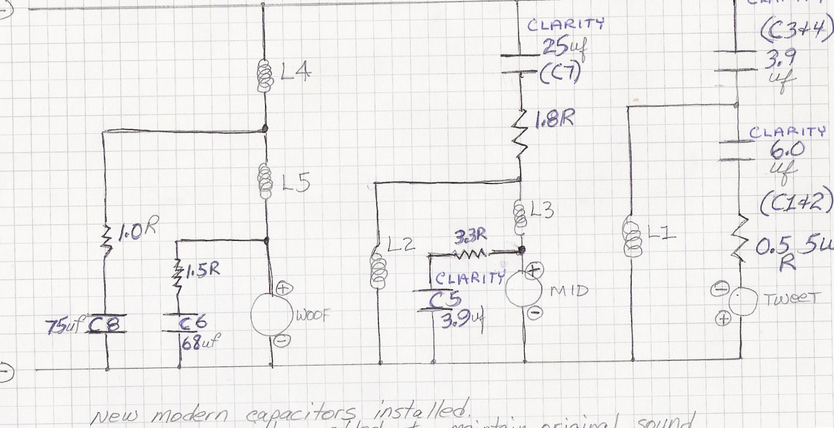

66 xover
Alan: ordered 12 watt Mills 82 & 27 R's . Not sure where you want them to go. Hopefully find a schematic of my xover here and be able to tell me what goes where. thinking no matter what we do here, I will never be able to tell if the SEAS or the HF 2000's are functioning. Am not going to change all the caps to *fit* the SEAS. Will leave as is or put the 2000's back in and just listen to what I can hear. (2nd attempt at this post)!

Alan,
Thanks for the partsconnexion tip!
All the caps in the crossover are Solen polypropylene including the bass. 80uF was probably the closest available at the time to the original 72uF electrolytic. The '80' mark is not all that clear though.
I'll also try the 82ohm across the MD500.
If I eventually replace the caps should I go for 24uF rather than the original 30uF in the mid filter?

moermusic, and others - where to install Impedance modifying Parallel resistors
_______________
Hi Doug,
it is good you included the Schematic drawn in your Post #608.
Where you have drawn the large O and written TWEET, connect the 27 ohm resistor there between the + and - points you marked.
Remove the 0.5R resistor and connect the 6.0uF capacitor directly to the - point marked there.
Where you have drawn the other large O and written MID, connect the 82 ohm there between the + and - points you marked.
NOTE: to other readers, about the 82 ohms:
(1) - this is for the MD500 version only at this stage of this discussion.
(2) - if you cannot obtain 82 ohms in 10 watt minimum in wirewound, then use 75 ohms or whatever value between 75 and 82 that you can find,
or use a Parallel connected pair of 5 watt wirewounds in 150 ohm or 160 ohm.

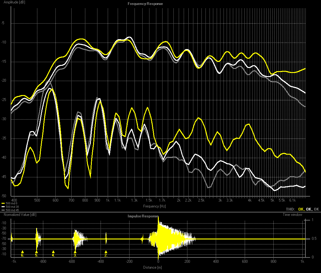

Here is some THD data. The distortion looks bad on the mid dome between 500-600hz
md500 mid dome
Hi sba,
given all the interesting, and some very useful, measurements you have posted during two separate periods to date, and that I have used it to make calculations and estimations to advise some of the others in this Thread how to fine-tune their 66s, it really is past time when I should have posted something useful for you to try ... thus without further ado ...
Regarding the Distortion in that MD500:
(1) - can you identify which sample it is ?
Eg: which Colour Impedance plot and/or Frequency Response plot of those in # on Page * is it ?
(2) - if you measured your other MD500, is it similar/better/worse for Distortion ?
(3) - if you measured any of the MF500s for Distortion, how do they compare to that measured MD ?

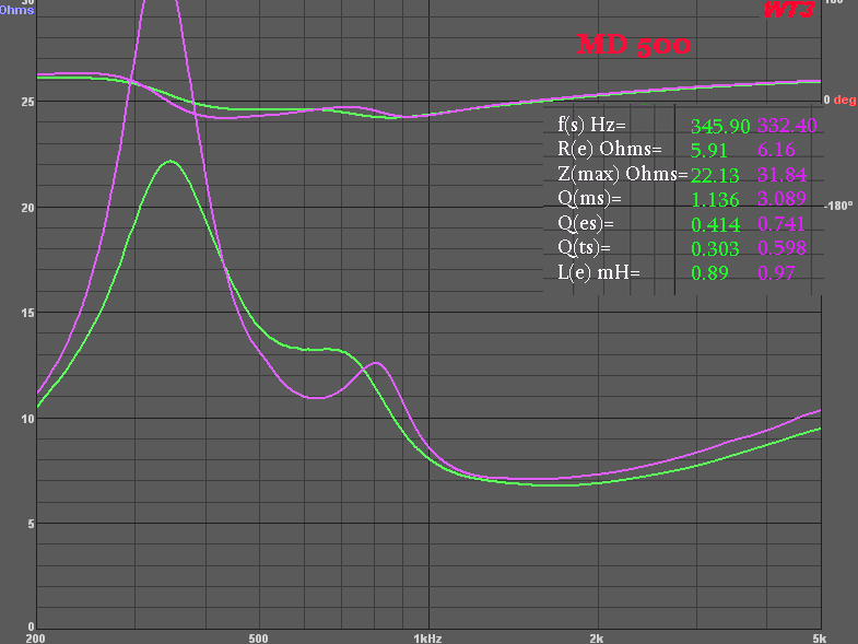

Remember what tonedef2 posted about the internal damping of MD500 early in this Thread, and what he found both physically and audibly for substantially deteriorated samples.
Your deteriorated internally damped MD is the one you posted as the Purple impedance plot in #354 on Page 36 - which I will refer to as "2009 purple" - and that is also the Yellow impedance plot in #490 on Page 49 - which I will refer to as "2010 yellow".
Similarly, the less or little deteriorated MD is "2009 Dark green" = "2010 orange".
Given how the Reactances of the crossover components interact with the Impedance of the driver, and thus how the signal voltage is divided between the crossover and driver, there will be greater voltage across the 2010 yellow MD at its Fs than there is across the 2010 orange MD,
thus the yellow will be driven harder there and will be distorting more ... and especially so as it has less mechanical damping -
- refer to yout 2009 tabulated Q(ms) for both those drivers: 2009 purple versus 2009 Dark green.
This Higher Impedance at Fs of the lesser damped MD can be reduced via a resistor connected in Parallel with the driver.
Such resistance will lower the Impedance there, thus lower Voltage will be present there -{and greater voltage drop there in the crossover,
which is what is needed there}.
That is applying Electrical damping to compensate for the less good Mechanical damping.
Interruption: I am being logged Off here !
I will be back to complete this as soon as I have time available.
I will Proof-Read my Post then.

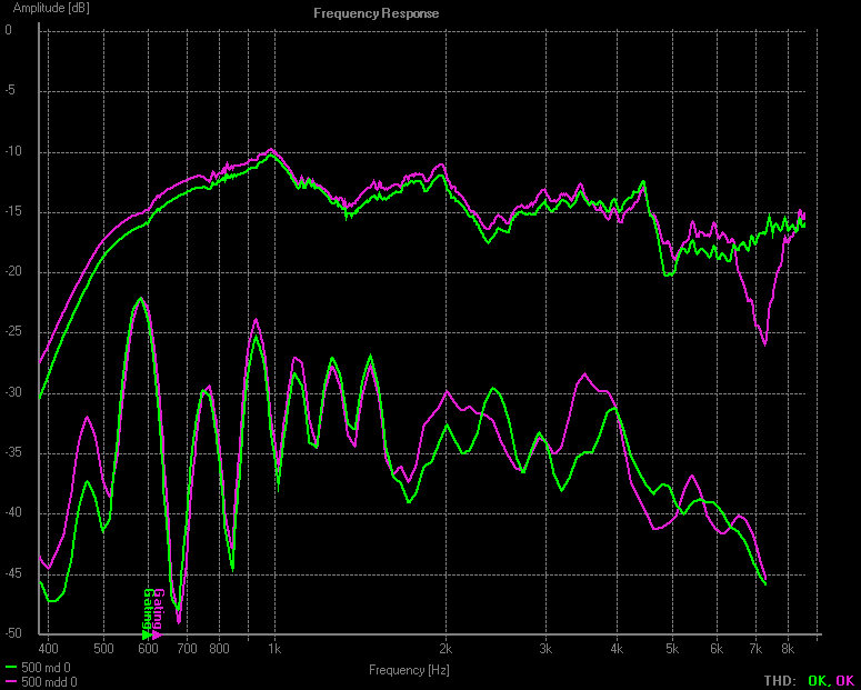

Continuing - to sba - mods for MD500
I'm back, and on a different computer which I hope I can use for sufficient duration to get this finished.
Eg: which Colour Impedance plot and/or Frequency Response plot of those in # 490 on Page 49 is it ?
EDIT: --- it seems to be for the 2009 purple/2010 yellow - that is the greater deteriorated sample.
Questions (2) and (3) still stand - any measurements for those ?
EDIT: - to correct spelling of "yout" to "your" !
{this is not my native pronunciation accent}.
continuing from my above Post:-
Yes, a Parallel connected resistor will cause lower Impedance across the entirety of the driver's bandwidth,
and FORTUNATELY in this case, because, notice that your other MD500 has a lower Impedance trace throughout the portion of its bandwidth that is being used for the wanted signal, thus with careful choice of resistor value you can have a closer impedance matched pair of MDs.
That will cause both to cross over at closer to the same frequencies as each other to the other drivers,
and for the 2010 yellow which has a slightly higher peak in output level at about 4.5kHz than 2010 orange -{ refer to #499 on Page 50}-
a closer match can be achieved there,
because the resistor-lowered Impedance for 2010 yellow will cause the .34mH inductor in the crossover to drop a little more of the signal there.
You will not get closer matching in the higher frequencies -{above 4.5kHz}- but you don't have that now ...
but because of the slightly lower Impedance of both MDs, {after this mod to one of them}, the actual cross-over point will be lower than 5 kHz.
With careful choice from your several samples of JBL tweeters, and some specific resistor treatment of those, you can likely get a fairly close to matched pair of 66s across the full spectrum.
{The bass drivers look less of a problem, and I'll comment further on those in a later post.}
What resistance value for this mod:
- considering the Standard E Series values for resistors, I think 82 ohms is the most likely to work best for a reasonable compromise between the requirements in the low mids versus in the high mids.
There will not be a lot of current passing through 82 ohms, but there will be significant voltage across it, because there is a lot of signal energy in the midrange of Music,
thus use at least a 10 watt wirewound resistor, because for non-interference with the signal it must be kept cool.
It does not need to be non-inductive in this application, but it does need to be of good quality materials and assembly so as to not couple electric results of mechanical faults into the mids' circuit,
thus of quality brands, I recommend you buy a well specified "Ohmite"
{from whichever of their ranges seems the best of those that are for sale from whoever}
or "Dale" -{now Vishay-Dale}- if no Ohmite, or a Mills MRA-12 .
"Well specified":- look for whichever model has the lowest specified Temperature Co-efficient {Temp-Co}, and lowest specified Voltage Co-efficient, and if "Pulse" rated.
If you want to experiment using a resistor you may already have before you buy, and don't have an 82 ohm, then 75 ohm in 10 watt will work as next best compromise.
I would not use lower than 68 ohm, because then the mid-band Impedance will be dropped too low and the crossover points will have shifted too much as result, plus you may have lost too much at 4.5kHz with even 68 ohm there.
With 100 ohm there may not be sufficient effect for audible improvement.
You can use a Parallel connected pair of 150 ohm or 160 ohm in 5 watt resistors there if you have such.
Connect the resistor across the midrange filter's Output on your board.
I think there will be plenty of space there on your own-made large boards !
Select a pair of tweeters that are very similar in measured frequency characteristics in their 5kHz <--> 10kHz region so that you will be hearing the effects the resistor causes on the treated MD, and not masked by differences between the tweeters.
OK, that deals with matching a pair of MDs, but not with over-all distortion if the other MD has significant distortion ...
and if similar occurs in the MF500s.
Yes, Parallel connected resistors can be used with all the mid-domes,
and of lower resistances than 82 ohms to lower distortion even more at the low end, but you will lose more at the high end as result, and will shrink the mid-range bandwidth.
To not reduce bandwidth if you decide to resistor parallel all your mid-domes you will need to make L-pads:
using a suitable value small Series connected resistor between the top of the Parallel resistor and the junction point of the .34mH inductor and 3.9uF cap.
That will raise the Impedance seen by the crossover, though will lower the output of the mids a little, thus if you want to try that, Post and I will advise further,
but I recommend you listen first to the deteriorated MD paralleled by 82 ohms before you decide further.
Note:- if you measure the frequency response of that MD with 82 ohms connected in Parallel with it, there will not likely be any diffence visible on the plot.
To see any difference you will have to measure it when connected to the midrange filter of the crossover -
2 plots, both connected to the crossover filter, one with Parallel resistor and one without Parallel resistor.

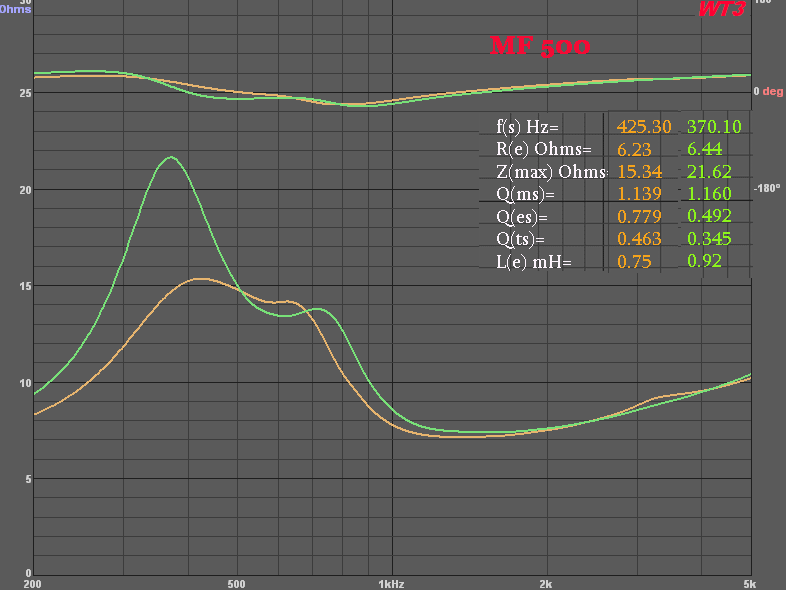

Now, in 2009 you plotted Impedance for 6 samples of mid-domes:
#354 on Page 36.
{I correctly guessed one of the MDs then, but not the other !}
Of those, 2009-Yellow is likely faulty, but 2009-Blue seemed to be OK,
and likely in better condition than 2009-Orange.
Do you still have 2009-Blue ?
It is not amongst the 2010 Impedance plots.
I see in the 2010 plots that 2009-Orange is 2010-Purple, an MF500,
but as the two 2010 MF500 frequency response plots do not match,
perhaps 2009-Blue will be closer to the seeming lesser faulty 2009-Light green/2010-Blue MF, than the seeming faulty 2009-Orange/2010-Purple is.
Do you have any Frequency Response plot for 2009-Blue ? ...
or a reason for not including it ?

Here’s some of the data you were wondering about. The colors here are synced to the original impedance plot, post #394.
I have two remaining md 500s (green & purple), and two mf 500s (green & orange). The other two mf 500s, (yellow & blue) were traded away.
