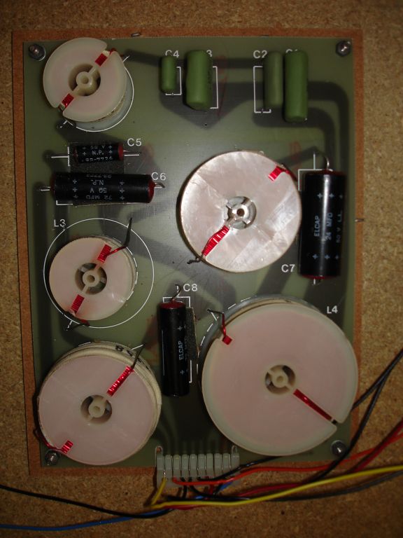

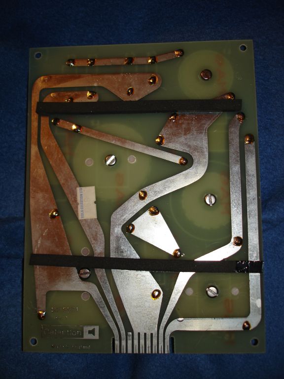

Just a quick update guys,
I had a closer look at the installed crossover, even managed to remove it a get a picture of the traces on the back which I can post when I have time.
I'll also try and make a schematic using EAGLE (light) software, and spend some time working out if the topology is the same as for the point-to-point wired version.
At least I know the build date now. Undid 4 hex nuts at corners of crossover to remove and get view of back of circuit board.
Behind board was stamped "Nov 22 1977" so ~30 Years then.
New text values for the "Green" capacitors (C1, C2, C3, C4) are
C1+2 and C3+4 are in parallel on the traces.

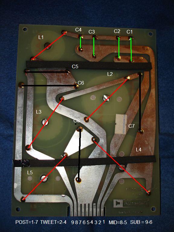

Ok, to recap - here is the PCB Crossover
Mirroring the back of the PCB, comparing it to the front, and some work in MS Paint gives us the following
Green = Green Capacitors C1, C2, C3, C4
Black = Black Capacitors C5, C6, C7, C8
Red = Inductors L1, L2, L3, L4, L5
Post= inputs 1-7
Tweeter = inputs 2-4
Mid = inputs 8-5
Sub = inputs 9-6
Using Alan's units/values we have
C1=4.7uF
C2=1.5uF
C3=3.3uF
C4=0.68uF
C5=4uF
C6=72uF
C7=24uF
C8=72uF
L1=1.163mH
L2=1.358mH
L3=0.547mH
L4=1.359mH
L5=1.358mH
Hopefully we should get the real values for the inductors soon.

I Have Measurements from the point to point crossover.
Thanks to those nice folks at Electronics Plus
and an LRC meter we have the following measurements of the inductors - taken when the inductors where isolated from the rest of the circuit - by means of cutting the wires
The Names are from the PCB layout - The number in brackets is the text on the outside of the inductor - and the measurement is from the LRC meter.
L1=(1163)=0.15mH
L2=(1358)=2.16mH
L3=(547)=0.33mH
L4=(1359=3.68mH
L5=(1358)=2.16mH
Alan - does this look right? - now we have all the values can we determine the crossover points + slope values?
Is there any software where I can plug in the numbers?
I can now add the resistance values form my multi meter -
all values are in ohms
L1=(1163)=0.15mH=0.6R
L2=(1358)=2.16mH=1.3R
L3=(547)=0.33mH=0.6R
L4=(1359=3.68mH=1.3R
L5=(1358)=2.16mH=1.5R

Excellent that you've got the Inductor values Grahame !
Sorry, but I am working in a country area town where I do not have computer access, thus I will not be able to reply to your several posts for at least 6 days, or 7 days from today.
But, don't worry, you have posted plenty for me to think about, thus I will reply !

I'd be particularly interested in recommendations for brands of capacitors and tolerances.
The inductor measurements were what they were - I took several readings just to be sure.
Given we now have
1) The crossover topology
2) The values of the components in the crossover (L + C)
we should be able to stick the values into some software (suggestions please!) and see what the designers were attempting to do.
Also - this should show us the effect of changing the capacitor values
(6.2 -> 6 , 3.98 ->4) and if this is a good or bad thing - or irrelevant as the actual values would have a 20/10/5/1% tolerance anyway .
Pete - I'd be interested in your findings re: the acoustic treatment for the tweeter - then I can just follow your lead.
I'll see if I can get the DC resistance values of the speakers - disconnected - (tweeter, mid and sub) to complete the set of measurements.
I'd also be interested if Alan knows of anybody else whose expertise would benefit this thread.
Pete - does your crossover look like my PCB - its behind the Sub.

tonedef2 said:
L1 look funny to me but im very interested in what Allen thinks,
Pete
0.15mH for an inductor in that position of the 3rd order electrical filter at about 5kHz is a size I would expect.
Grahame and Pete :-
When you have time, measure and post the DC resistances for both your tweeters, and I'll comment some more on that filter.
Similarly for the 4th order electrical filter to the woofer, when you have time measure both woofers' DC resistances and post.
The DC resistances of both L4 and L5 are significant in the behavior of this filter, and now we know those, thus need the value for the woofer itself.

real drivers and cross-over considerations.
Back again !
In regard to matters raised about filter slopes and software for calculating cross-over components values :-
The text book formulae ; on-line calculators ; and various software for cross-over filters all require a constant Impedance across the driver's useable frequency bandwidth and a flat Frequency Response for at least 2 octaves past the cross-over frequency.
Most drivers, including the 3 active drivers in the Ditton 66, do not have constant impedance nor flat frequency response in some otherwise useable areas of their bandwidth.
There seem to be some software types that one can enter variable impedance and non-flat frequency response data into, but I am not familiar with those.
I cannot find frequency response nor impedance plots for any of the 66's drivers, so I will give examples of some similar drivers :-
go to www.celestion.com
click on Guitar Loudspeakers
look down the the left-side column and click on "Ask Dr Decibel"
scroll down the page to "Archive Specifications" and click on "G12M-70"
see the frequency response -{in red}- has a raised plateau in the 850Hz - 1kHz region, then a notch at about 1.3kHz, then a large peak centered on about 2.5kHz.
this is characteristic for 12" paper cones with a slightly ourved profile.
the woofer in the 66 will have similar, though possibly in slightly different areas of its useable bandwidth, and the upper midrange peak may not be as large - all 3 depend on cone mass ; cone stiffness ; voice-coil diameter, {as well as cone diameter}.
see the impedance plot -{in blue}- on the same graph.
see how it changes across the frequency bandwidth of the driver.
its minimum - in the 200Hz - 400Hz area is the Nominal Impedance of the driver, and this is usually about 20% larger than the driver's DC resistance which your multimeter measures.
the impedance is higher than the nominal value in the cross-over region if one was considering a 500Hz crossover freq. and the need for a constant impedance to beyond 1kHz so that the electrical filter will work as designed to.
Print or Store the G12M-70 plots so you can look at them beside the other plots I'll list below:-
go to www.moreleurope.com
click on "Drivers", and then at the bottom of the page click on "Click here for products overview"
click on 'midrange" and open the "product information sheet" for the MDM 55 dome.
see the Impedance Magnitude plot - large changes across the frequency bandwidth.
the hump at about 380Hz is the Fs for this driver.
As it is quite high, it is not highly damped, thus one cannot use this area of the frequency spectrum for any significant output level a it will simply distort, and probably damage the driver as it likely has a limited excursion also.
I do not know the Fs of the Celestion MD500, but it may be as high in frequency as 500Hz, however from tonedef2's description it seems it is very well damped, and it may have sufficient excursion capacity to reproduce significant output at its Fs -{woofers usually do, and some cone midranges do, but rarely do dome midranges and tweeters}.
see the "Sensitivity Magnitude" plot -{this is the frequency response}- and where the response rolls off at a slow rate slope below 1kHz, and where it rolls off at a higher slope rate above 6kHz.
this is typical of mid-domes of that size, and in this one it is very well controlled.
Print or Store those plots for comparison with the next:-
For a less well engineered upper end roll-off, but quite good lower end roll-off, AND, less change of impedance magnitude, go to:-
www.tymphany.com , and under "Products" cllick on "Peerless" in the left-side column, then on "midranges" and open the file for the D75MX-41-08 , and Print or Store to compare the plots for it to those of the Morel MDM 55.
I do not know the rate of roll-off slopes for the Celestion MD500, but as it has 2nd order electrical filters I think it will likely have moderate slope roll-offs at both its low and high ends.
next look at Peerless tweeters:-
look at APL25SC15-04, it has its Fs at about 1.5kHz, which is approximately where I think the Celestion HF2000's Fs will be, or it may be slightly higher in frequency.
see the Fs is not well damped, and this is also indicated by the hump in its frequency response in the region just above its Fs.
look at BC25SC15-04, it has a slightly better damped Fs -{at 1.32kHz}- and a flatter frequency response.
Print or Store the plots for the BC25SC15-04, then place 3 of these plots side-by-side :-
the G12M-70 - one of the mid-domes - the BC25SC1-04 tweeter, and try to imagine how these 3 can be crossed over at useable points in the bandwidth of the mid-dome, and then with the other mid-dome.
In theory, one has to make the impedance constant around the cross-over regions - that is usually done with resistors plus either or both capacitors or inductors - AND make the frequency resp. flat, which is possible only with the woofer in this example, and is done with some or all of resistors; capacitors; inductors.
In practice -{in most cases}- one can combine the functions of the required components for the electrical filters and the required components for the impedance and frequency resp. compensation components, and use less components, BUT these will be different values to what is given for simply the electrical filters' slopes.
This is what Celestion seem to have done.
For electrical filter on the woofer Celestion have used a 4th order slope, AND, this will include a larger than expected value capacitor for the cap. parallel closest to the woofer, to compensate for the rising impedance magnitude in the cross-over region.
That cap. may part compensate for the rising frequency resp. magnitude also, as likely does the slightly larger than expected inductor beside it -{2.16mH}.
The other cap. and induct. seem to be what I would expect for approximtely 500Hz cross-over for a driver impedance plus inductors' DC resistances to total of about 7.5ohm, -{but for some cross-overs the other cap. and/or induct. may be changed also}.
As there are no resistors used, I think the highish E.S.R. - typical of electrolytic caps, especially of that vintage, may be incorporated into the cross-over design.
The MD500 wll have its own roll-off slopes, thus Celestion need use only lower order electrical filters there to achieve total roll-off rates of 4th Order, and the cap. and induct. values seem to have been chosen to compensate for a non-constant impedance.
For the HF2000, at least one of the caps will have to be different than exected to compensate for the impedance hump at the driver's Fs, and to compensate IF a non-flat freq. resp. at least 1 octave both above and below the cross-over frequency.
As the inductor is about the value one would expect for a nominal 7ohm tweeter -{is it ?}- , I think the HF2000 will not have required a lot of compensation cicuitry, but as Celestion have used a Reversed Polarity connection for the tweeter I am wondering whether this is result of using less cross-over components than would be required for a Like Polarity connection for the tweeter.
All this is why it would be useful to have some measurements of at least the HF2000 if one is considering substituting another tweeter.
For the MD500 some measurements would be useful also to assist in integrating it with a different tweeter.
For both these drivers some measurements would be useful if one wants to know which option of the different capacitor values to choose, but it is not absolutely necessary.
I have run out of time and will have to go now as I am very late.
More next week.
Post some comments if this is, or is not, in the direction either of you wish to go !
