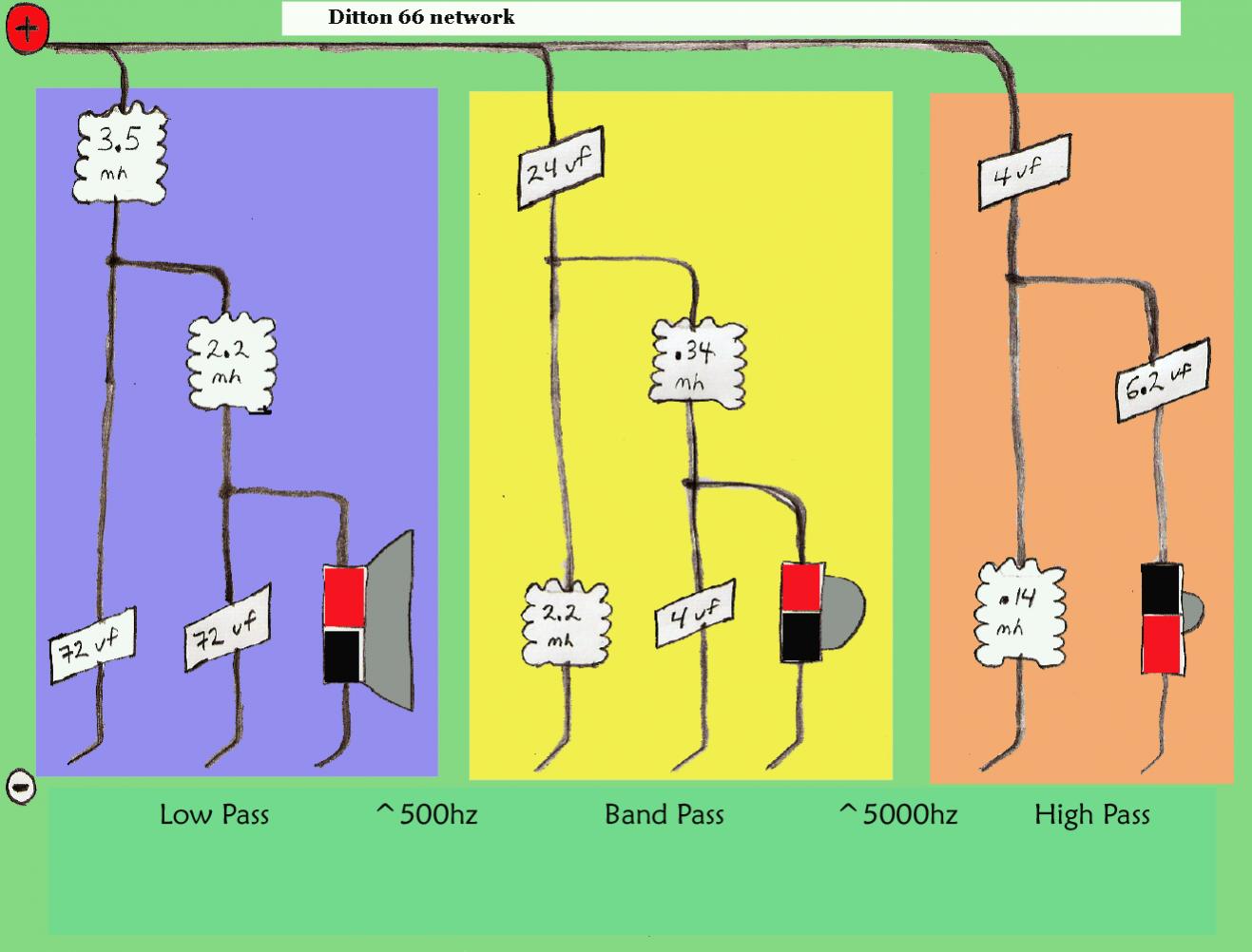

Ditton 44 schematic and inductor measurements posted heref you would like to Post the exact mH measured values of your inductors [...]
and the tweeter circuit ?

I have taken the advice of Wimslow Audio and installed a pair of MOREL CAT 298 (modified with a 94mm face plate) into my Celestion Studio 66 Monitors. At the first low volume testing they sound pretty good. Their existing tweeters installed by their previous owner were a pair of rather cheapo 'Realistc' (Radio Shack) horn super tweeters. I think the problem I have found with the various bits of information placed by other members has somehow become rather obsessed with the fact that the original HF2000's were described as 'Super-tweeters' with a frequency response from 5000Hz up-to 40000Hz. As far as I understand the adult human cannot hear frequencies much above 20kHz. The MOREL's have a range of 1.8 - 20kHz. They certainly sound much better than the previous 'Realistic' tweeters which were extremely tiring to listen to for any length of time due to the edginess at the top end. I think the real star of these speakers are the mid-range drives, which are excellent in my opinion. I'm not convinced that the passive ABR is a complete success. I have also changed the binding posts, upgrading them to a pair of high quality gold plated units. I have changed the internal wiring using 'Chord Rumour Install' wire. These are 14 AWG silver plated copped stranded cables. I understand the original cables were 18 AWG silver plated copper cables. They just seemed very thin and insubstantial. Bearing in mind that when these speakers were produced amplifiers rarely exceeded output of 70 - 80 watts. Like a lot of enthusiasts I have spent a lot of time,effort and money on the speaker wires connecting the speakers to the amplifier and it just seemed sensible to use the equivalent high quality cables inside the speakers? I would now like to upgrade the crossovers. But I must admit the prospect of doing so seems to be rather a daunting task. I have found a schematic within the pages of this extremely valuable tool (DiyAudio). I have asked Wimslow Audion to provide me with the latest equivalent high quality replacement components. I understand it will be the capacitors only which will need to be replaced? I am writing this really to obtain some feedback regarding the assumptions and methodology I am adopting. I know that these questions were first raised back as early as 2004, and have been spread over many Threads. What I would like to do is to manage to amalgamate all of the knowledge regarding the upgrading these beautiful speakers in the best possible way bearing in mind that the original drivers etc are no longer available.

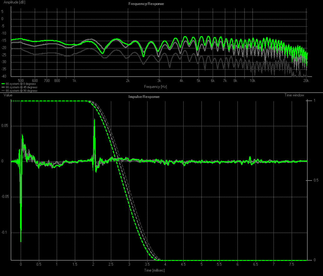

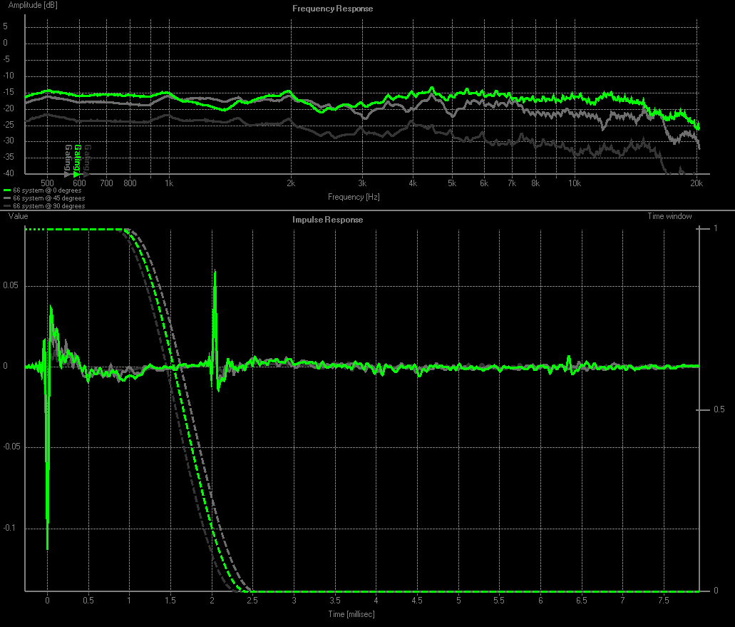

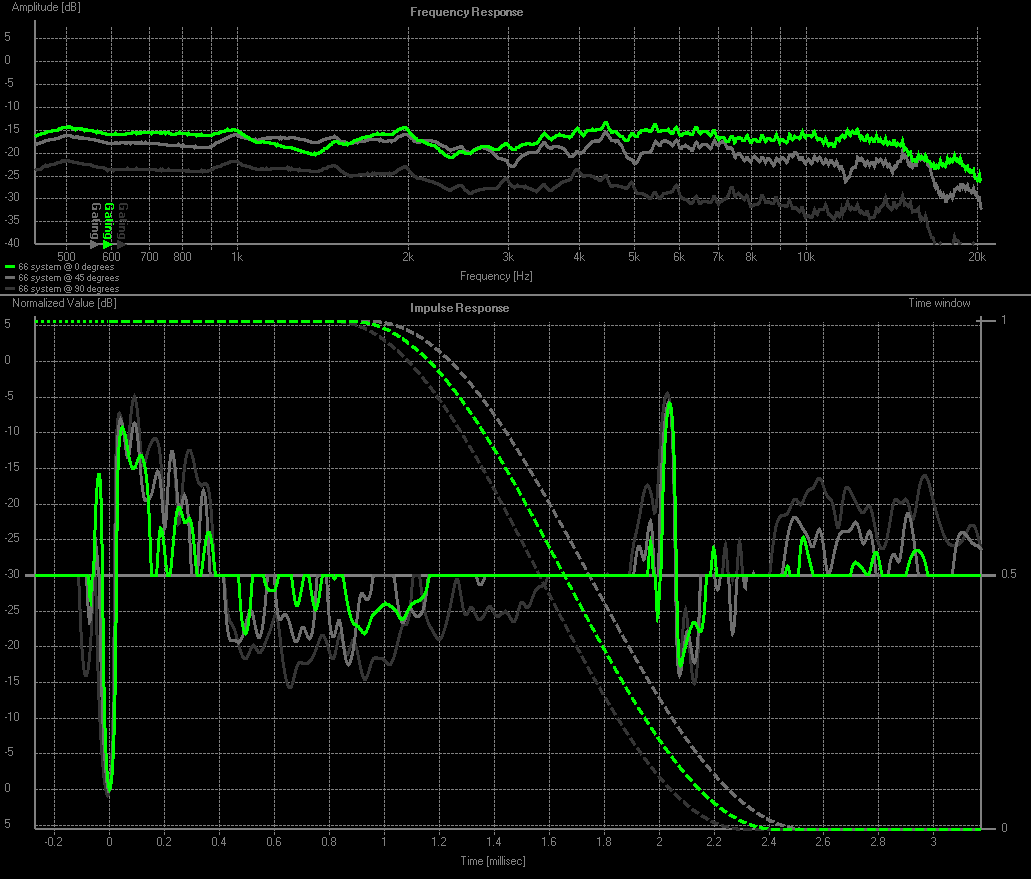

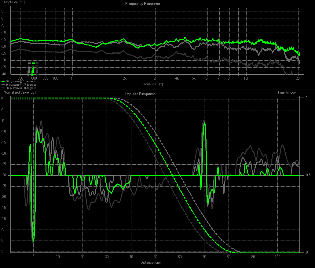

Some IR plots of the Ditton 66 system measured at 0, 45, and 90 degrees--
0-8 millisec overview
the same, normalized
this one shows what happens to the FR when the resonance at 2 millisec is gated in

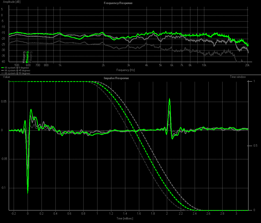

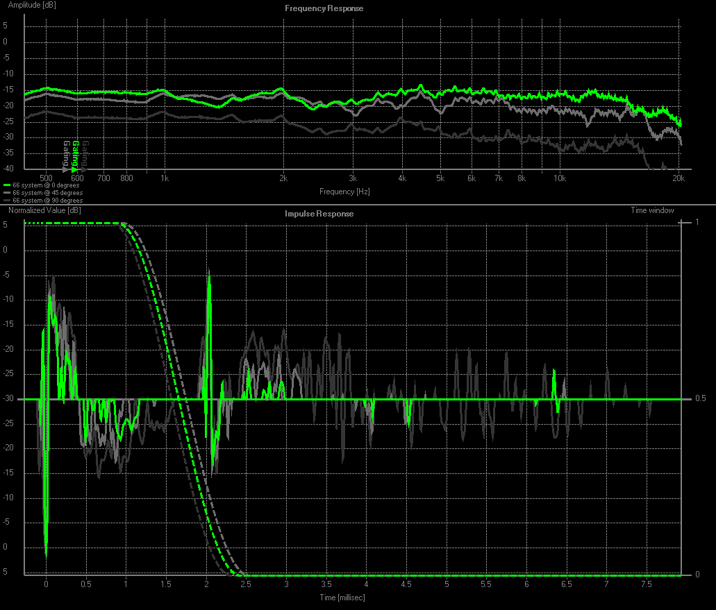

0-3 millisec close-up
the same, shown with distance in cm
Any idea of what’s happening around 2 millisec / 70cm / 28 inches ?

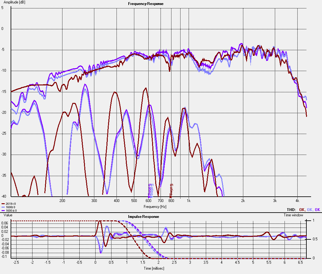

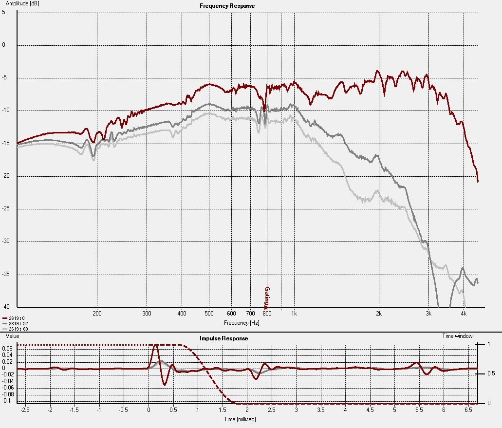

... the thing that confounds me the most are some resonances between 2 and 2.5msec on the IR plots
I narrowed the problem down to an interaction between HOLMimpulse and my sound card, an Echo Indigo I/O. Only when a soundcard calibration file is used does the caca at 2 msec appear on the IR plot. I don’t know why though… there was no problem when I tried REW (room eq wizard) using a soundcard cal.
Originally I was so focused on the FR plots that I neglected IR ones. I really wish I had magnified and examined the IRs much earlier, before making a multitude of measurements. I tried erasing the soundcard calibrations from my data files, as well as un-checking the calibration box in HOLM, but had no luck. Once the soundcard file is enabled, it seems to become an integral part of the measurements.
today--
HOLM, measurement of the 66 -- caca at 2 msec still there.
HOLM, measurement of something different (JBL) -- caca at 2 msec still there.
Abandoned HOLM

REW, measurement of the 66 -- caca at 2msec not there.
http://img185.imageshack.us/img185/5976/rewb.png
HOLM, restarted, cleared everything, & reset default settings
HOLM, measurement of the 66, without soundcard calibration -- caca at 2 msec not there
http://img155.imageshack.us/img155/1361/holmwo.png
HOLM, made soundcard calibration
http://img710.imageshack.us/img710/3449/loop.png
HOLM, re-measurement of the 66, with soundcard file -- caca at 2 msec back again.
http://img294.imageshack.us/img294/1223/holmwith.png
... I have spent quite some time looking at the equations involved in reaching the necessary values for the capacitors and other components within the crossover, but I must admit it leaves me with a degree of self doubt in my ability to come up with the correct values
Wayne,
Replace all of the original caps first. This will get the system closer to original spec… and protect the drivers.
If the new morel seems “bright“, then install L-pads in the tweeter circuit.
Replacement drivers should always be high quality ones that have a smooth response that needs minimal to no correction. There’s too much black magic in the 66 crossover for the home/diy user to be able to successfully alter it using various online calculators. I know this firsthand, LOL ! I put together a 12db/oct crossover for the 66 and fine-tuned it with FR measurements. It measured and sounded ok at first, but, after comparing it with the original, I had to toss it out and have a stiff drink to console me on all the hours put in. In changing the components, it’s just too easy to screw up the phase and the polar response, especially of the esteemed midrange. So if the Morel sounds good, let it ride, and enjoy the music. Moreover….you’d need acoustic measurements to see what's up with a Morel mounted in the 66.
When he returns Alan might also have some ideas on adjusting your Morel.

sba; Any idea of what’s happening around 2 millisec / 70cm / 28 inches ?[/QUOTE said:Hi sba,
I read in your next Post that you seem to have found the cause, or a possible cause,
for the 2 msec problem.
I do not know the idiosyncrasies of the software you are using,
however, given the distance that 2 msec corresponds to my initial suspicion is a reflection of the signal from the protruding lip at the top of the enclosure arriving at the mic.
It would be lower amplitude than the initially arriving primary signal.
If you have not suitably treated that lip with absorbent material - with one of the options I posted much earlier in this thread - then I recommend you do so and then measure again.

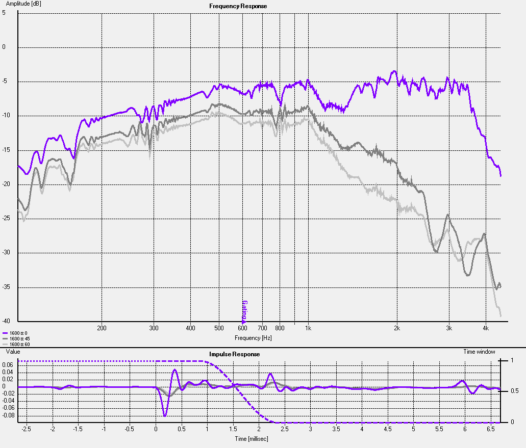

I have some (a lot of) issues to sort out with the software, my soundcard, and its drivers. Afterward, I’ll re-measure one of the speakers and its individual drivers to get some better data.
The previous FR plots were contaminated (at 2 msec) by a very poor soundcard calibration file, which turned out to be not really a calibration at all, but a feedback loop between the “line in” and the “output”.
The problem went unnoticed for a while because I didn’t closely examine the IR plots, and didn’t even know what a proper soundcard calibration plot was supposed to look like.
The HOLM software has no documentation to help with such calibrations… hell, it even told me that I had made “valid” soundcard calibration measurements.
I would consider my earlier FR plots to be rough approximations… I suspect that the overall FR will look a bit better when it’s properly re-measured and doesn't contain the 2 msec caca.
I have all original Ditton 66 and just spent quite a while review this MONSTER thread. My simple take aways are:
1) replacing the original caps on the Ditton 66 is a good idea because they are likely to be leaking beyond spec at this age.
2) Use poly caps
3) Match original cap values to avoid messing with the crossover frequencies
4) The cap values depend on the model and age of the speakers.
5) Lining the overhang with sound absorbing material should help the tweets
6) Putting the speakers on posts or a stand should help the bass
Corrections or Objections?
2) Use poly caps
2) Use poly caps
Good summary less this essential and crucial addendum to points 2) & 3):
Use resistors to compensate for ESR (resistance inherent to the older caps and not present in higher quality polypropylene caps you will replace with.) Alan B can advise as to correct resistors, as he has many times before.
Good reading!

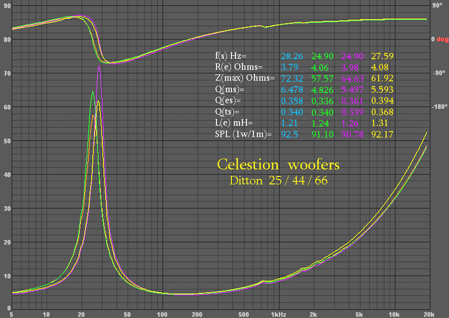

I think that the cap values remained the same throughout the production run, except for a few speakers with early serial numbers that used a 30uf (instead of 24uf cap) in the bandpass. When replacing, use a 24uf cap !
Keeping it simple for Stupid (me)... ALL the caps should be 24uf? If so, I will start shopping...
Also, just to confuse the issue beyond all repair (FUBAR), in all this discussion I have not seen anyone ask about re-fitting the Ditton 66 to allow bi-amping. That seems like a pretty natural thing to look at if you are going to start seriously messing with the crossover... (I am NOT thinking about that myself, but I have seen all the post with replacement tweeters, need to change crossover values, etc. If you are going that far, why not bi-amp like the new speakers?)

Auditioning the Morel CAT 298 Tweerwers n Celestion Studio 66 Mointors
I have given my Celestion Studio 66's with the Morel CAT 298 tweeters installed a longer audition, especially playing CDs from my collection in which I recognise the various nuances of sound that stand out for me and which I know I like to sound in a very precise way. This is obviously years of listening to the same pieces using various combinations of equipment. As I have said the previous tweeters installed in my Studio 66's were a pair of 'Realistic' Super Tweeters purchased at 'Radio Shack'. I have done a little research regarding these Horn Tweeters and found that they were originally sold in the the 70's & 80's as 'Add On' Super Tweeters' Their model number was '40-1310B', and they have previously referred to in diyAudio. Now although their sound made the Studio 66's sound terribly bright and tiring to listen to, there were aspects of their sound I must admit I did like and which made them sound detailed in a way I had not heard before. In particular they really portrayed the sound of the High Hat Symbol in a very crisp and defined way, and dare I say, in a very realistic way. The Realistic Super Tweeters were advertised primarily as an addition to speakers to enhance the frequencies attainable by the tweeters of the day. They would be attached in parallel to the the speaker's tweeters and were placed in their own little enclosure to attain the best sound possible dependent on the room acoustics. They came with their own simple crossover and an attenuator due to the fact that they were very sensitive. They could also be installed inside the speaker enclosure with the accompanying crossovers so as to to not drown the overall sound of the speaker. In my case the tweeters were installed with no independent crossover or attenuator. So I guess that would explain the overall bright and tiring sound I was finding. It makes me wonder if they would have been OK if the required crossover/attenuators were installed? The Morel tweeters give the Studio 66' a more rounded and civilised sound but they do not reproduce the precise sound to the high hat symbol which I liked so much. Alternatively I could build my own little enclosures along with the necessary crossovers and attenuators and use the in conjunction with my Morel's? Of course I do not want to cause any overall damage to my existing crossovers but I have to bear in mind that they have been previously used with no additional crossovers in my Studio 66's for possibly many years!
As with all experimenting with separate audio equipment I also seem to create more questions than answers!. The one thing I have realised is that I do not fully understand the different characteristics of sound produced by the different type of tweeters i.e. dome, horn, ceramic, ribbon etc. If there are any characteristics which are intrinsic? Given that I am not really CAT 298 tweeters because I want them to have some of the characteristics of the sound I heard from the Realistic tweeters as well as retaining their more civilised sound.
I have been looking at the Vifa XT19TD-00-04 19mm Dual Concentric Tweeter as a replacement. The frequency range is 1 - 30kHz and they have a impedance of 4 Ohms, which is the same as the original Celestion HF2000 Super Tweeters. I wonder if anyone else has experimented using these tweeters in any of the Celestion range of speakers which used the HF2000?
As I am new to diyAudio I'm not sure how to insert links etc. into my posts but I will have a search around and and some references to other posts or external web pages.
Regards
Wayne
Regards
Wayne
The HF2000 output is pretty close to the other two 66 drivers.
You might try installing an Lpad, and retesting the Realistics at lower output.
L-Pad 100W Mono 1" Shaft 8 Ohm | Parts-Express.com
This solution works well in one of my 66 systems that has JBL tweeters, which are 5db louder.
You’re focusing on smaller ¾” tweeters. I prefer larger and more efficient ones, and would probably look into these-
https://www.madisound.com/store/product_info.php?products_id=1707
And, if there’s a big budget-
http://www.ciare.com/pdf/catalogo/MT320.pdf
Teleprodotti Store Vendita online altoparlanti componenti dj stage
Also, I wouldn't worry too much about what happens above 15 khz, and especially, anything above 20khz. Most of the treble energy is down below 12 khz.
