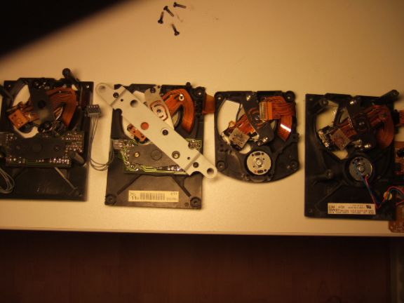

Hall is expensive to make So when it could be done cheaper, they used the toymotor. So up to 4/11 is hall, rest isn't (with exceptions i guess)
cdm2, cdm4/11 are hall, 4/19 and 4/31 aren't.
Left to right: cdm2, 4/11, 4/19 and 4/31. cdm2 and 4/31 come with own pcb.
basically a 4/11 looks like the 2 without the pcb and the 4/31 like the 2, but without the hall.
If your disk is spinning, the motor is fine. But the other components (decoder,filter,radial,laser) are equal.
