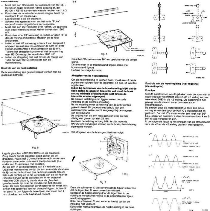

CDM1 MKII Alignment woes
Thanks for reply-I just realized something. When I first got this the rubber ring had completely worn off so I got the ring off a playstation 2. This doesn't go all the way to edge like original but is slightly thicker. I figured it was close but this may be the answer. I might could compensate if it's too far away. Do you know if there are source for these rubber rings or a close sub?
