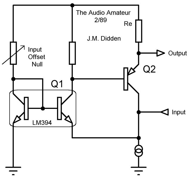

The Audio Amateur 2/89 had an interesting I/V by JM Didden

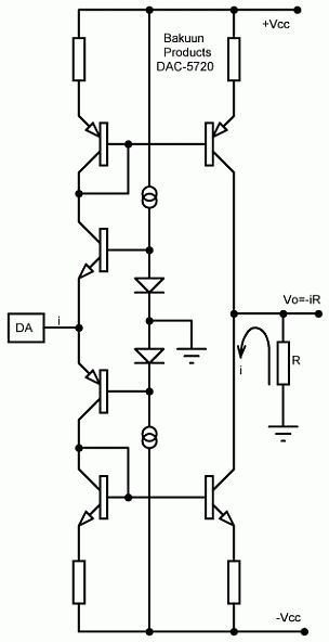

Bakkuan(sp) in Japan uses a similar ides but a bit more complicated.

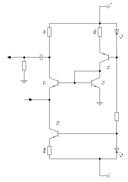

This topology from JD and that one from Nelson Pass (D1) are my own I/V favorites in sounding (tested at the outputs from PCM63K and PCM1702).
Can I assume, that I get the same results by the PCM1704 ??
What are the newest approaches and experiences here?
