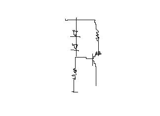

Sorry, see attached pic,sorry about drawing

one can measure the static impedance.
measure the current that passes at operating voltage. Increase voltage slightly and re-measure the passing current.
[V1-V2]/[I1-I2] = impedance at that current and that voltage.
As one changes the current and/or changes the voltage the impedance varies.
Is there a simple way to measure dynamic impedance?
>> In a steady state the impedance will be the voltage across the CCS divided by the constant current.
Some misconception here. Impedance is per definition a complex value in the linearized small signal AC domain. While a shifted operating point may affect the impedance, the large signal values of voltage and current (which *are* just that operation point) are not part of the impedance.

Right Klaus.
Another way to look at it, is that the impedance is the instantaneous rate of change of voltage with current, or the slope of the tangent to the curve of voltage vs current.
Impedance is, of course, complex as it may comprise both resistive and reactive elements.
