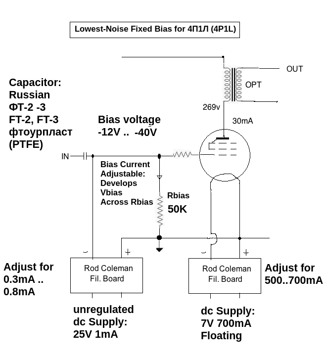

Anyway, I got the idea from here:
The diagram shows the idea. The Filament is heated normally, and a second regulator provides an adjustable current that is fed into the 50K bias resistor.
0.5mA gives 25V at very low noise - probably 100x lower than typical gas tubes. In fact the noise should be lower than with filament bias, since excess-noise in resistors in often proportional to current.
Recent regulators are temperature-compensated, allowing a stable supply to be developed. Why not give it a try!

Rod Coleman (sort of) makes sense, in that excess noise in a resistor will be worse with more current. Hence the excess noise in the grid bias resistor will be smaller than excess noise in a cathode/filament resistor developing the same DC bias. However, noise is rarely an issue in output stages so it appears to be solving a non-problem.
The (minor) problem it does solve is that it avoids wasting power in a cathode/filament resistor, but if efficiency was an issue we would all be using Class D.
I note that Rod, unlike the OP, does not apparently make any comments about the dangers of signal current through bias caps.

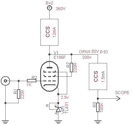

Hello,
I can't figure this one out - what is causing this distortion and ruining a promising bias topology? (note: everything works perfectly with the classic fixed bias. The load is a 68K resistor as shown in the schematic.)
its not distortion. it is signal compression. I make a similar circuit for microphone preamps used in recording. your getting approx 2:1 compression ratio with auto makeup gain due to the css

Hello,
I have measured the dynamic impedance of the constant current sinks that I used, at low currents. The values are not very precise because I used an oscilloscope, but this should give us a general idea. I *did* compensate for the scope's input impedance, measured on spec at 1M.
Code:
[B]10M45S + DN2540 @ 1.5mA, 50v headroom:[/B]
 1KHz  -  300M (!?)
 2KHz  -  175M
 5KHz  -  69M
10KHz  -  36M
20KHz  -  23M
50KHz  -  17M
[B]MPSA42 + BC549 cascode, 2x green LED vref, @1.7mA:[/B]
 1KHz  -  15M
 2KHz  -  2M
 5KHz  -  315K
10KHz  -  100K
20KHz  -  36K
50KHz  -  11K (!??)
I am really surprised by the results: the MOSfet CCS measures way better than expected, the bipolar much worse???
