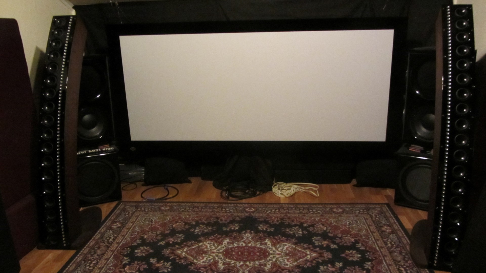

I just completed my pair of CBT36 speakers. I was lucky enough to get a pair of Outlaw 10" subs used for a good price. I can say I've never heard "better bass" from any other speaker.
Some comments:
The speakers took about a week to break in, playing just a couple to a few hours a day.
The speakers have a rating of 50-150 wpc for the tweeters and 50-500 for the midbass drivers, but I found the tweeters need a minimum of equal power given to them in order to have them sound integrated.If you run lower power to the tweeters and don't compensate the db's via the crossover this will not sound amazing.
I purchased my speakers without having heard them before based upon a friends recommendation who had heard them at a show. However, I heard these speakers at burning amp last year (2015) and was very unimpressed with the sound. In fact, I thought their sound lacked any dynamic quality's that make music listening engaging.
Maybe those speakers were just completed the day before Burning amp, as that's the way my speakers sounded when first assembled before being broken in.
t may also be that as a friend suggested, the tweeters be run at lower power than the mids. Doing so in my system produce a very hard to listen to sound with a grey quality to vocals. I was rather amazed when my pair- completed this month- actually sounded great.

Abbey and CBT36 in a small home theater room.
I have measured both speakers in several rooms with several placements. In every case the CBT36 has been extremely flat down to 300-400 Hz and well behaved lower as well. Some times the freq. response has been within +/-3 down between 300 Hz and 20KHz with 1/24 oct. smoothing.
The Abbey is very flat in the range of the waveguide, meaning down till around 1000 Hz. Below that the freq. response becomes uneven and it is nothing like the CBT.
Looking at the reflections (impulse/ETC), the CBT36 has in most cases less early reflections. It completely avoids the floor reflections and ceiling reflections are greatly attenuated. Abbey basically minimizes the reflections from the sidewalls. However, Abbey only does that above 1000 Hz and this can be seen in a bandlimited ETC. The result is, in my opinion, that Abbey is actually more dependent on sidewall treatments than CBT. Why? Because the reflected energy varies, thus coloring the sound.
CBT on the other hand has a wide but uniform response down to 300 Hz. So while you obviously get sidewall reflections, the reflected energy resembles the direct sound much more and it sounds natural and spacious without treatment. Flutter-echo needs to be dealt with for a proper result and perhaps that's what Patrick heard when listening to them. The room shouldn't be too reflective. And if one desires the best imaging, side wall treatment is needed like the Abbey also need. Nothing different there really. Avoiding reflections only above 1000 Hz will yield a great result but actually coloring the sound. So both need broadband sidewall treatment for accuracy and pin pointing.
I have had couple of friends listened to both speakers. They have preferred CBT36 by a large margin. There's isn't much comparison really. It's not only about the frequency response, though that's important. The CBT36 despite it's low sensitivity has way more energy and resembles live sound to a larger degree. The Abbey is lacking in clarity, openness and energy compared to the CBT.
While CBT36 can work decently without a subwoofer both speakers definitely needs subwoofer(s) for the best result. While I like the Abbeys and think it's a well design and above most commercial speakers, the CBT36 is pretty amazing. Especially considering the price, and the low cost tweeter drivers with low sensitivity. Wondering what a CBT with much better drivers will sound like! Thank you Don for an incredible design.

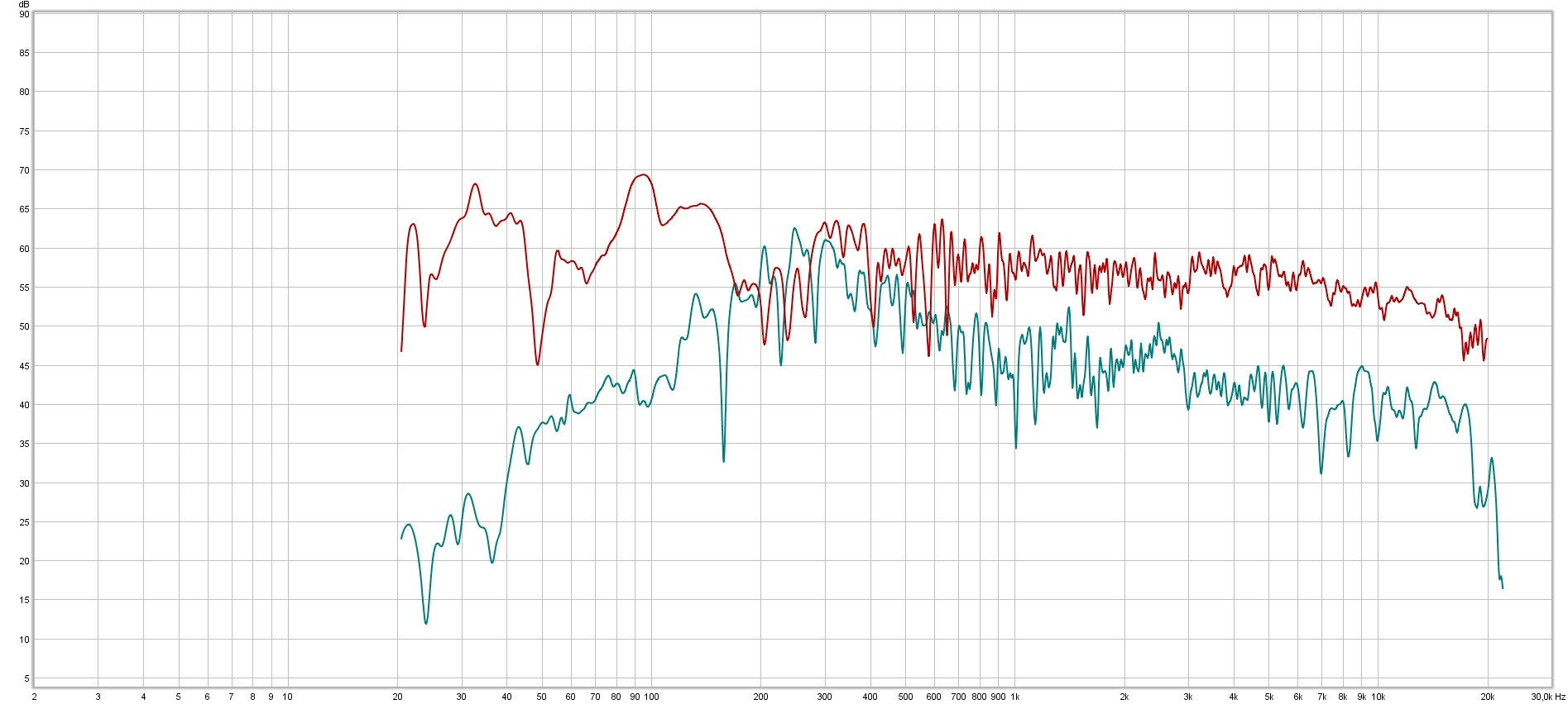

Thanks for your feedback. I think some of the issue is how the Behringer DSP was set up. I also took a different approach with my CBT which I think most listeners would find to be quite a bit better than the CBT36 (though it should be given the much higher cost in drivers). The implementation is also different with what I built and that might factor in to what you noticed lacking in the CBT36.

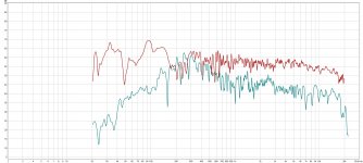

Your measurements shows clearly combing at high frequency. I did a overlay with CBT36 at the approximately same distance and height (12 feet distance and 37" height). Obviously the room acoustics will have an impact, but I still think it shows the problem of using 3,5" drivers in a line array.I made in room measurements to prove the vertical uniformity and also dispel the notion of comb filtering with line arrays. Posts 127-130:
http://www.diyaudio.com/forums/mult...line-array-using-vifa-tc9-13.html#post4584857
Red is CBT36 is orange your line array. Showing it with 1/48 smoothing.
There is no point in looking at the unsmoothed responses for HF. You are admitting all the reflections. FWIW, even the red line looks to have some kind of ripple beginning at 3 kHz.
The point is the farther you sit, the higher in frequency comb filtering begins. From where I'm sitting, it doesn't start until 16 kHz. Of course, a line of 1" tweeters will perform better. But is it audibly better? I doubt it. I am super happy with the HF performance of these arrays. I did consider the Tymphany PMT line. Check it out. But they would probably have trouble reaching 100 Hz, even 75 of them.

The graph I posted wasn't unsmoothed. You should at minimum look at a graph with 1/24 oct. smoothing. Anything less will hide too much and doesn't correlate well with the hearing at higher frequencies.
The ripple at 3-5 KHz is room related by the way, a sloping ceiling behind the mic.
Window for hearing is very short at high frequencies. You can try to gate it to get an idea of what we will hear. But where do you set the gate? 5 ms, 7 ms, 10 ms? In reality, many think that it is a continuously sliding window. REW has introduced this continuous sliding window. It's under the IR windows panel. You can set it to 5 cycles, i.e., admit 5 cycles at 10 kHz and at 100 Hz. I think this is how we hear. I also really like the ERB smoothing in REW because it correlates well with what I hear. I don't hear the large peaks and dips at 10 kHz. I have owned full range drivers with 10 db peaks at 10 kHz before and these arrays sound nothing like that.
If you have an anechoic chamber, please by all means show us the unsmoothed response. Even then, you can ignore what happens after a few ms for the HF. You just don't hear it.
