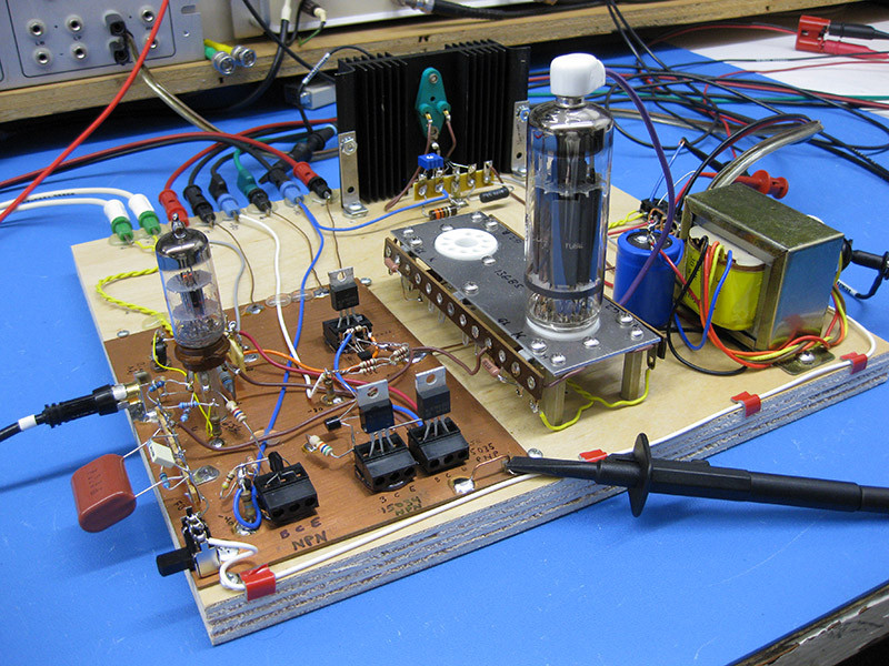

I also wanted to explore the high-frequency performance of low-ratio OPTs, where cheap iron can actually gain the advantage. We know that leakage inductance is proportional to the square of turns ratio, and the $12 MCM transformer does exhibit very low leakage inductance. Its Lpss is only 3.9mH at 1KHz in the configuration used here (11:1). At 2W output, using 12dB feedback, the resulting frequency response is down only -1dB at 26KHz and -3dB at 49KHz. Squarewaves are excellent; see attachments.

The reason I asked why you chose the 6p36s is because I found even less info for that than the xGB5 types, but what I did find about it as triode strapped signal output power was typically in the 1.5W range. How are you getting pentode range signal power out of it as a triode?
Mainly by driving the bejeebers out of it. Most tube datasheets don't show what the tube can do when the grid is driven into positive territory. That's because grid current begins to flow and conventional driver circuits can't cope. The control grid effectively becomes the anode of a vacuum diode. Now that we're able to lean on solid-state devices for help in this area, there's no reason to insist on keeping the grid negative wrt cathode. The CatSkin driver has enough grunt to pull 6P36S anode voltage down to about 40V in triode mode, making anode current peak at nominally 160mA in the 1K OPT primary.
FYI: I swapped out the Sziklai pair driver for an FQPF2N70 MOSFET (with gate stopper and Zener) during circuit development. There was no detectable change in performance, and no change in parts count.
The attachment shows what happens at the onset of clipping. Speaker output is the yellow trace, the control grid is aqua, and purple is THD analyzer residual. The grid is driven about 16V positive including a sharper hump where anode current limits out. That's a result of feedback attempting to make the output signal match the input signal. The correlated dip in the distortion waveform is simply the result of a flattened peak in the output signal. Limiting looks a bit different on the negative output excursion because the tube is approaching cutoff in this case, and cutoff occurs more gradually.

So you're puting 80v p-p in, it looks like on the scope, 10v/div.. That gives 200v p-p out with 200v on the anode?
Grid drive reaches about 80Vpp max, which yields something over 300Vpp at the anode. The 200Vpp (70.7Vrms) figure on the schematic is the nominal value for 5W output, ignoring transformer insertion loss and actual turns ratio.
Speaker line matching transformers are apparently designed to compensate for insertion loss by turns ratio reduction, assuming constant voltage on the transmission line. The 5W tap on a '70V' xfmr should have an impedance of precisely 1K, but the MCM xfmr offers a calculated 968 ohms instead. That means it will actually take 5.165W off the transmission line, or 3.306% over nominal power, if the load is precisely 8.000 ohms. I'm not sure any of us really care much about this, but there it is.
