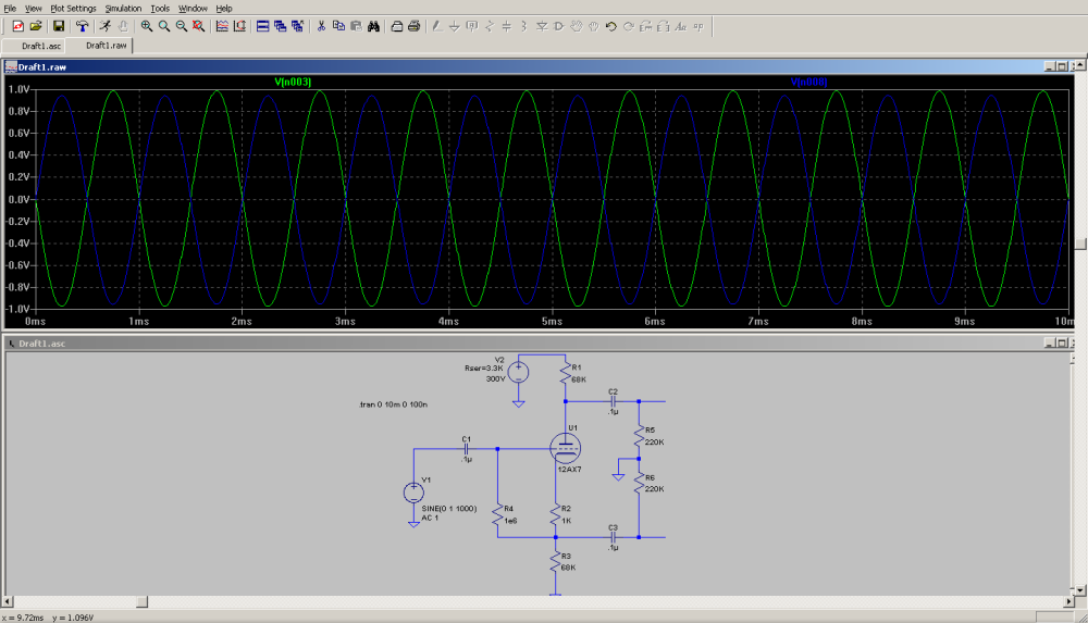

Hi all, I've been trying to simulate a phase splitter in LTSpice, and puts the cathode and anode signals in phase? Ie it's not acting like a phase splitter at all.....:bigeyes:
Voltages are all reasonable and expected.
Has anyone heard of anything like this before?
I was thinking maybe an absolute value taken in the subcircuit or something?
Here's the model I'm using:
.subckt 12ax7 P G K
Bp P K I=((0.001149607902m)+(0.0001063352726m)*V(G,K))*uramp((91.16514401)*V(G,K)+V(P,K)+(52.29904339))**1.5 * V(P,K)/(V(P,K)+(2.177964467))
Cgp G P 1.7pF
Cgk G K 1.6pF
Cpk P K 0.46pF
.ends 12ax7
I thought this was inherently impossible?

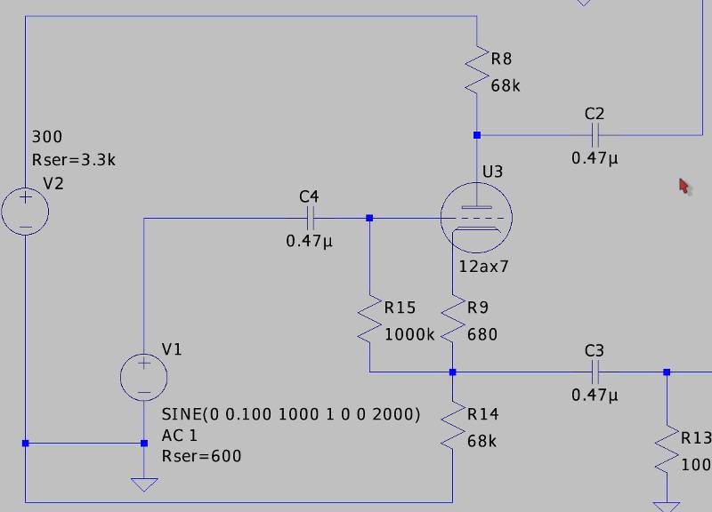

Might be a problem with your triode model... Or something else.
Note I did as you did wrt to the non-inverting output, but normally I would take the signal directly from the cathode as doing it your way results in a significant amplitude error.

I have used that "style" of model in LTSpice many times. I copied the model and used it in a Cathodyne splitter circuit and it works fine.
Where did you take the output voltages from ? If you go from output to ground in each case they will be out of phase as they should be.
But if you got the outputs by for example putting the red probe on the top of plate resistor and the black on the bottom of the plate resistor, and the other output by putting the red probe on the top of the cathode resistor and the black probe on the bottom of the cathode resistor, then those voltages will be in phase.

I am currently using version LTSpice IV, version 4.01g, but have been using it for many years and as far as I can recall there has always been the red and black probes. If you run a simulation, then hover the probe over a point on the schematic the probe is red. If you then left click and hold the mouse button down the probe turns black and you can move to a second point and release the mouse button. You will then measure the differential voltage between the two points. Thus you are not restricted to voltages referenced to ground. Equivalent to adding a trace and putting in for example V(node1,node2) using the Add Trace menu.
I thought perhaps this is what the original poster had done, and had inadvertently mixed up the phases.
