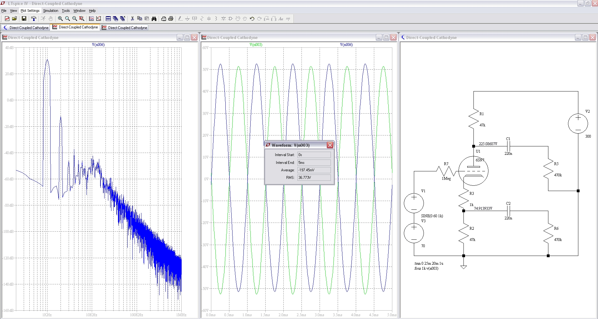

Not sure what all the fuss is about, without any optimization - just throwing some commonly used values together, I seem to get an usable DC cathodye.

I've been doing some further LTspice simulations using cathodynes (concertina, split load phase inverters). If I'm not wrong here, it seems myself and others may have been giving out erroneous info previously. It's a little hard for me to believe that such fundamental info could have been overlooked. I plead guilty also because I believed the conventional wisdom just like most people. This isn't a final verdict though because this just comes from LTspice simulations. It needs to be corroborated by others. I'll try to show what I'm getting at in a series of posts.
I would hesitate to correct conventional wisdom on the basis of mere simulations, especially where the issue is distortion from a valve circuit. It is well known that valve models do not give reliable results for distortion.
That's mostly true due to the poor quality of the tube SPICE models, nonetheless, the simulations are pretty good at showing the trend of distortion even if the absolute amount might be questionable. The takeaway from the above sim showed there is no reason why one can't make a decent direct-coupled cathodyne using the same B+ voltage as an AC-coupled one.
So, the bottom line is it's a colossal waste of time to try to direct couple the concertina to the previous stage. It just is. You can get 105v PP out of a concertina supplied by just 300 volts if you do not direct couple. There is absolutely no need for a separate high voltage supply if you do that. If you are absolutely intent on removing a coupling capacitor then do it where it will do the most good: going into the finals using a power drive scheme, preferably a mosfet. Here's the output using that schemo and driving it with 120v P-P. It has an output of 105 v PP. There are tons of commonly available output tubes that require 300 v power supplies that can easily get by on that drive. And if you need more then at 450volts the concertina drive will scale up for the drive requirement for that.

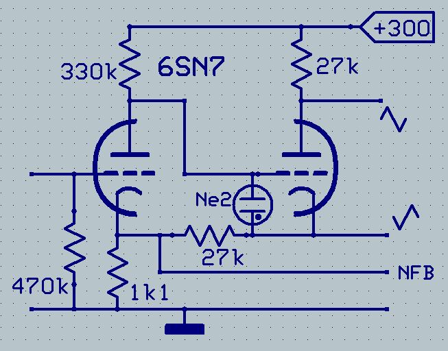

How about traying this one ? Just for the fun of it :)
Neon isn't needed for sim's.Is for preventing exessive Vgk at start-up.

re: Ketje: "How about trying this one ? Just for the fun of it "
Positive Fdbk.
Normally one would be leery of injecting positive Fdbk into the main global N Fdbk node. It does still increase global N Fdbk loop gain, but also "corrupts" the N Fdbk node. Bad place to do that.
However, if the P Fdbk is particularly "clean" (suggest putting a CCS load on the 1st stage, and a very linear 1st tube), then it removes some of the unadulterated pure signal from the N Fdbk, increasing the proportion of actual error fed back. This then starts to look like an "Error Correction" scheme. Where the output error can be fully "nulled" with the appropriate amount of P Fdbk and N Fdbk. (the usual global N Fdbk schemes just get asymptotically closer to removing the error while approaching infinite loop gain)

Hawksford EC does the positive Fdbk loop at the input to the final output stage (usually for SS). That works at larger signal level where linearity for P Fdbk is more difficult, but the SS outputs are typically followers, so little gain variation in the final loop.
This tube front end approach works with small signal level, where linearity is easy for the P Fdbk, but must contend with more gain variation in the global N Fdbk loop. (the P Fdbk must be clean and the global (open) loop gain constant for EC to accurately null the distortion) One could just tune out less than full error, allowing for the worst case tube aging in the global loop. But probably they have another "local" N Fdbk loop downstream to control the global (open) loop gain against aging or power supply variation, and so are able to tune out error to a "full null" with the P Fdbk loop. (well, best null, considering practical component accuracy and non-ideal 1st tube gain)
Will have to look up those amplifier schematics.

On further thought, I don't think the positive feedback loop around the phase splitter (Ketje posted schematic) is actually constituting an EC (error correction) scheme, since the positive feedback signal also contains the N Fdbk signal. (so an ordinary gain boosting inner loop) It would take a separate (2nd) input tube to difference the N and P feedbacks and then sum with the input to do EC.
But the cathode of the input tube presumably has the negative output error term there, which would affect one of the splitter phases, since that is extended from that reference. One would have to simulate this, but it might be turning some residual distortion into even harmonics.
I guess this is getting a bit off topic for phase splitters. But one last observation. Global N fdbk usually goes back to before the phase splitter so the entire amp output is fixed up.
If one were to return the global N Fdbk to just one of the splitter phases, (and assuming class A output), then the remaining error in the amplifier would be all even harmonics. (and not fixable by the P-P OT, ie, signal corrupted) A resulting gain difference between the two phases would have to be dealt with of course.

The EC (or not) from positive Fdbk loop at the splitter scheme:
I'm not sure. Needs some analysis. It looks so close! But I think the P Fdbk is affecting the error component as well as the signal component at the input cathode. Needs to differentially affect the two.
