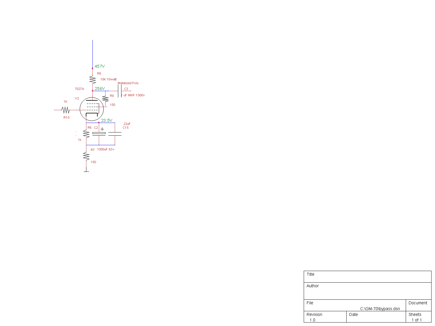

How about if we only bypass part of the cathode resistor like this? Then what? Heads explode?:spin:
Also is it bad to bypass the bypass?

You get a little bit of local NFB which may reduce distortion but this is more than offset in most cases by the increase in ra which leads to an increase in distortion. Perhaps its this extra distortion that some people think sounds better.

Speaking as a musician as well as an engineer, there is alot about sound that is beyond theory and measurement. There are low level effect to the sound other than frequency response, phase, and distorsion. We use simple models of capacitors, resistors, inductors, transformers, etc. to engineer an amplifier, however if we build identical circuits with different components having the same top level (i.e., first order) performance characteristics, we get a different sound quality. Realizing that some may deny there would be a difference, many of us readily perceive a different sound as a result. Components are not ideal, a capacitor has resistive and inductive characteristics. They are also microphonic and non-linear in the micro sense (as distinct from the "macro" non-linearity given by its application in a circuit). Different dielectrics, film thickness, electrode material (foil, metallized), geometry, winding tightness, lead material and attachment, and other such manufacturing and construction methods means that two different capacitors having the same value are not physically identical. Are we to believe that these have no influence on the sound? Now speaking as a musician, you can have two musical instruments that by all appearences, are physically identical, and yet they have a different response and sound quality when played. Is that just the imagination of the player? There are very low level characteristics in musical instruments that are difficult to quantify, and take artistry and not neccessarily engineering to duplicate. Likewise, when you play back a recording made of instruments, can you identify the difference in the sound characteristic between the two instruments? I maintain that these subtle low level effects are real (because I notice them when playing), however are likely immeasurable by conventional methods. A listener should be able to hear these, given an ear that has the sensitivity for such differences. Now back to capacitors or any other circuit component. I maintain that if you have a physical difference between two real-world components that are otherwise identical in their top-level characteristics (i.e value), that the performance of these components at the micro level will be different. They will exhibit subtle differences that may or may not be audible, but they will be there because the are an artifact of how the component is designed and constructed. I cannot just catagorically deny that they are not audible, even if I cannot hear them, who am I to say that someone else who is sensitive to such low level differences is just deluding themselves. I would turn it around and say it is the deniers who are deluding themselves into thinking that just because they cannot hear something, it does not exist.
At the risk of repeating myself, any amplifier that can be made to sound different by changing the make of capacitor is just designed badly. Any designer worth his salt will be able to make a circuit where these subtle effects are inaudible. The only reason there is so much said about the sound of components is because there are so many incredibly bad designs out there. It is no wonder people can hear the differences.
