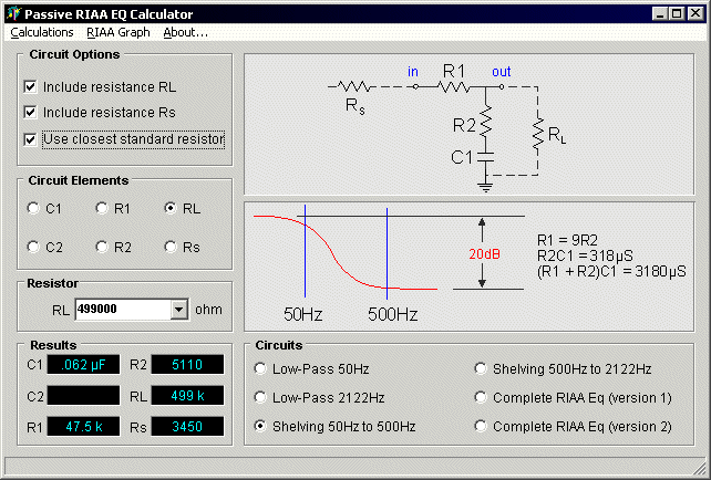

OK, this is what I could come up with quickly, using the GlassWare calc...
rp of 5687 is about 2500 Ohms, but unbypassed with 150R Rk gives about 3450 Ohm rp.
11.1k plate resistor and 499k following grid leak resistor.
C = .062uF
Rseries = 47.5k
Rparallel = 5.1k
How's that look to you?

Looks fine. Yes. The Cmiller is below the error threshold here.

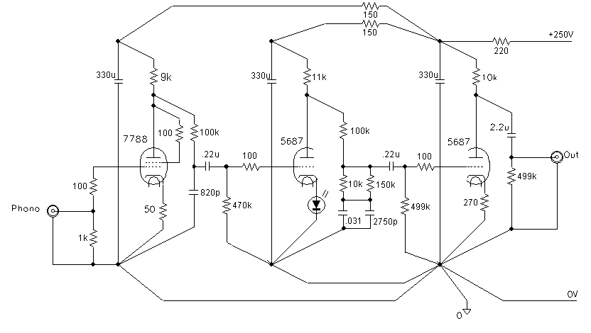

Following Sheldon's lead,
In the meantime, I couldn't resist playing with RC values some more, so here's what I've got today:
The plate resistors for the first and second stages are 15k Mills WW-NI paralleled with 1W metal films to arrive at the desired values. They're working, so I'd like to leave them alone.
I looked at the layout (point-to-point wired) in my phono pre and I don't want to dig in and change those 100k series resistors. My clumsy layout put them soldered in under other parts. As painful as it is, I've got to keep them and find a workaround. I can get to the other RIAA parts quite easily, though.
Fortunately, I have a decent collection of polystyrene C's and metal film R's.
I used Sheldon's calculations as a blueprint and the GlassWare calc to do a double-check.
I decided to look in the parts drawers to see if I could parallel parts to come out with the correct values (or very close). I think I can...
So here's the latest schematic, showing these paralleled Rs and Cs.

Funny, that didn't change much. It brought the total series resistance down by roughly 2k Ohms.
rp = 1k
Rp = 8.9k
u = 40
Rk = 60
Unbypassed Rk * mu
60 * 40 = 2400
Rk*mu + rp
2400 + 1000 = 3400
Now, 3400 Ohms in parallel with 8900 Ohms (Rp)
3400 * 8900 = 30,260,000
3400 + 8900 = 12,300
30,260,000 / 12,300 = 2460
That's the 7788-triode Zout if its internal plate resistance is ~1k.
Now, Zout is added to the Rseries:
2460 + 100,000 = 102,460
Then that in parallel with the 470k grid leak resistor of following stage...
102,460 * 470,000 = 48,156,200,000
102,460 + 470,000 = 572,460
82,142 Ohms is total series resistance
Plugging values into GlassWare RIAA calculator, it gives C1 = 890pF (so 820pF plus following 5687's Cmiller of about 75pF should do it) and R1 should be 100k.
If that and the second stage look OK, then I think I'm close enough for the time being.
How's that look? Did I make any mistakes?
