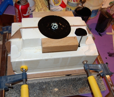

I got the resin and cast the horn:
Unfortunately a couple of problems: first, the mold didn't survive the un-molding, in particular the positive centre part - I had to pretty much chip it out of the horn casting. Second is the finished surface of the casting was not great, not nearly smooth enough (even though the mold looked really smooth).

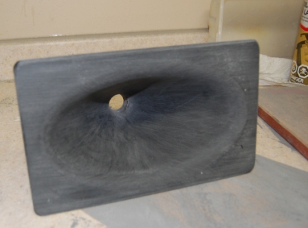

Anyway, here is how it looks. I have been doing some sanding and eventually it will be as smooth as glass:

First, when I say the mold wasn't smooth enough it is not because of air bubbles (just go back a few posts and look at the mold, the pictures show enough detail) or the need to fill voids. It has to do with surface smoothness that is impossible to get unless you spend a lot of time sanding with consecutively finer sandpaper, which I didn't do enough of. The mold should have been perfect - it wasn't.
Second, I don't know what kind of plaster is available to you but the type I had is unmovable in a matter of seconds after it has be mixed. I even used cold water to mix it. Continuously vibrating the form while pouring is the only way to "degas" it - it will be as hard as rock by the time it could be put in a vacuum pot (not that I have one of THOSE).
Third, the mold didn't release because it didn't have the correct release agent on it - in places the urethane that I used to coat the plaster mold was strongly adhered to the urethane of the casting - compressed air is not going to loosen it, it had to be broken out and scraped off the casting.
There is a lesson to be learned and I did learn it: Don't use plaster for a mold, there is a MUCH better substance.

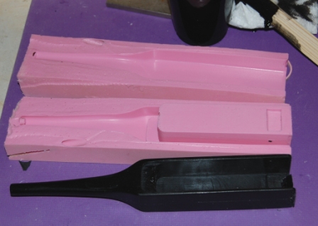

Silicone:
It would be that pink stuff. It forms a mold for the black thing which was actually cast into the silicone mold (to restate the obvious, the black thing is the same casting resin used on the horn flare).
It requires no release agent and is flexible for easy de-molding.
