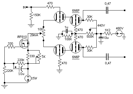

So, finally after I built the whole amp, as in the schematic, I am listening with this for about a week now. The sound is good in general but suffers hugely on the dynamics department.
What I mean is that the sound is in general very flat, sounding like a very bad trasistorized amplifier. No sound stage "depth" no organs pinponting, no nothing. I am really pazzled here, how can an amplifier with such excellent measurements, sounding so bad? I tested this also with my small amp, a SE 2A3 driven direct coupled from a 5842. The differences are huge! The music is there! with excellent staging, excellent instrument pinpointing and focus.
Any ideas why this good measuring amplifier is sounding that "dead" and non involving?
(Scematic attached is the actual one built)(measurements are @10W output -75db 2nd and -70db 3rd, bandwidth -1db @ 7Hz-51Khz.

Just because it measures good, does not necessarily mean that it will sound good. There are lots of SS amps out there with some awesome numbers and indifferent sound.
As for what's wrong here, it could be anything from incompatable speeks (especially in a no feedback amp, some will really "come alive" with the right speeks, and sound poor otherwise) to a slew rate problem due to inadequate drive (especially likely in a triode amp where Cmiller can become a problem) to unbalanced DC causing premature xfmr core saturation, or transients driving the cathode bias up and causing a less linear operation.
I prefer fixed bias, and the inclusion of a decent driver stage, and am generally not adverse to applying a bit of NFB either.

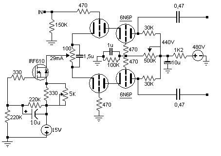

panos29 said:Dear Douglas, forgive my ignorance, can you explain me please why you are saying this will make a change? And if this indeed make a chage is there any chance with this modification the sound to become from nasty to excellent? I am asking as I really got no clue why after so much experimentation and fidling around and also after accomplishing such nice results (on measurements) the sound is so bad. Compared to the very mediocre measuring ZenV4 i got, the sound is even worse! I mean Zen is sounding awesome compared to the pushpull, although Zen measures very mediocre!
There is another amp builder out there who rigs his cascode front ends as you did. The reports I have gotten from friends who have heard them is parallel to your description of the amp you just built.
Either way, it's your amp...it is a simple mod, just re-wire a connection from ground to the wiper of the pot between your cathodes.
I'd hate to see you condemn PP amps based on a partially completed circuit. You can also help deal with the Miller C of your finals. It is just a matter of some small, precision caps...

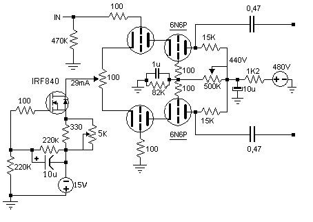

Panos,
You're right in believing that you have encounterec a sonic signature. It is an easy thing to cure.
You also have a single MOSFET CCS. Using a double MOSFET cascode also makes a big difference. Big enough that after comleting the experiments, I will *NEVER* build a single transistor current regulator again.

Funny thing is that when I was experimenting with a similar project using an long tail pair with 6H6Pi with exactly the same costant current source and 6080s as output tubes (same OPTs) the sound was excellent. The sonic signature was very similar to my 2A3 SE amp which I really like.
The power supply was the same, but the driver had the same PS as the output stage 330V (tube rectified CLC, no regulator). The only thing was that the driver could not swing much AC, so the output was only around 5-6 W. This project got me started experimenting with different driver topologies (i tried all differential - LTP topologies, targeting for increased bandwidth, swing and minimal distortion with no feedback), like the current differential cascoded. The only simple stage which accomplished these targets was the cascoded LTP.

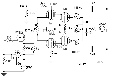

full schematic with measurements
Here is the actual power supply used, including the actual measurements taken on the circuit. I got to note that the transformer providing 2X350V for the output stage, is getting very hot (touchable) after the first hour, as the unit is marginal for the current consumption. Anyway I had an idea, what would happen if I attached another current source at the common point of the output tubes (where the 22ohm resistors join)?
