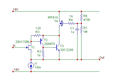

Cascoded jfet buffer
I've been looking into some buffers like Borbely and others and tried to add some ideas together.
Output DC offset will be handled upstream of the fet input
The input fet now operates constant power.
Any pitfalls and hints and suggestions ?

amplifierguru said:
Hi rbroer,
I trust the input FET is going to be gate biassed from somewhere?
Also I think you're biassing T4 from the +18V rail, wouldn't it be a good idea for C1 to bypass to that?
Seems to me unnecessarily convoluted for a simple need. please define your intent.
Greg

In the circuit in post 1:
The input FET should have some resistance to 0V reference or "ground" of the +/-18V supply, 1M to 10M is fine. No "ground" point is shown in the schematic, a glaring omission.
C1 provides low AC impedance from T4 gate to output, for current to drive T4 Cgd, just what you would want for a bootstrap cascode with highish Cgd. With 10mA sink current I would choose a JFET with high Idss and Vp instead of a power MOSFET, something like PN4391, connect R4 to output and dispense with C1,R6,R7. Yes there should be power supply bypass caps but in this schematic there is no 0V to connect to.
I have to wonder how stable the T1/T2/T3 compound feedback triple is. I've had enough trouble with oscillation in CFPs. Has anyone actually built this?
Post 1 is about 31 months old but rbroer has posted recently so a reply may come.
What is the value/purpose of C2? C1 will form a well defined pole with R1, but the C2 seems to form a pole with the rather variable ( part-to-part and temperature dependent ) transconductance of the input JFET.
The link in post 7 doesn't offer any clear explanation. I agree with this, but given 1/gm=33 ohms the -3db of C2 and 33 ohms is about 150kHz, well outside the audio range, so the variability might not matter. I would check for any signs of oscillation on the 2SK170 source.

Hmmm - looks like the BJT emitter voltage depends on the BJT base current, not a good design practice, better to add a resistor in parallel with the bootstrap capacitor. This voltage must be high enough for the plate but not too high so that the BJT saturates on positive peak input.
