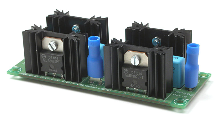

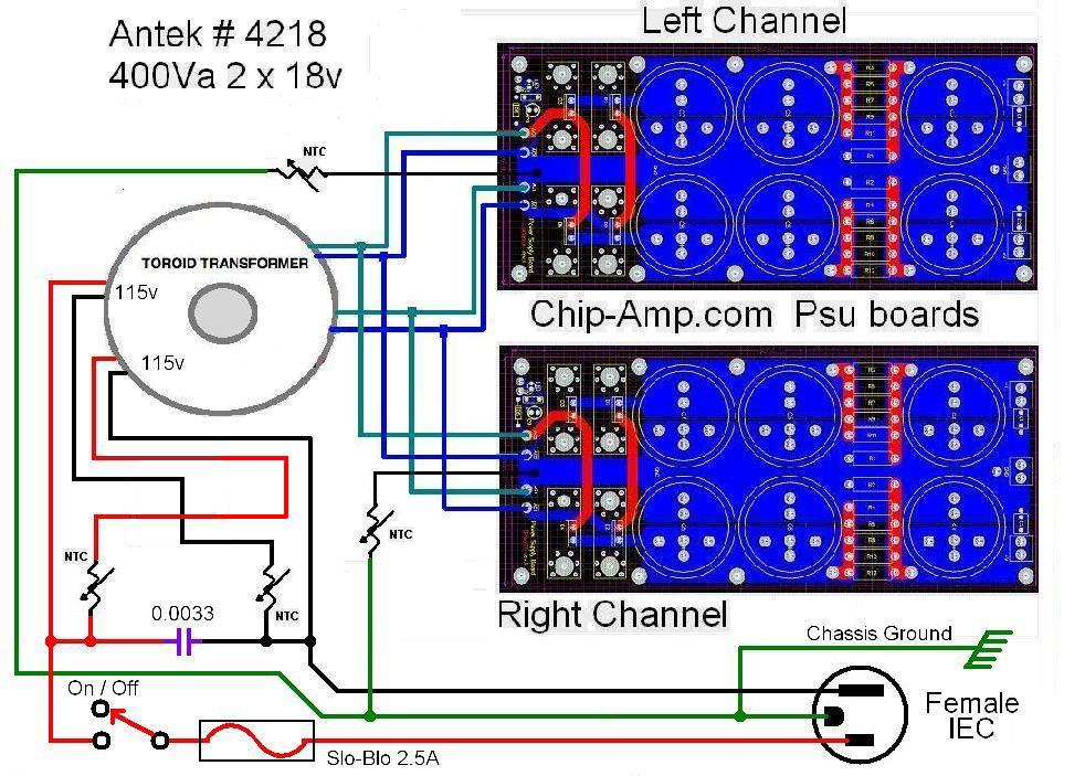

A AudioSan Member Joined 2009 2012-11-16 11:03 am #21 2012-11-16 11:03 am #21 i use the chipamp PSU boards with external bridges. it's easy to jump the rectifier diodes. Attachments DSC00382.JPG 622.4 KB · Views: 135 ••• More options Share
