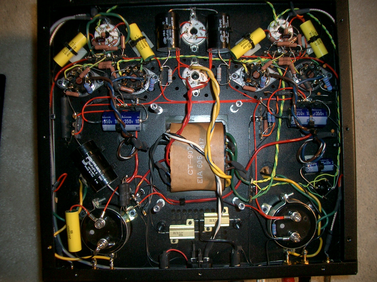

6A3: thank you for your answer. You can find the schematic in another post:
https://www.diyaudio.com/forums/att...ilding-cary_audio_design_sla-70_schematic-pdf
My layout is identical to the one in the pdf.
As for your request, I've verified that the RCAs are isolated from chassis.
Since I don't have an oscilloscope (not yet) I've tried to measure the noise with a pretty good quality USB soundcard, connected to the right channel speaker out.
Here are the results:
The wave has been captured with input RCA short-circuited and an 8 Ohm speaker on output.
It is clear that what I was hearing wasn't actually hum but 100Hz ripple (with a tad of hum). The ripple charge/discharge exponential profile is evident.
I believe that I have to work on the DC filtering. Heaters lines do not seem to be the problem. Those big 1100uF capacitors alone cannot give an acceptable (at least for me) ripple filtering.
Metanastis: I do not suffer from rectifiers flashing. The only time I saw that happening was because of my fault, cycling ON-OFF-ON too fast; the heaters was still hot and the rectifiers in conduction, leading to a fast recharge of filter capacitors. At cold poweron there are no flashes at all.

Try shorting Pins # 5 of both output tubes to ground.
If the hum goes away, then the problem is hum is getting into the 6SL7 stages.
The schematic showed either filament windings with a center tapped to ground, or a pair of resistors to ground (pseudo center tap). Make sure you have one or the other of those.
The schematic did not show the capacitance of the 2nd B+ filter cap. What is that value?
I suspect a pair of ground loops:
1. The B+ secondary center tap to the 1100 uF filter cap
2. The input tube's cathodes circuits, and also the 50k Ohm pot in the splitter gain balance circuit.
It is all about how and where you wire the placement of grounds.
# 1. is coupling into # 2.
Lets talk about the placement of grounds. If you look at the schematic, the B+ center tap and standby switch (when closed) are connected to the cathode circuit of the input tube . . .
Wrong! Do not do it that way.
Instead, the switch is supposed to be directly connected to the negative terminal of the 1000uF cap. Then you connect the negative of the 1100uF cap to the negative of the 2nd cap. After those wires have been properly connected (with the ground currents traveling in that order), then a 3rd wire connection is from the negative of the 2nd capacitor to the bottom of the output tubes cathode circuit (the bottom of the fuse that is in the the bypass cap and bias resistors circuit).

The wave you see in the above post has been taken with the amp alone. RCA inputs shorted. How could I have ground loop in that conditions?
Milanraf,
Check my posts #29 and #30.
You may have been editing your post # 31 at the time.
Another clue: the hum is 100Hz, 2X line frequency.
External ground loops tend to be either 1X line frequency, or very high switcher frequencies.
If the problem is poor filtering of the output tube B+, that would all come out as common mode, and common mode will mostly cancel in the output transformer (but will rob power unnecessarily). The output tap hum from that would be the imperfect balance of the output tubes and imperfect balance of the output transformer.
Let men know what grounding pins 5 and 5 tells us.
