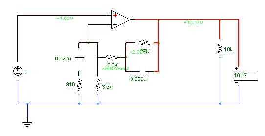

Boy, I don't understand what Carver was doing with his preamps.

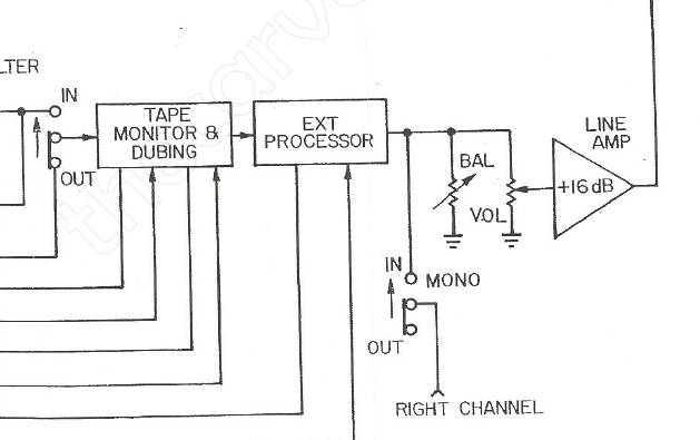

First, the preamp has a +16dB "line amp" gain block, which gives the unit too much gain (see block diagram picture below).

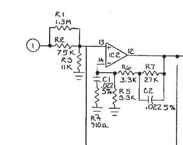

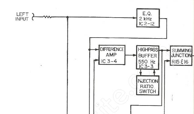

Then the sonic hologram circuit begins with an op-amp 2kHz EQ (block diagram IC2-12 and schematic pictures attached below) that adds another whopping +20dB (of course, this is preceded by a mild voltage divider).
If I'm gong to build a DIY sonic hologram, I don't need the gain. What is it with these consumer electronic guys and their "gain poisoning"?

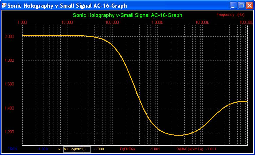

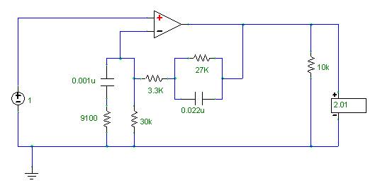

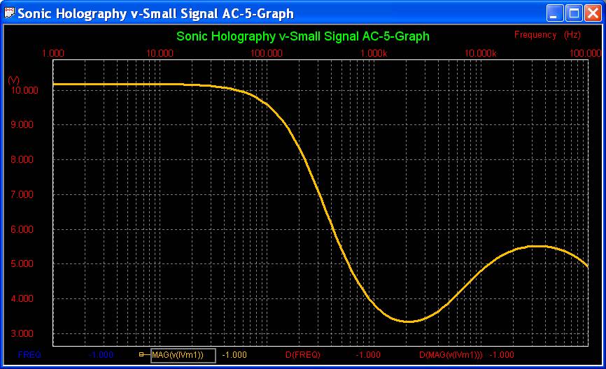

Anyway, I simulated the offending 2kHz EQ. The gain is coming from the 27K resistor in the negative feedback loop. This is an obvious recipe for high gain, when the other resistor is 3.3K. Pictured below is the response characteristics (in units of magnitude, V/V gain).
So I changed the 3.3K grounding resistor to 30K, and also made adjustments to the accompanying RC network (adds a hump at 13kHz). This lowered this block's gain from +20dB to +6dB, while retaining similar response characteristics (not exact, but I did it during lunch).
So here is the question:
If the input to the preamp is 1V peak-to-peak music signal (ordinary for CD players, etc.), the +16dB "line amp" block and the +20dB gain in the sonic hologram quickly amplifies the 1V p-p to over the preamp's power supply rails of +/-13VDC, unless the volume knob is kept at a very low position. Is there a reason why the internal signals need to have such high magnitude? Some of the sonic hologram's internal signals reach over 10V (p-p) with a 1V input, nearly clipping the opamps on the power supply rails.
I learned (by experience) that op-amps are more linear when operating at a fraction of their supply voltages (i.e. +/-5V signals with +/-15V power rails). It seems to me that keeping internal signal voltages to reasonable levels is better than operating the opamps near their rails. (although, I have found that opamps work better with high rails, for example, +/-18V rails seem to work better than +/-12V rails, even with small signals below a few volts.)
