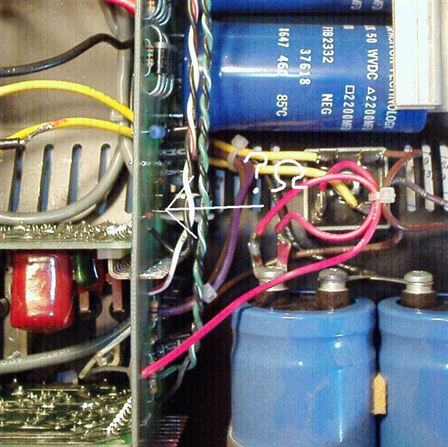

This resistance burned. I do not know it how many ohms. can somebody tell it? email: proksa1@pr.hu
