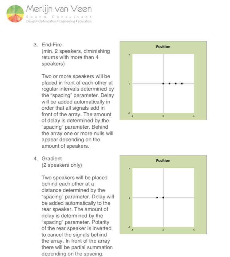

I went with a Gradient cardioid. I need to run the calculator from here: https://www.merlijnvanveen.nl/en/calculators/28-sad-subwoofer-array-designer-en
You'll have to play around with the calculator, but as I understand it:
1) end-fire cardioids have better rejection to the back, but higher efficiency overall
2) gradient cardioids have worse rejection to the back, but higher efficiency overall
This is because the gradient cardioid is in-phase while the end-fire cardioid is out-of-phase.

"For Dummies" note, you have the two mixed up, the gradient reverses the polarity of the rear speaker.

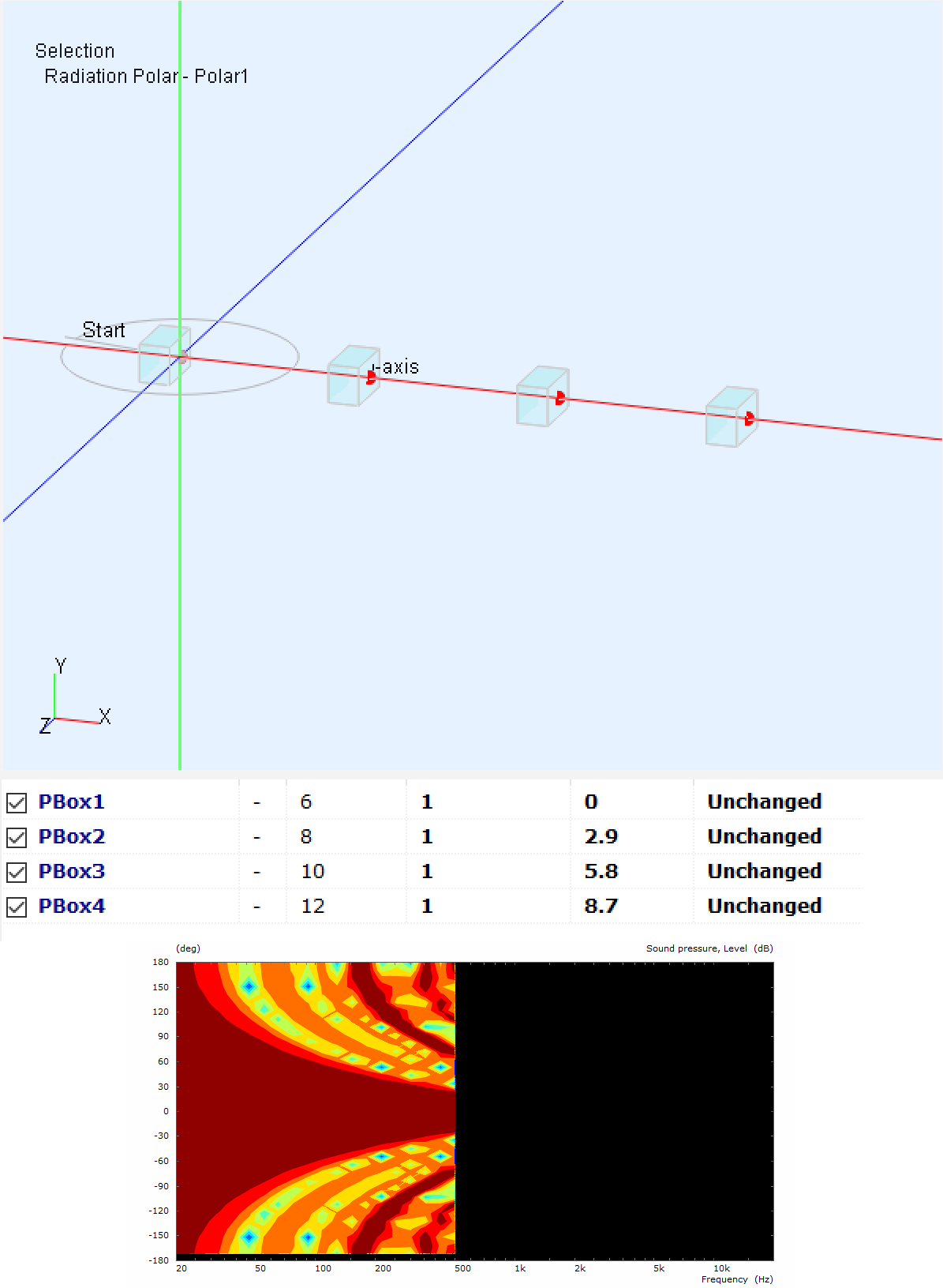

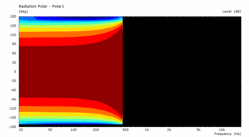

End fire cardioid example (setup described here) 4 subs spaced 1m apart in a line. Each sub delayed by multiples of 2.9ms. No phase inversion or other manipulation. Akabak simulation file in zip.
End fire cardioid setup with only 2 subs (just disabled two in above sim):

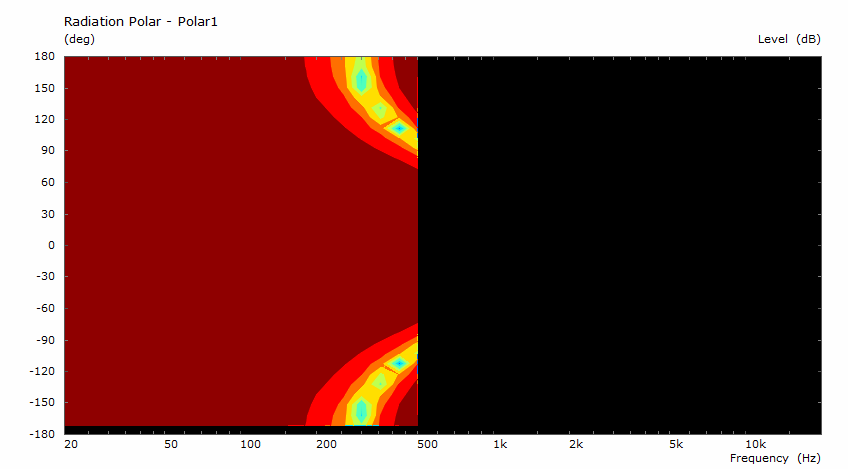

End fire cardioid example with 2 subs as above, but spaced only 300mm apart with 0.87ms delay (we loose low frequency directivity):

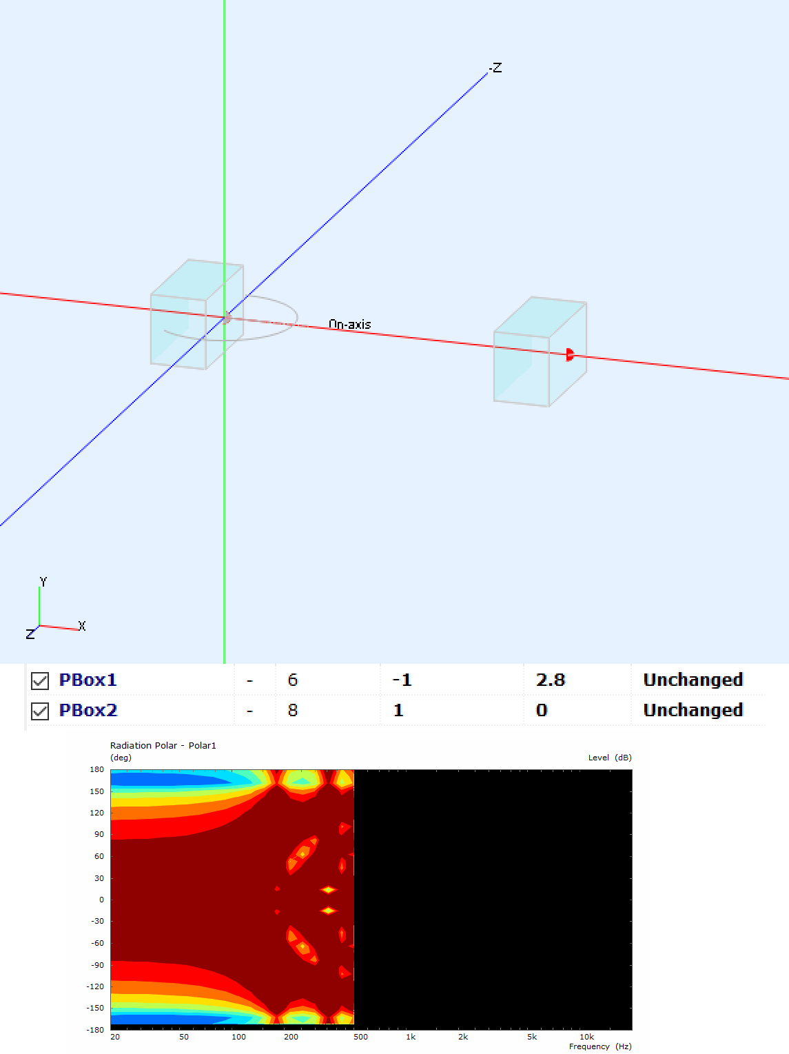

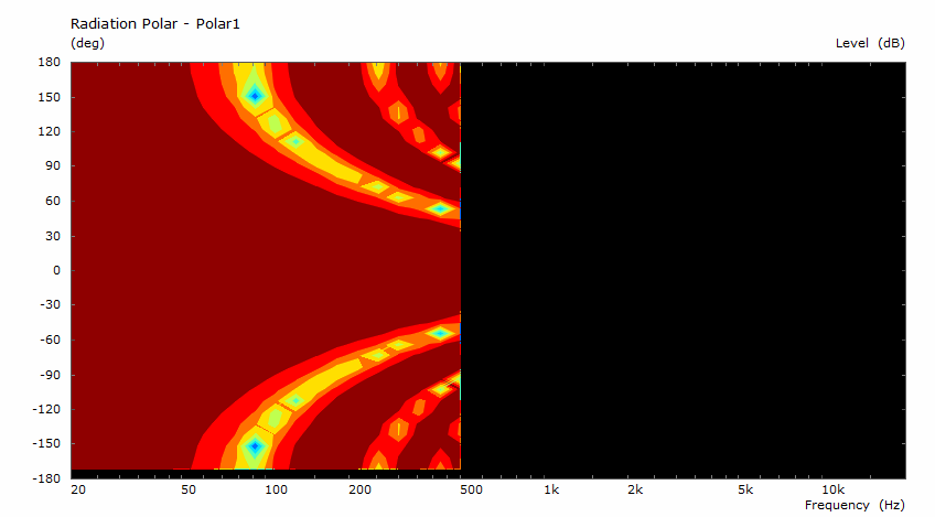

Gradient cardioid example. 2 subs spaced 1m apart. Rear sub has 2.8ms delay and phase inversion. Although we only have 2 subs, the low frequency directivity is maintained but higher frequency control is lost:
Gradient cardioid example same as above but only 300mm spacing and 0.87ms delay. High frequency directivity is maintained as well as low frequency. What we do not see here is that efficiency is lost in the low frequency because cancellation from the out of phase sub is more 'complete'. There is always a trade-off!
