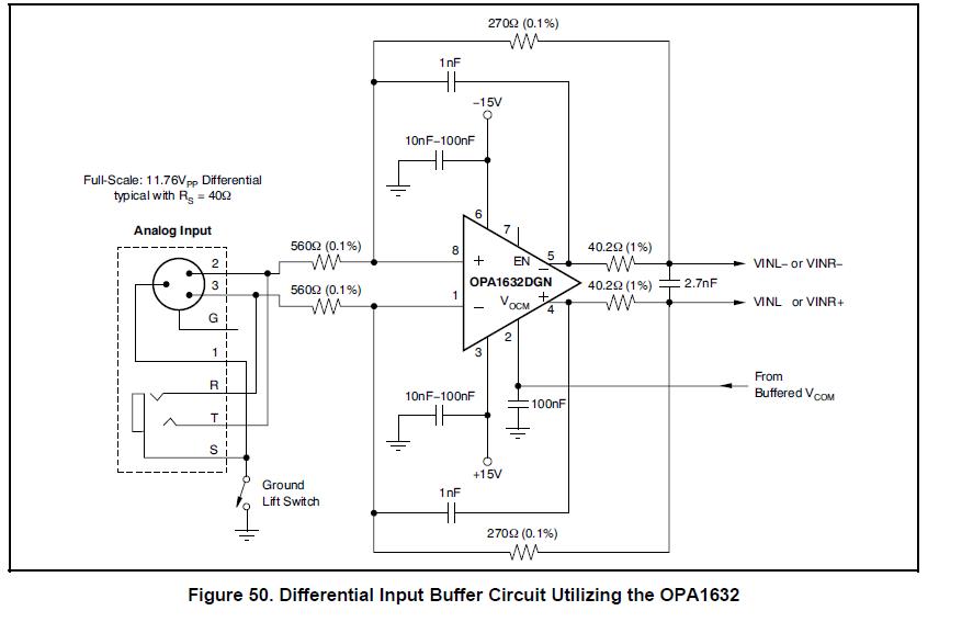

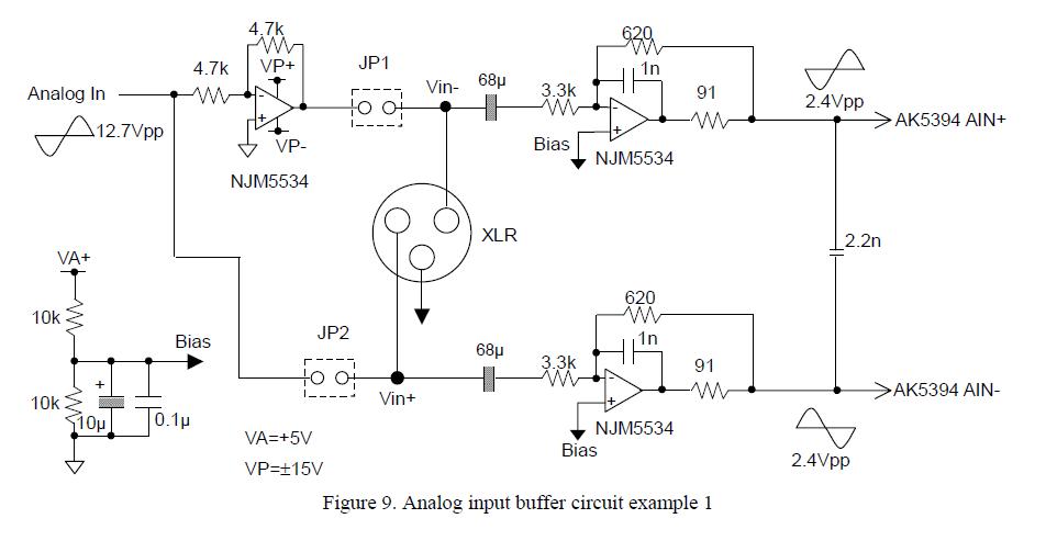

Page 19 of the AK5394A datasheet has an input circuit shown and described. S/N+D is 105dB, gain -14.5dB, fc=320kHz for the LPF, and fc=0.7Hz for the HPF. I guess the bias is to center the analog signal between ground and VA+ (5V).
I'm sure some of the analog mavens here can do better than a S/N+D of better than 105dB, but maybe not... I don't know what the THD would be for this circuit.
Anyway, I'm sure everyone has already read the data sheet...
I've also attached the input circuit TI recommends for the PCM4222, using the OPA1632. Maybe there's even better performing differential opamps out there, I don't know.

I suggest the first kick at the can would be to build the simpler, single AK5388 mono-design shown in Fig.1 of the app note. It has a simple mux for the output and puts off the fussy FGPA work until later.
It would allow the creation/testing of the analog input stages , clocks and power supplies. The output of the card would be plain vanillia I2S. Theoretically the card should be able to mate with any I2S engine, commercial or open-source.
George
