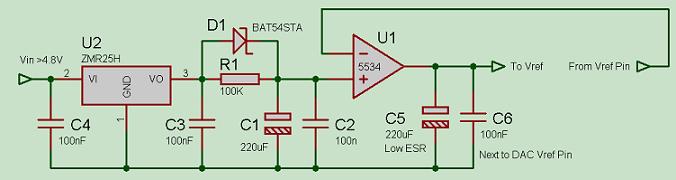

The Vref pin on an ADC/DAC is one of the most critical nodes in a circuit, and is often over looked. Internally, this pin is normally used to supply charge to a Switch capacitor network (in a 1 Bit or Low Bit DAC). The charge is drawn at the internal switching rate – but with an Audio modulation component. Therefore, this Node needs to be well de-coupled at both the Audio Band and “RF” frequencies.
If you where to perform an Impendence plot of any capacitor, you will see a wildly varying curve, with the De-Coupling properties of the capacitor rapidly reducing at LF. This increasing impendence at LF has a large impact on Bass quality – resulting in “1 Bit or Low Bit” DAC’s sounding “light” in the Bass.
Most Vref pins are at half VCC typically 2.5V. The internal Bias generator can only supply a limited current, so there’s no point in hanging large De-coupling caps on them – it will take forever to charge these up – and you will still be left with the Caps varying impendence which will impact its “foot print” on the sound.
The best approach is to add external Very Low Noise and ultra low impedance Vref Generator. Below is a circuit I often use. Pls. note, it’s for designs where Vref is 2.5V. Due to the “High” impedance of the internal Vref (VBias) Gen, they don’t normally mind the addition of the external Gen. Nevertheless; it’s prudent to match the output voltage of the External Generator, as close to the output voltage of the internal Gen as possible.
Due to the Feedback of the OP-AMP, the impedance of the Generator appears almost “flat” within the Audio band (in fact, the output impedance is much LOWER at LF) – thereby limiting the sonic “footprint” of the VRef Capacitor used. Its important to realise that RF decoupling is still required, and the OP-Amp will offer very little correction - due to its limited gain Bandwidth at RF. The RF quality of the 100nF ceramic is critical, try placing it directly across the DAC Vref Pin and Ground – and the electrolytic C5 should be a Low ESR such as an OS-Con or Tant. The quality will now be less critical, due the active correction of the OP-AMP.
Note, the feedback is taken FROM the DAC Vref pin; this removes the effect of PCB wiring and any noise. The limitation at LF is now due to the DAC’s package bonding impendence.
The FB connection should be as short as possible back to the Op-Amp.

Hi Fred,
Thanks for your comments. I don't spec a Low ESR cap for C1 as it would be a waste of money in this postion. Dispite D1's fast "pull-up" action, its almost certain that the external Vref circuit will be slower to reach the correct voltage, then the internal bias Gen - thereby preventing any latch-up conditions - but a good point to be aware of.
I also checked the noise performance on an FFT, and any noise above 100Hz is below the Zoom FFT noise floor of -170dB ref 2.5V. A good result for such a cheap and simple circuit.:)

As has been stated, you always hear the sound of a Capacitor, without the external Gen Circuit – they all had their sonic “foot-print”, good in some areas – poor in others.
At the end of the day, I could never find a Cap that “sounded” neutral. With the external VGen circuit, Bass becomes very tight – controlled with no “Bloom” and the sound stage opens up! – best of all cap choice is not such a “No Win” situation.

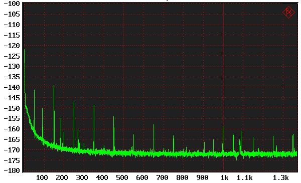

Below is a Zoom FFT of the output of the circuit 0dB @ 2.5V, note that the Mains harmonics (50Hz / 100Hz etc) are mostly from the R&S UPD05 analyser – its worst in this respect then the AP.
Adding a lower noise Vref is not going to help. The ZMR25H is a noisy 2.5 volt regulator – but its noise is completely filtered by the circuit. The noise towards DC is again due to the UPD05. I don’t believe much could be done to improve the circuits noise performance.
Changing the 5534 to the AD797 might help, but I’ve always had problems getting the 797 stable in unity-gain situations – with mV RF oscillation at about 500MHz (very hard to see on a ordinary Scope). Adding the small value resistor in series with the FB loop didn’t help much - and worsen the noise floor. Add before anybody asks – Yes, the 797 was well de-coupled with ceramic SMD caps across its PSU pins and to ground.

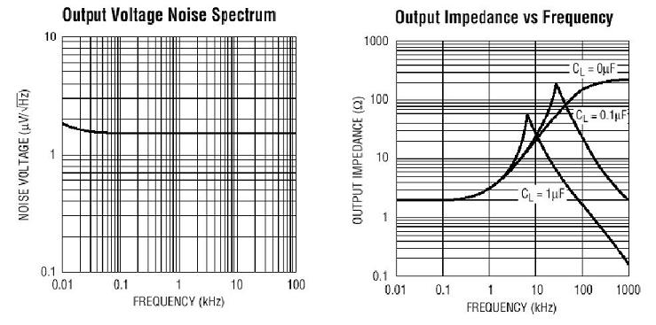

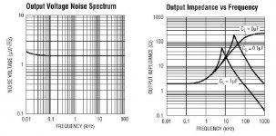

With the Vref pin - noise is not the only important issue – the foremost reason for using the external VGen circuit is to reduce the VREF impedance across the entire audio band including LF. I’m not aware of any VRef IC that can equal the simple circuit for noise, output impedance – or price.
I had a quick look at the LT Voltage reference, and it just goes to supports my earlier Post. The noise is about 1.6uV and output impedance is 2 Ohms @ 100Hz and rises sharply – where its peaks at about 50 Ohms (or worse) @ 10KHz – never a good thing. See the LT Graphs below: -
The output impedance of the Op-Amp VGen circuit will be sub mOhms and have a noise voltage in the nV across the entire audio band – making it hundreds of times better then LT’s integrated voltage reference.
This is not to say that LT’s Voltage reference is bad device – it like most - if not all other Voltage references cannot compete in terms of noise and impedance with the simple Op-Amp VGen. It however will have a very stable output voltage – this is its main function.
In much the same light, the AD780 has a Pk Pk noise of about 20uV 20Hz to 20KHz - and it requires an external Op-Amp buffer to provided low output impendence.
With the Op-amp VGen, you can take the FB from the DAC’S Vref pin as a “Kelvin Sense Node”, thereby guaranteeing the lowest output impedance and noise where its needed.
