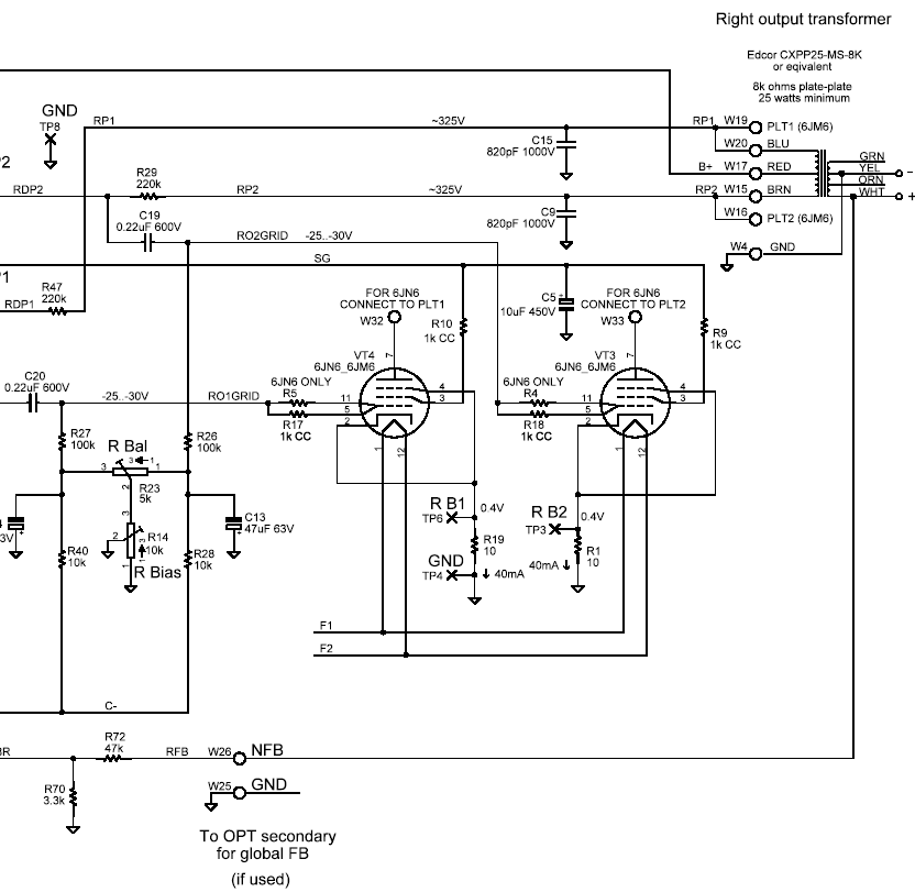

I have yet another newcomer's question about construction practices. I'm in the process of assembling a Pete Millett "Engineer's Amp", and wonder if I can successfully stack coupling caps in series to raise the total voltage rating.
I discovered a local surplus store which sells military and industrial metallized film caps for pennies on the dollar. I've been squirreling away bags of Wima and Epcos MKP10s and MKTs, as well as Cornell-Dublier metallized polycarbonate caps. I've found that these all work very well as signal caps. However, most are rated for 400VDC, and now I need some with 600 volt (or higher) ratings.
I'd like to use two .47uF, 400v caps in series to make a .235uF, 800v assembly. If I put these together with some 250K equalizing resistors, will they work properly as interstage coupling caps? Or will the multiple-component assembly degrade the signal, and introduce unwanted distortions?

Gimp, thanks for your insight. Here's a link to Pete's web page -
DCPP Amp
and the components in question, C19 and C20 -
OK, Pete has a 100K to the -25 to -30V grid bias supply. If you use 10M resistors in series you have ~130V to 20M to the grid, and 100K to -25V.
This gives you an offset of (.1/(20+.1))*(130 - (-30)) = 0.79V
There is a good chance the bias adjustment will be able to take care of this offset. If it does not and you can't get to -25V at the grids, change R28 and R40 to 9K1 ohms and it should.
You need the 10M resistors with at least a 200V working voltage ratings (I'd go higher) as at power up you will have 340V+60V (B+ plus Bias) available to them. Since they are in series they will share this voltage.

Seems messy to me, and those 10M resistors add a degree of inelegance and compromise that I would find unacceptable as well as making the bias voltage a function of both the bias supply and variations in the plate voltage of the preceding stage. You've made the very definition of the leaky coupling cap on the verge of needing to be replaced - and deliberately! :D Generic 600V coupling caps aren't that expensive - I'd go looking for some.

Actually they are in series with the grid resistor and in parallel with the coupling cap XC, the whole combination including the miller capacitance of the driven stage then is in parallel with the plate load resistor of the driver stage - normally they would be inconsequential except at very low frequencies where they might introduce a step in the frequency response of the network.
IMHO still not a good idea unless gain to DC is required.
Kevin, I think I'll go with your "simple-and-straightforward-is-better" approach.
It was tempting to pair up some 15-cent metallized polycarbonate caps, but there are too many variables to make it worth the time expended.
Instead, I'll be using some Tobe-Deutschmann film-in-oil caps rated at .1uf/1000v. These are easily-overlooked military surplus metal cans which have amazingly low ESR and parasitic inductance (<.1nH). They look like miniature motor run caps, and were originally used for filtering on mobile generator trucks.
If you can find some at a surplus vendor, they can usually be had for about a buck apiece, and sound better than almost anything I've heard at 30 times the price.
