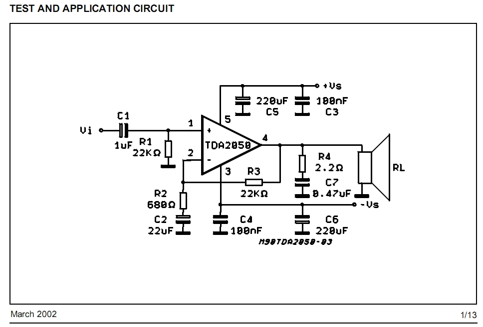

Hello all,
I was wondering if you can help me go over what the types the capacitors should or could be in a standard TDA2050 amp. I am not looking for any expensive audiophile type of caps, but more of a cost/value type of cap. This is what I understand so far.
C1 electrolytic acceptable, polypropylene better
C2 electrolytic
C3,C4 ceramic
C5,C6 electrolytic
C7 polypropylene (is something else acceptable here?)
Is there a big difference between polypropylene and metallized polypropylene?

C1 better not be electrolytic. Polyprop is prefered though some polyesters are quite decent. One can't generalise but if you have an option pick polypropylene.
C2 electrolytic is what is used most often and some put a small value polyprop or polyester in parallel say 0.1uF.
C3,C4 are available as small yellow box ( 63V ) type polyester caps. These are good and inexpensive.
C5 , C6 are elco's.
C7 can also be polyester and I'm not quite sure if it's type is audible unlike what you use at C1!
In my opinion C1 is the most critical cap in this circuit. C2 comes after that but it is also equally important to use a good one. Try shorting it out with a link and see how much dc offset you get. If it's less than about 0.2V at the speaker leads, you can safely listen to your system with or without C2 and determine how much it degrades the sound . You could also try different brands of elco's. Panasonic's are generally good but even cheaper types often can sound quite good. If your offset is less than 50mV ( with C2 removed) then you can remove C2 completely ! The offset will drift with temperature so you can run a test with the amp cold and when it's very hot. If the offset is less than 50mV then chuck C2 out !
All polypropylene caps have a metal layer. This is either a sputtered layer or a metal film. Metal film types cost more . Do they sound different? I think you should pick by the sound ,which you can only do by running the test in the location where you want to use it. The bias for 'possible ' better sound is towards metal film types. But I think one cannot generalise again.

My concerns lay mostly with the C1,C2 caps. To me they seem to be the ones that would affect the sound the most because they are directly in the signal path.
This is what I extracted from what you were saying:
C1 polypropylene
C2 electrolytic (possibly polypropylene or polyester in parallel)
C3,C4 polyester
C5,C6 electrolytic
C7 polyester

Input filter caps (C1):
Nichicon ES 1uF is a solid performer, bipolar, so its "reversible" for more or less brightness.
The Elna Cerafine 4.7uF is also a solid performer (stripe towards source, normally).
*The larger figure, 4.7uF will operate the amplifier full bandwidth; however, you'd also need to increase the size of the NFB cap (C2) by the same proportion--If C1 is 4.7uF then C2 is 100uF.
*The smaller, 1uF (with 22uF at the NFB) can run full bandwidth if you multiply the values of R1, R2, and R3 by 4.55 times (22k * 4.55 = 100k).
Speaker output zobel:
For your C7, it specs only for polyester (because of the typically high ESR).
*otherwise the 2.2R load of R4 could be increased to 5R or higher figure to use ceramic or polypropylene caps at the zobel.

C1 has the biggest influence. C2 is the second most influential. The choice of a bipolar capacitor for C2 is necessary, because the feedback filter's high pass frequency is higher than the input filter's. A 22 µF film capacitor in that place would be inadequately expensive and big, but you can achieve a sonic improvement in that place, by putting a small film capacitor in parallel to C2.
I found my LM1875 board and tested it again. DC offset is less than 1mV on my DMM. If you short the capacitor C2 the offset goes up to 49mV ( L ch) and 52 mV ( R ch ). This is still OK. After the amp warmed up ( about 30 mins ) the off set was 51 and 54mV respectively.
After playing music very loud for 30 minutes and the heat sink was too hot to touch continuously ( around 55 deg C ) the offset was 57mV and 62 mV respectively. Still OK though not a great figure. But if your C2 is not a 'great' cap then it might be better to run it dc connected and find the sound improving considerably.
However I'm not sure what your input and feedback resistors are.If they are low values then the offset will also be low. If you remove C2 ensure that C1 is present.Make sure you start off with C2 present and when you decide to short it out , take offset measurements with the speakers disconnected. You could also use a 1.5 amp fuse in series with the speakers while testing. Might save your speakers if you do something silly initially.

C2 and R3 form a high-pass filter. The bigger C2, the lower is the roll-off frequency. It does not actually increase the bass, but determines how low it goes, just like R2 and C1. A side effect is that the lower the filter frequency, the less phase turn you get in the audio band. Phase turn is usually considered to worsen the sonic performance.
C1: Definitely polypropylene
C2: I would prefer polypropylene, but a quality electrolytic such as Nichicon KZ with a 100 nF polypropylene in parallel would work too.
C3, C4, C7: Polypropylene or MKT would be my choice.
C5, C6: Low-ESR electrolytic.
Actually, I would redesign the circuit to use a DC servo. That would get rid of C1, C2 so you don't have caps in the signal path. And with a DC servo, I would limit the caps to 1 uF, thus, making it possible to use quality ceramic caps or PP if I wanted to get fancy. LF411 or LMV841 look like good candidates for a DC servo circuit.
As others have said already: C1 is where you want to spend your money. Then C2. The rest are secondary.

Guitar amp application ? Then why all this fuss about 'best' caps ?
In that case I think you will probably never find any significant difference in following all the recommendations that have been given on this thread.
In your application you BETTER use an input cap and the feedback cap ( C1 and C2 ).
IMHO you can get away very well with a low cost polyester cap at the input and any electrolytic cap at the C2 position. Others can be low cost polyester and electrolytics.
Parallel polyester/polyprop on C2 will not improve the sound of your guitar. I doubt you will hear any difference between polyprop or polyester at C1 if the signal source is a guitar. Don't get carried away and get expensive caps in this application.
