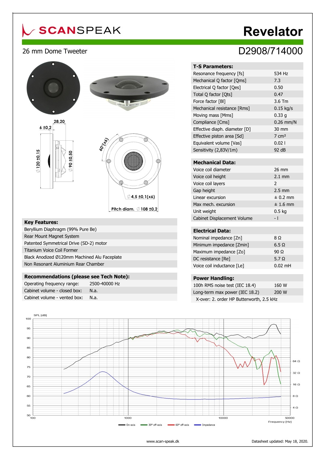

Almost every tweeter beams. Even those expensive scanspeak be domes. Seems like more expensive, more it beams.
Big change in directivity between mid and tweeter is no good.
Supertweeter most of the time just spreds highs wider.
I preffer $14 foster supertweeter which does not beam up to 40kHz.
