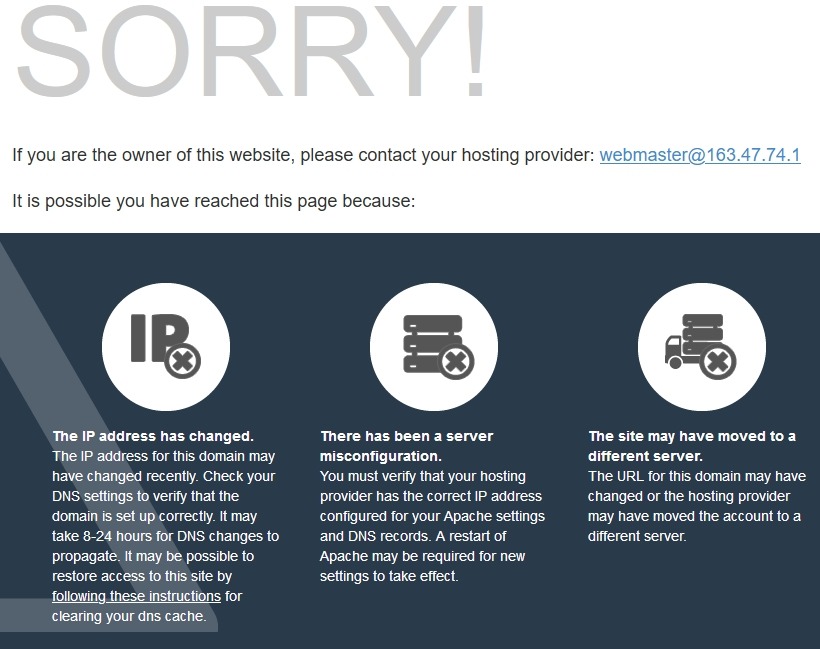

I can ping 163.47.74.1 but when typed in the browser I get this error page:

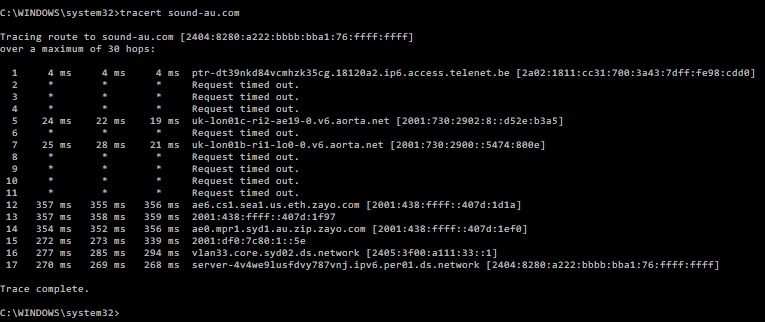

On a windows machine open up a command prompt and type -
tracert sound-au.com
This will hopefully give an indication on where in the routing chain from your pc to the sound-au website fails, be mindful some internet routers may not respond to ping or tracert.
The first hop will be your router at home, the next couple of hops or so will be your ISP internal network
The end destination site should be - ipa32f4a01.ipv4.syd02.ds.network [163.47.74.1]

Works here (can't direct access ipv4 # though, get the same error page), and ok according to the following 3 is-it-down sites below.

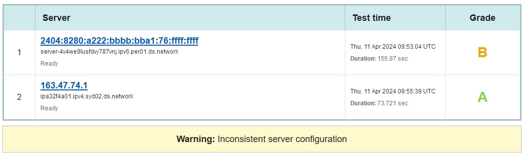

Server test seems ok too.
https://www.ssllabs.com/ssltest/analyze.html?d=sound-au.com
https://issitedownrightnow.com/status/sound-au.com
https://www.isitdownrightnow.com/sound-au.com.html
https://www.freshworks.com/website-monitoring/is-it-down/sound-au.com/
Clicking on the ipv6 # takes to a detailed page, it only complains because they use outdated TLS 1.1 and therefore receives Grade B.
https://blog.qualys.com/product-tech/2018/11/19/grade-change-for-tls-1-0-and-tls-1-1-protocols
ipv4 on the other hand doesn't support anything less than TLS 1.2.

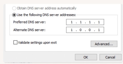

I cured it with Google's DNS servers.
https://www.diyaudio.com/community/threads/cant-connect-to-rod-elliotts-site.411460/post-7654525
I have experienced accessing the site difficult since Rod's March Index page update. For a week or so few links from index worked so a DNS only issue is doubtful as mobile phone browser access and and FireFox on a PC s mostly impossible. I can access only using Edge. I'll give Rod a heads-up by email. Sometimes the server's admin posting panel can break things!
For people who don't know how to change the DNS settings (that cured my problem, others seem to exist):
Control panel-> Network-> Change Adapter Settings-> Select Properties on your currently connected adapter-> Select Internet Protocol Version 4 -> Properties-> Fill the boxes with 8.8.8.8 and 8.8.4.4 and check 'Validate settings upon exit'-> OK
