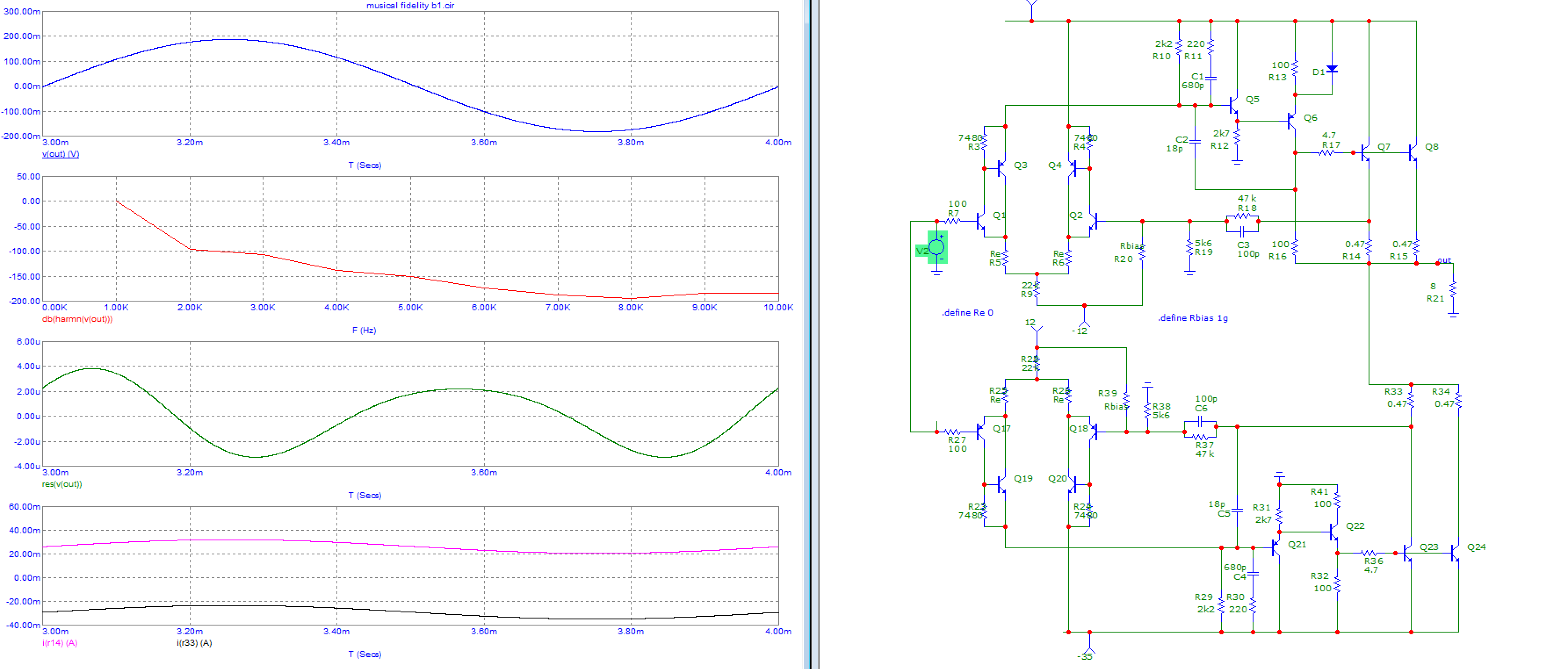

The common emtter/collector/base amplifier stage consists of one amplifying device
I'm sure you can see some similarity between the common emitter amplifier and the CFP on the positive rail on that schematic.
That CFP does not have gain, it does not increase much the transconductance of the compound stage in relation to a single transistor, afaik. This is because Re=Rc=100 ohms on the pnp bjt. It only inverts the phase, and the feedback to the emitter of the npn makes that node behave as a collector.
I didn't think there was an example of this using BJTs; turns out there is, and more than one. I'm referring to the amplifiers by Musical Fidelity, designed by the late Tim de Paravicini. He used common-source and common-emitter outputs. The one that I'm attaching uses BJTs in quasi-complementary topology (but the CFP is on the positive rail to make a common emitter).
Spice says:
It's a pseudo non switching "class A" and each LTP controls the voltage on one side of the output, on the transistor side of the emitter resistors, not on the output side. So it's very good as long as you don't run out of bias, but the transition out of class A and into class-AB really sucks, because one LTP drops the ball when its transistor stops conducting.
With enough bias it should sound good though.

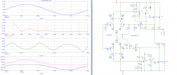

I propose another circuit to play with the hypothesis, or simply replace your input pair with a bootstrapped CFP in a daughter-board. :cool:
The LSK170 being easier to find than the P channel.
Edit: though VFETs are best at the output, this one with Mosfets is also cool, easier to find and way cheaper.
M.

Another unusual circuit
Good explanation dear Mauricio. Unlike tubes, solid state semiconductors suffer a big change of parameters with change of temperature. Feedback might fail to correct this, as Pierre has shown: Memory Distortion Philosophies
Back to "unusual circuits"... Altough I really dislike the brand name, I have to show this one. It is a preamp, single ended out (common source again), cascoded. Uses lateral mosfets, TO220 driver type: 2SJ77 2SK214. Using medium power TO220 and using cascodes helps with the memory type distortion.
The unusual thing is T11 and T15, at the output stage, with gates connected to the drains. The only explanation provided is "it reduces crossover distortion" (T11 and T15). But how? I think it's due to the capacitances of the complementary devices: when current has to change through cascode T10, the charge on the device capacitances must change, and these capacitances create an error at high frequencies as we know. The higher the frequency the higher the distortion due to the capacitances. But the complementary device T11 partially cancels this error, because the charge at its capacitances must change by a similar amount in opposite polarity. Same for cascode T20 and "correction" T15. The cancellation will be partial because they are not perfect complements. It's a similar situation to a fully complementary diff pair with jfets (John Curl): there is partial cancellation of the gate capacitances.
