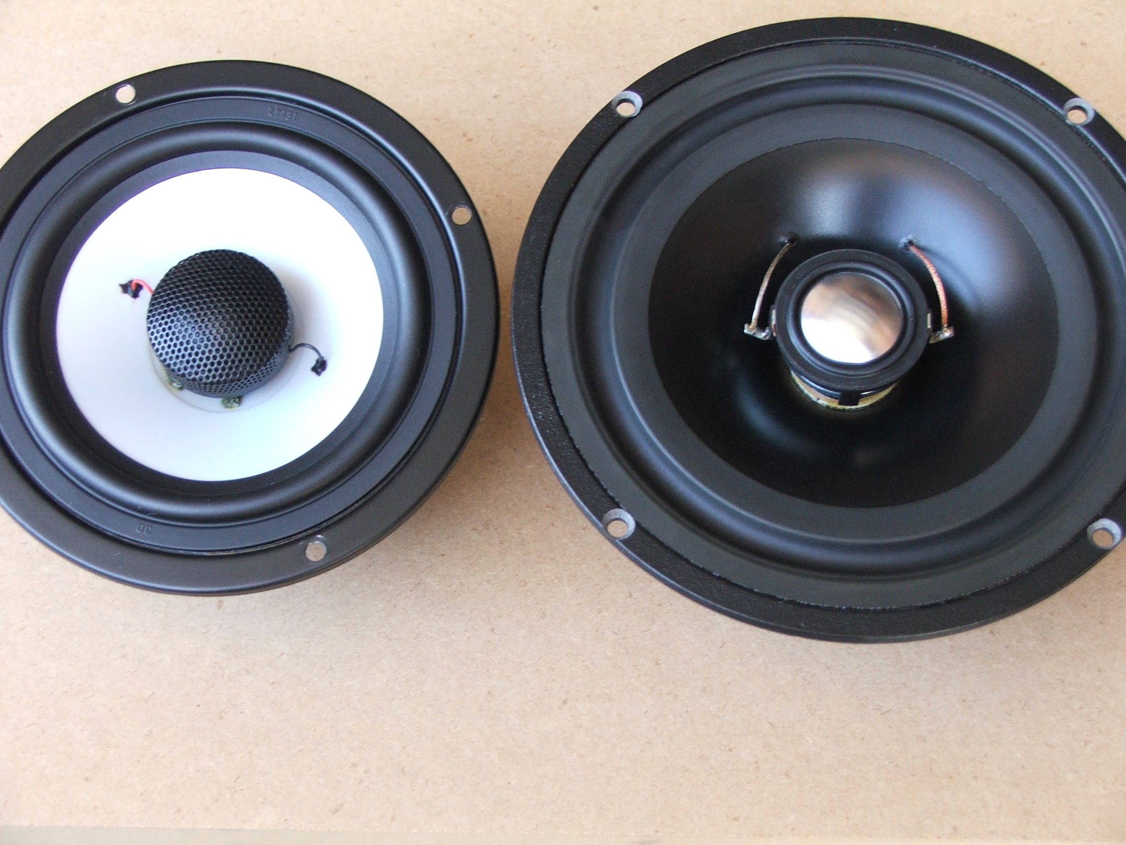

You can do this.

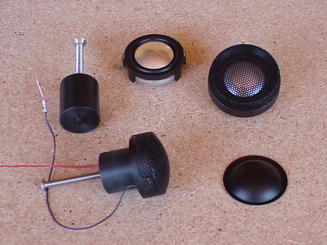

A SEAS P17RCY midbass driver (small woofer) turned into a full range coaxial. Tweeter is a VIFA D25AC-05.
A GOLDWOOD GW-S525 5 1/4 inch small midbass turned into a full range coaxial with the addition of a BOSTON Neo 5t car tweeter.

I have four of these from around 1988, three of them might get "whizzered", although I should experiment on more junk from the recycle store first.

Those were never designed for full range. Even though they are fairly wide range, if you modify them they'll forever be ruined. I used some of them back in the late 80s and I liked them very much. If I had four of them today, I'd make a pair of two way MTMs using some nice small 19mm dome tweeters and an uncomplicated crossover.
I'm willing to bet that there IS some kind of glue/resin filling the holes between the weave on your carbon fiber woofers. See if you can't blow through the cone if you press your lips onto it.

I just could not bring myself to explore with a pin, although I do have Frankenstein style plans for the CF speakers.;)
My best whizzers which I did not post were applied to the largest drivers. In the end they just had too much mass which lead me into another area of exploration.
I knew what I wanted to do and researched it, did not take long to find that similar but not exactly the same things are on certain hi-end speakers already. I'm not sure that I've invented anything new, not very likely but it was fun taking the long way there.
