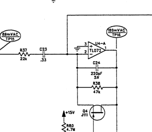

This Clean Gain stage is not clean clean, it increase the high top end frequencies in the lower Vol setting, and become flatter as you increase the Vol.

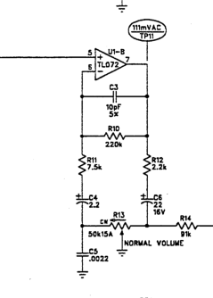

The Vol control range problems can be alleviated increasing R12, I used a 18k.

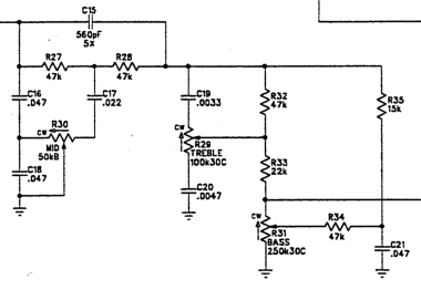

Both CH are then mixed in U3-A to the shared tone stack. which is the biggest problems of this amp. The tonestack is two circuits in series first a mid control which goes from a fairly scooped mids to a highly scooped mid tone too much to the point of being useless. I think that they were going for a super fendery tone. The second circuit is a two tone Bass and treble circuit . The bass is barely moving the frequency and treble control goes too high compared to the bass control. You end with no mids, few bass and too much treble. No wonder the recommended setting is mids on 10, Treble on 1 and bass on 3. That will give a usable fendery tone resembling the knowbs at 5,5,5 in a classic fender. not good. I just simply removed all of that, I put a point to point classic fender tonestack in there.

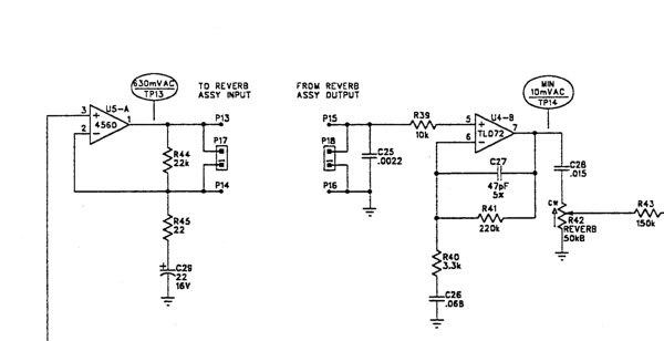

To fix the problem in the reverb, first the mix control goes from no reverb to a surf rock reverb between 1 and 3 of the control. I put a 47k resistor between the wiper and ground to simulate somewhat a logarithmic response to give more control to the mix control . I then put a B1k Potentiometer in parallel with R44 to add a Dwell control.
Lastly I decrease C24 to 100pf to let pass more highs and increased C23 to 1uf to let more bass pass. With the new tone stack those OG tone compensations are not need it. I also inserted an FX loop before R37.

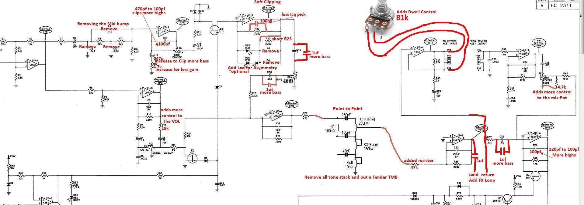

Here are the compendium of all the mods with notes, sorry for the crude use of MS Paint.

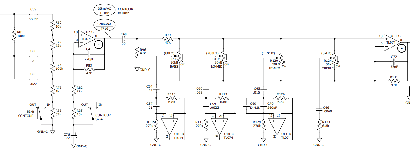

YES, even in the Bass Amps they use the "fender circuit". Here they used fixed resistors instead of potentiometers, I believe is what makes a fender sound like fender.
This is the tone control of a Rumble V3 40w, The countour Switch change the gain of U7-C and change the mids as if you moved the mid control.

Am I the only one who appreciates that tone control circuit for its predictabilty, range and lesser interaction?
IMHO, the classic passive Fender tone control is just awful with its totally weird control interactions that practically fail to confine the dials to work on their specific ranges of frequencies; dial treble and it adjusts mids, dial mids and the mid-notch frequency shifts, etc. And then there's the senseless ranges of the controls where the dial may have a range of -20 dB to cut and a range of only +3 dB to boost, all the while naturally interacting with rest of the frequency adjustments.
Once you get to learn it, that "unorthodox" control can do everything the passive can; but at just much greater intuition of what the control is actually adjusting. But that's just my opinion.
I also like how Fender designers went to great lenghts to design a AAIAB -style circuit when such concepts, or even concept of amp modeling, was just taking it's infant steps. The OD channel is basically modeling the classic "scooped" Fender amp with an overdriven, low-damped output section. FMIC kept using that very same recipe for their amp designs for about 30+ years all the way to the Cyber series and even the "Metalhead". The very same rudimentary design and then..

There is at least another hater of Leo's Tone StackAm I the only one who appreciates that tone control circuit for its predictabilty, range and lesser interaction?
I think the stock tone control circuit on the 25R is not necessarily "a problem" but I remember having to dial the Treb down almost to minimum, push the Mid all the way up, and Bass on the lower side , maybe about the same settings as InvaderLex. On the clean channel, that about got towards a "typical" Fender sound. With distortion channel, you'd be hoping the treble control could go to minus 3 to 5! So maybe it's a decent filter circuit design, but the sweep range is wonky to me. Where you expect a "neutral" Fender sound would be with pot positions at midway (5,5,5), not at the extremes of the pot range. Then you've got nowhere to further cut or boost those settings, so it's less useful. If you don't want overly scooped Fender sound, and having the Mid all the way up gets you near a Blackface sounding amp, well you're not going to be able to flatten much more than that. Has anyone played that amp with Treble on max?!!
I will test the OD with a DPDT switch to turn on and off the mod in U2-B. Originally the tone was bad to me but maybe the problem was not there but in other tone shaping parts of the circuit. I will put it on a switch and leave what sound best to me. thank you.Your modification effectively made the circuit clip harder and at lower threshold.
The TMB Fender tone stack is weird but is so old that it does not surprise.Am I the only one who appreciates that tone control circuit for its predictability, range and lesser interaction?
