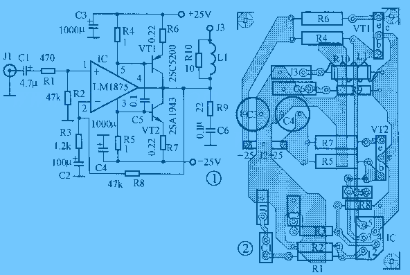

Can this set up increase the output power of LM1875 at 4 ohms??
A single LM1875 will produce 20W into 8/4 ohms at +/-20V.Wonder if add a pair of current booster,will the output power at 4 ohms be increase to,let say 40W at 4 ohms at +/-20V???
Below is an example circuit:
this circuit is good for 35w RMS into 4r at low thd- cannot comment on the layout; when I have used this topology I always put the 1875 in the middle;looks better and lays out with shorter paths
I use 1R5 base resistors and a 220n cap across the 1875 rails and no 0.2r tail resistors; you will also need an input capacitor across the 47k Rin to prevent emi RFI suseptability (I use 22k not 47k and 470pF)
otherwise this is a good device use.
In a former life I used a version of this bridged to deliver 100W into 1R from a single 22V rail for voice alarm with no problems other than heat.
