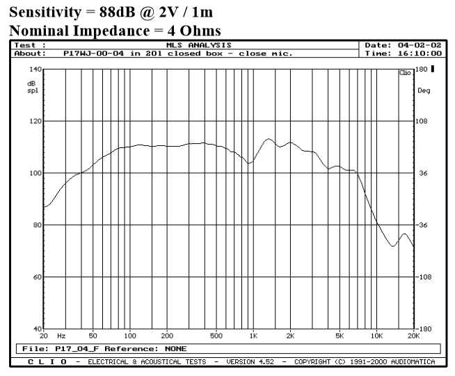

It turns out that the Vifa P17WJ-00-08 theory is just a wrong assumption of System7...snip
Hey cuckoo-clock man, it was EVERYBODY'S assumption. No need to be snarky! :D
The Vifa P17WJ-00-04 data is here: http://www.sea.vg/vifa/P17WJ-00-04_data.pdf
We guess it was a robust SEAS 25TAC/GW with long tinsel leads.
http://www.seas.no/images/stories/vintage/pdfdataheet/h0417_25tacgw.pdf

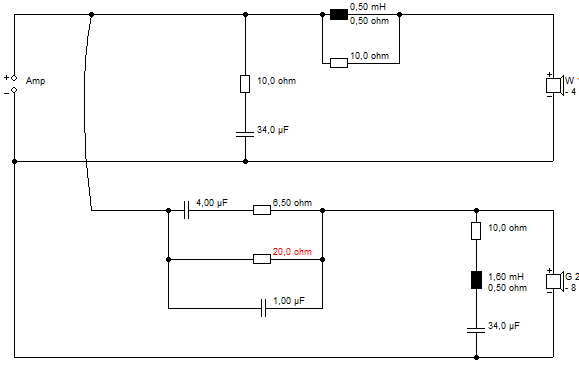

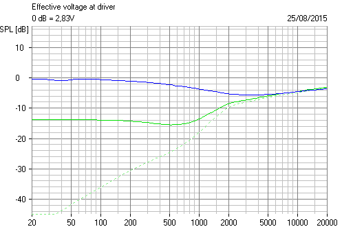

Combine the electrical with the frequency response and it's quite well-behaved. But I'd still lose that 20R resistor on the tweeter, the effect of which is shown in the dotted line. Looks much better to me. And fitting the Vifa P17 8 ohm version, which is still available looks a reasonable fix for broken ones.
