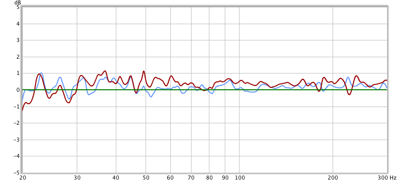

Ummm... I don't know what to say.
If you mean that by listening inches from a driver that you can get an effectively anechoic and possibly "flat" response, and call that "in a room" I guess so. I am still not convinced that you can get a response as flat as the one you presented in a room except in one location. As I asked you, "how does it measure 5ft left or right"? (actually I said "away")
5ft migth be doable with a DBA. Near field sub can be made to work for 2 seats: Comparison of different near field and far field subwoofer configurations
Here's the deviation of left and right ear from the center (green) of my single sub near field setup - note the vertical scale:
By the way, here's data of a damped SBA:
FoLLgoTT's build: 18 x Peerless XXLS12 - Page 2
Convinced?
