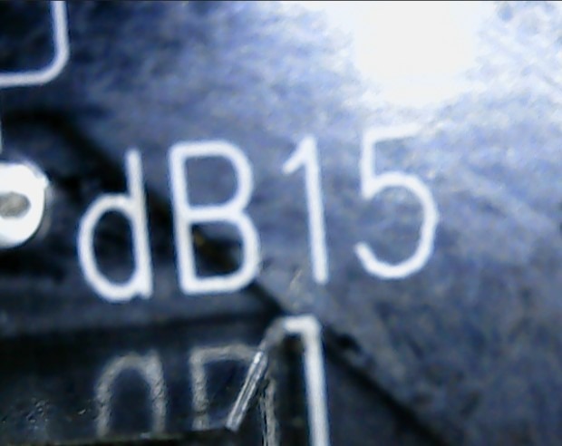

Can someone please show me how to chose a rectifier that will work on a Rockville DB15?
Someone else worked on this amp and when I got it, it didn't come with them installed and the person who gave it to me can't get in touch with the guy who did this hack job. I just fixed another one of these and sold it. I now learned to take pictures and write all info about the amps I work on.

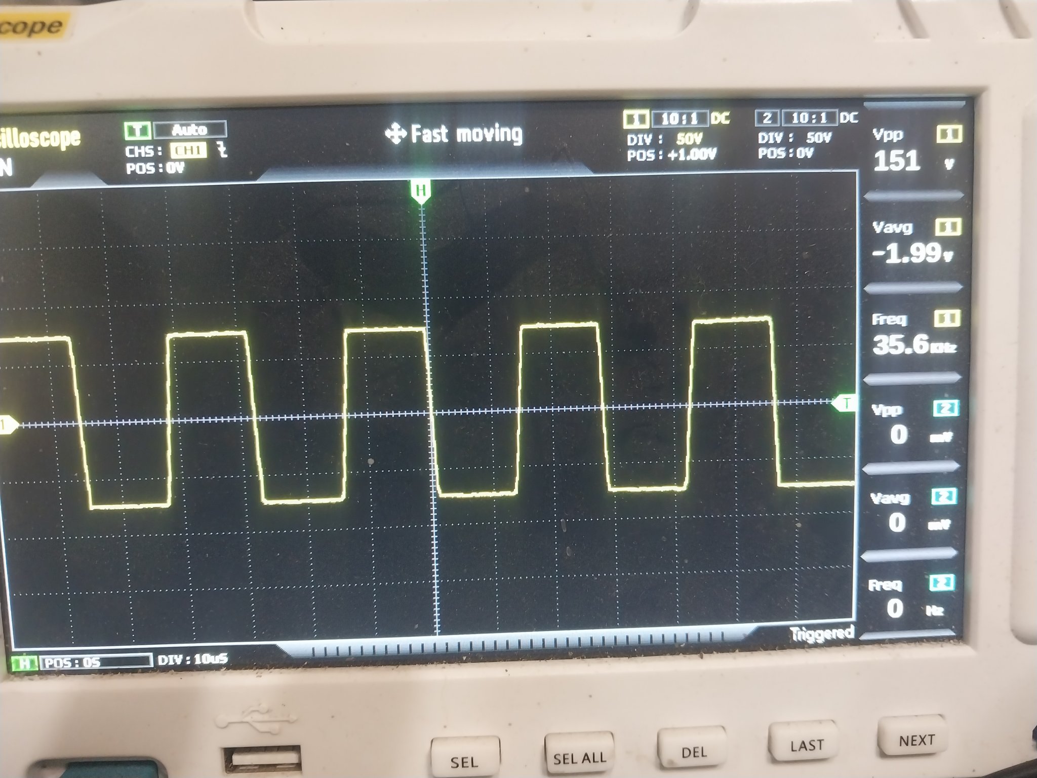

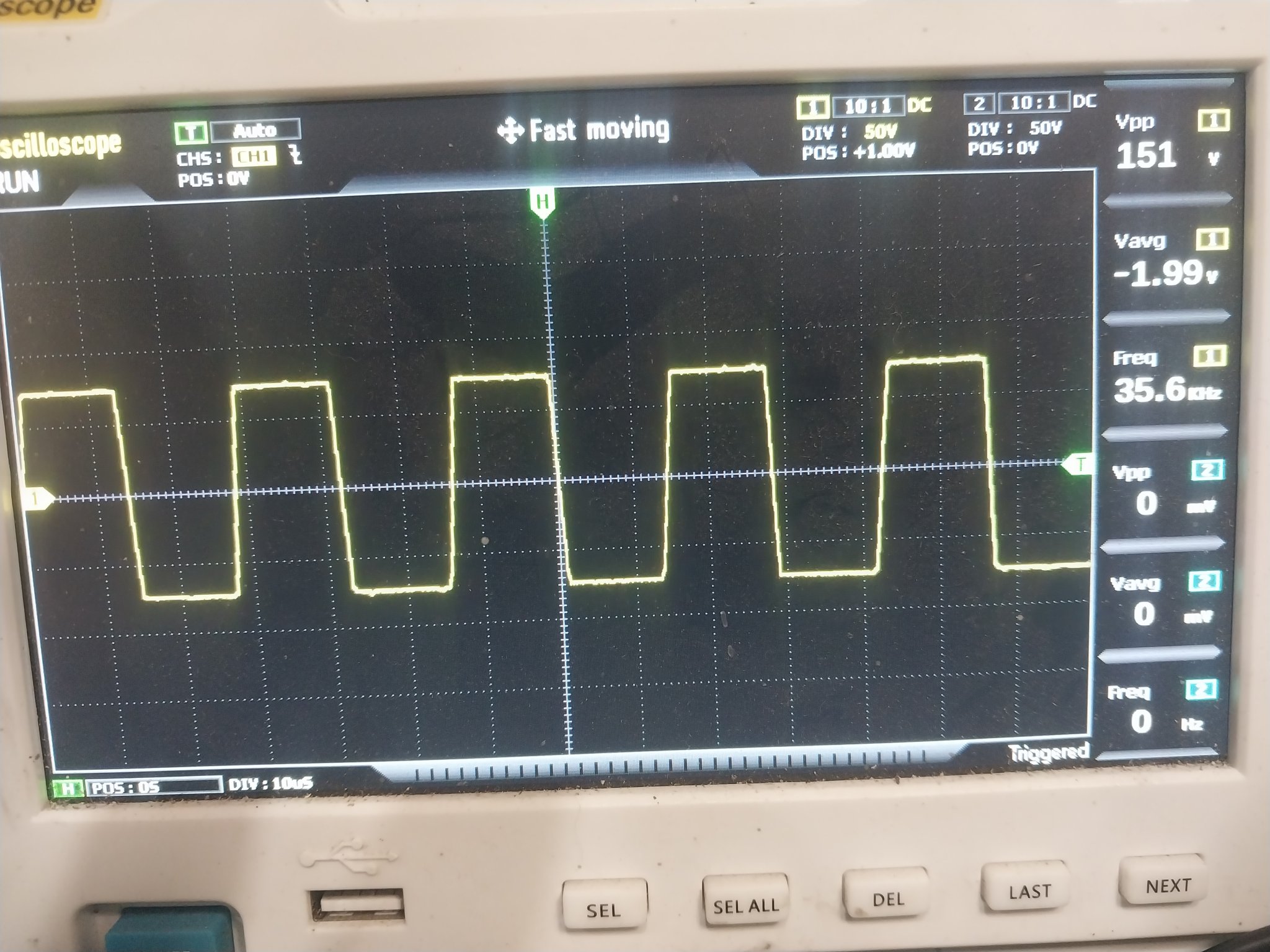

Sorry it took so long.
I had my setting wrong on my scope.
Off of the 3205 center pin = 99.5 Vavg
35.5khz
12.5v from power supply caps to ground.
is that what your asking for?

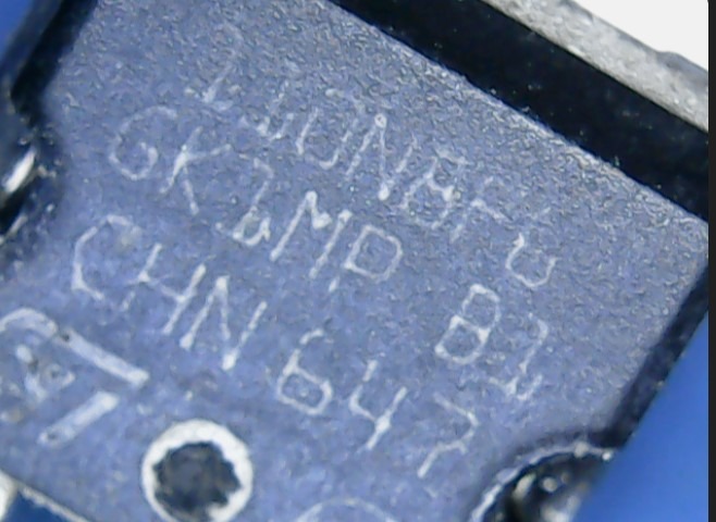

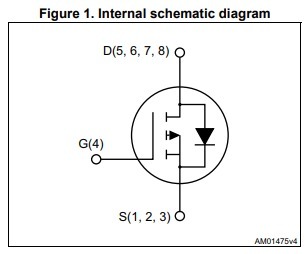

The source (pin 3) of the 110n8f6 connects to rail capacitor.
This Rockville DB15 came with 12 110n8f6. I don't think the guy who had it before me changed them out. There were 2 missing. If I remember correctly the one I had before this had the same 110n8f6 and I couldn't find exact match so I replaced them with 3205, just like I’m going to do with this one. I take your word like gold, so what should I do? I left them in there for testing and fixing purposes. The power supply works fine I just need rectifiers to move on. Can I use MUR1620CT and MUR1620CTR like on your tutorial? I see lots of amp use those.

All you need is 2 rectifiers to find the rail voltage.
What scope do you have?
Can you post the waveform you see on the outer terminals of the rectifiers? Use the secondary center tap for the reference point (black/ground for the scope).
I think the MUR1620 may not be rated for enough voltage.
