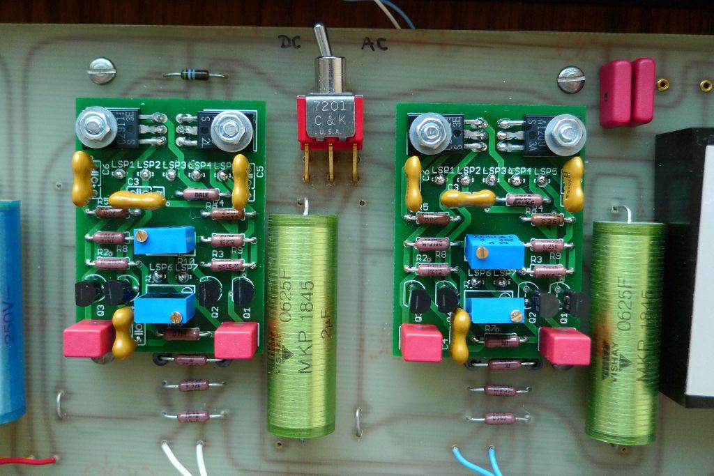

I have built such modules in 2013 for my ML-1 and have them in daily use since then. I used Toshiba V grade FETs which are unavailable now. Attached is a LT-Spice simulation with FETs from Linear Systems and bipolars from Fairchild (both still available, so no risk to buy fakes). Simulation results are excellent (THD 0.000038%).
Thats what the new modules mentioned in my last post look like.

Well, he mentioned using Toshiba V grade JFETs in his own build.
Simulation is with Linear Systems JFETs, which has different transconductances, especially for PJFET.
The photo shows output devices as 2SA1209/2SC2911.
The Spice model uses KSA1381/KSC3503.
So I would not say they are the same, but compatible.

Yes Patrick, you are correct. I looked it up and actually I have built those in 2009 and the Fets were Toshiba V grade and the output devices Sanyo 2SA1209/2SC2911.
I bought all of them from Erno Borbely at that time. All of these are not available any more.
The purpose of the simulation is to show that this could be built with parts available new today. Matched FETs are available here at the Store:
Linear Systems Matched JFETs – diyAudio Store
KSA1381/KSC3503 are available at e.g. Mouser.

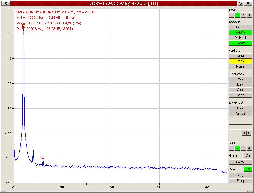

Did you even run any actual measurements on your finished design? The LT Spice sim is impressive and I'm curious to know how close the final design came. Yes, I know the parts are different; the older, original Toshiba JFETs are probably better (higher Gm, lower noise?) than the Linear Systems and the latter Fairchild BJTs are probably better (lower capacitance, higher and flatter hFE?) than the Sanyo BJTs.
mlloyd1
mlloyd1
Yes, I did try some measurements but they were not really conclusive because I dont own equipment to measure that low. I used a RME ADI-2 (the old one, not the new ADI-2 Pro which has lower distortion) A/D D/A combination and the result was basically the same with the JC2 in the loop and loopback.
Attached is the screenshot which shows some 2nd and a tiny bit of 3rd. The JC-2 alone probably has lower distortion than that.
BTW in simulation the KSA1381/KSC3503 have almost 15 dB lower distortion than the 2SA1209/2SC2911.

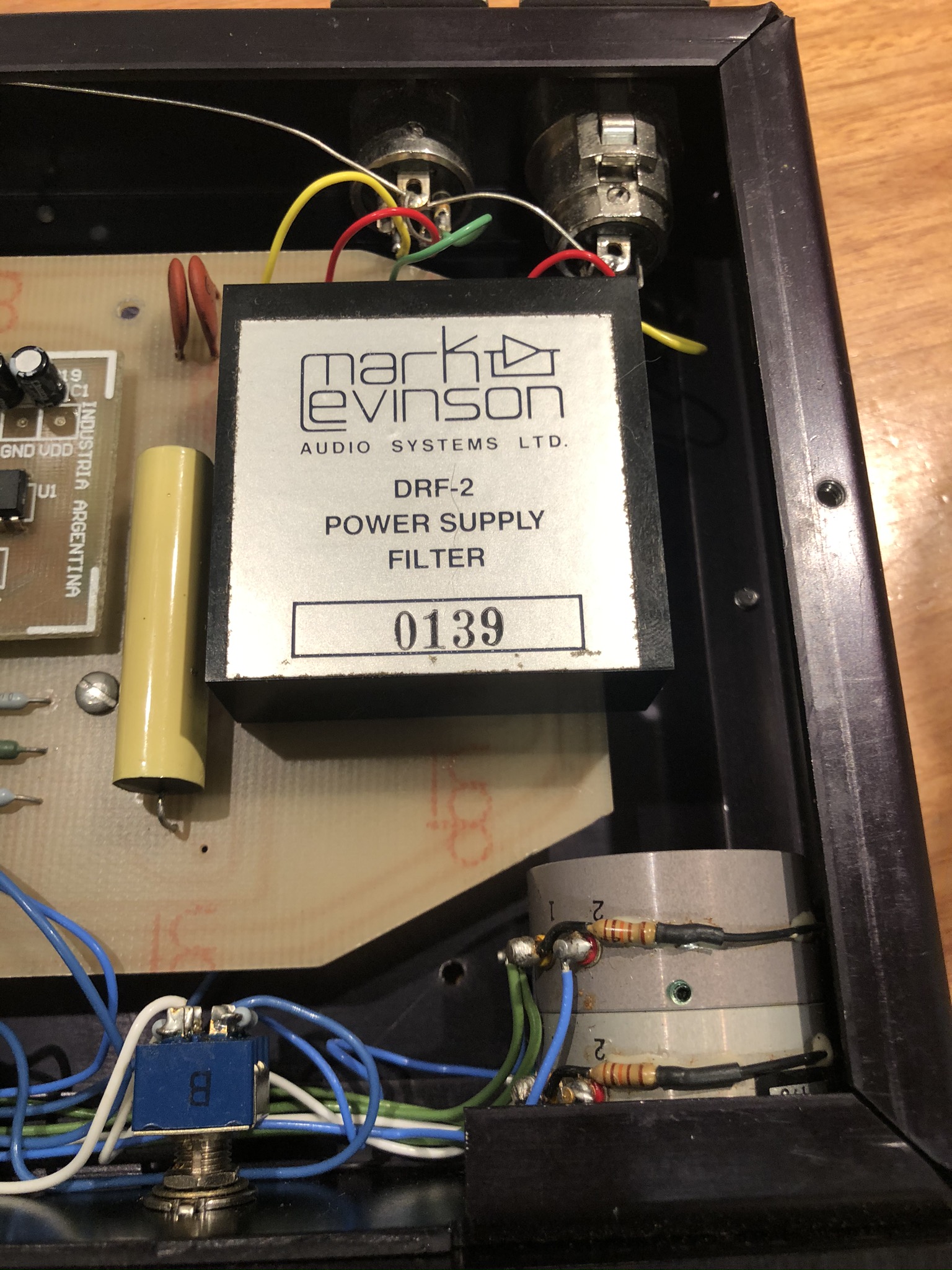

Now, there IS a difference between the JC-2 and the LMP-2 line amps. The first LMP-2's used IC's (inside the modules) and they required much less current to operate. Therefore the power supplies for the LMP2's was only 100ma. The JC-2 required a 300ma power supply. Please note LMP2's power supply capacity when making modules to suit.

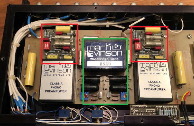

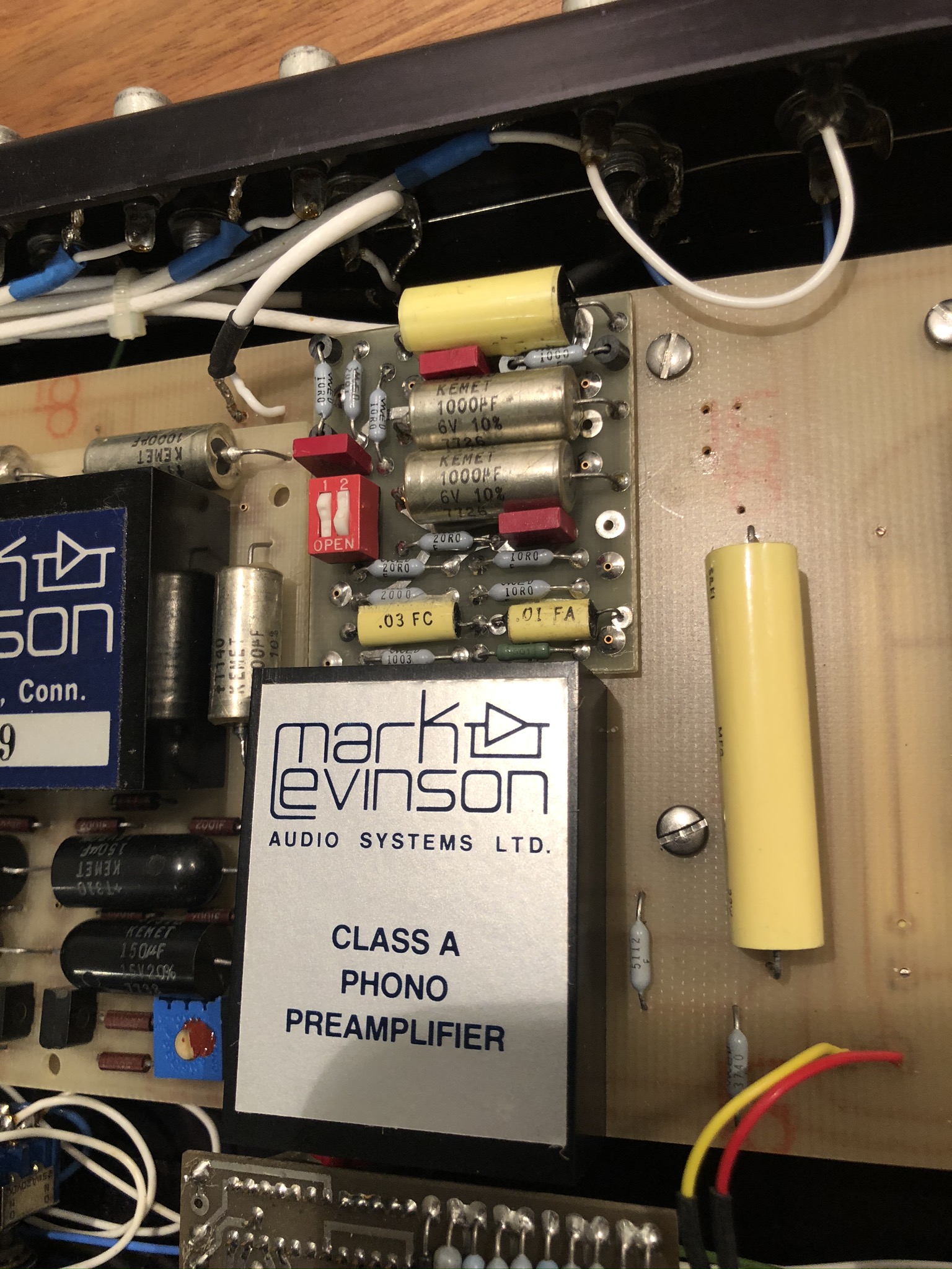

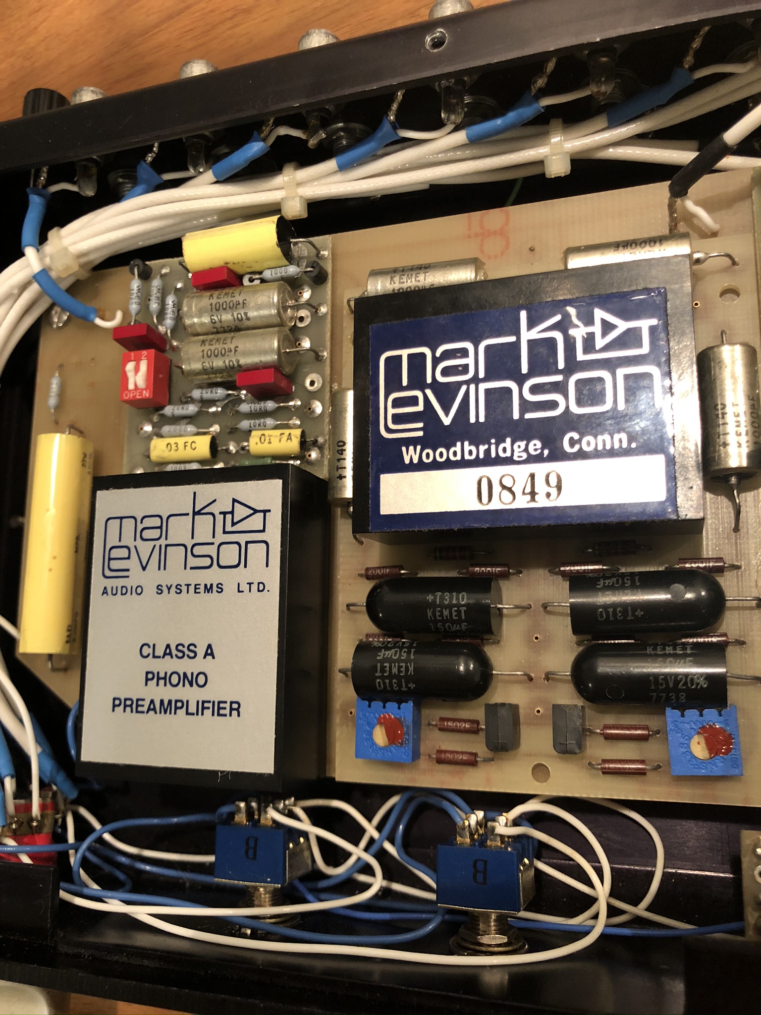

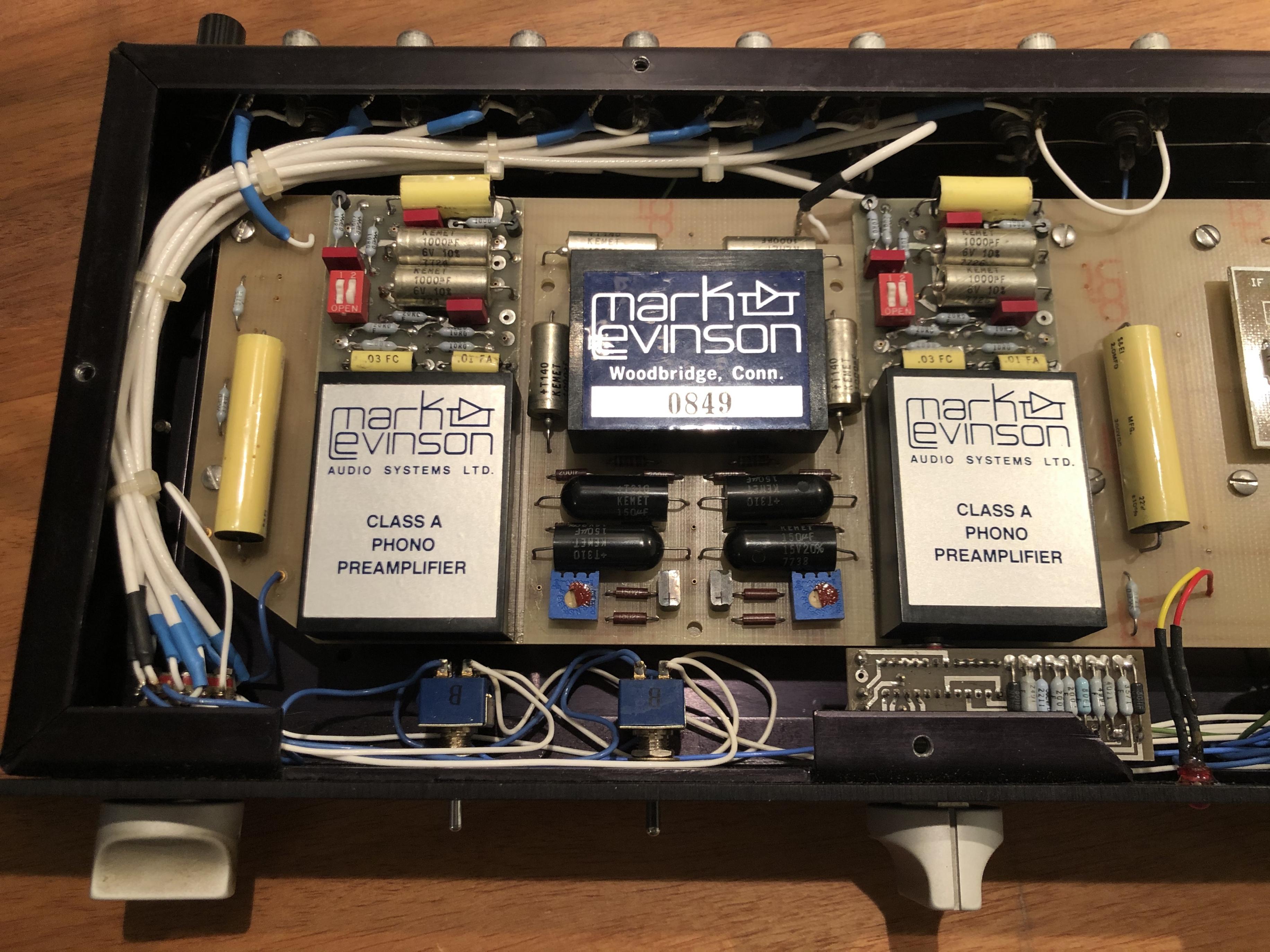

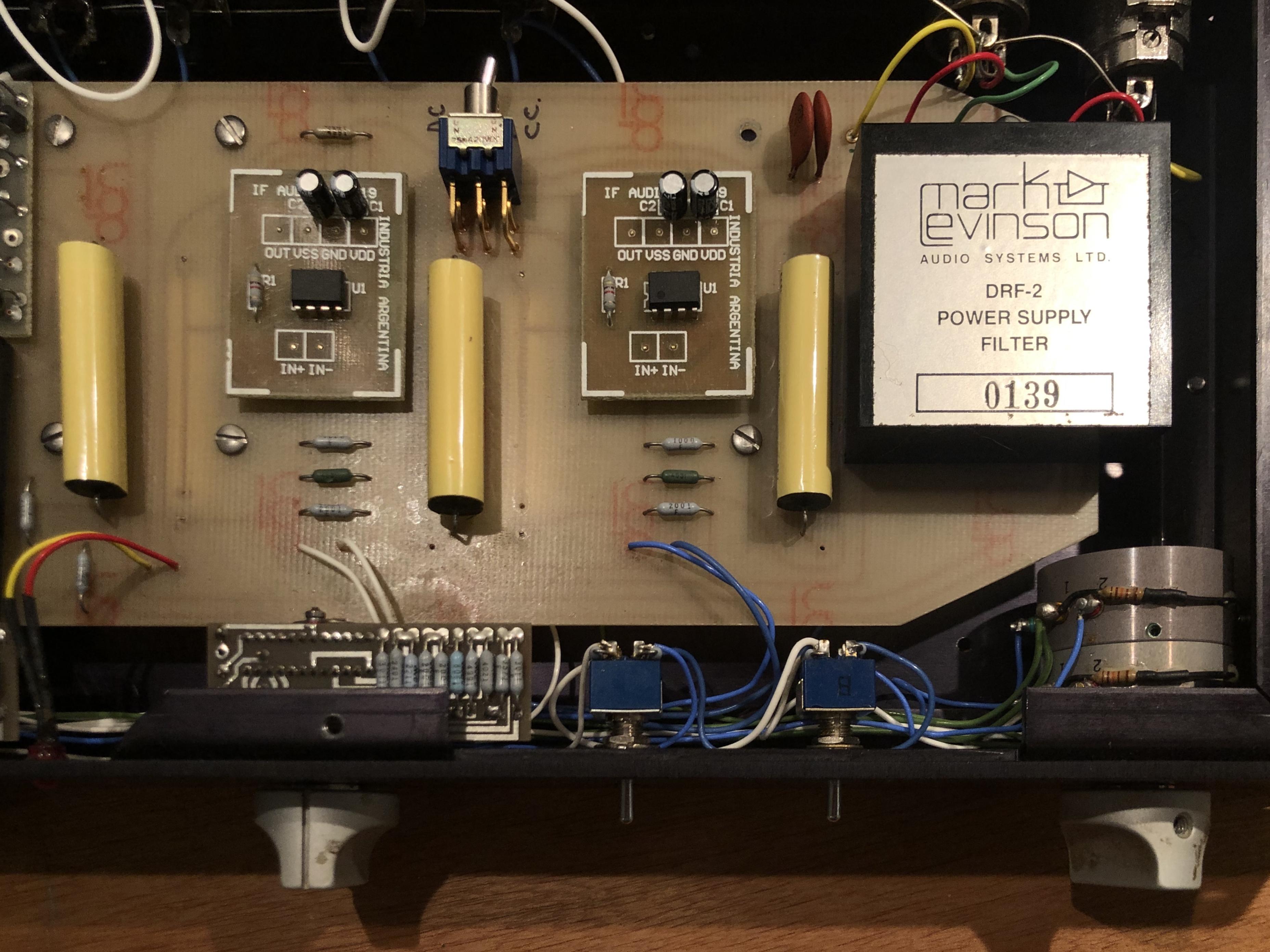

Dear John,
I have just bought this superb piece of equipment which is the JC-2, and even though Im enjoying it, I'm not sure about "what is actually inside it".
I'm attaching pictures of my unit, and as you can see there are 2 modules over the Phono modules and I cannot identify them. Could you please help me out?
Both line modules were made from a local company, but I might change them shortly.
Also, I can't find much information with regards to the phono section. My cartridge is a SAEC XC-10 (0.25mv output, Internal impedance 4Ω) and Im neither sure if I should use a step up or just plug it to the preamp.
Kind regards from Buenos Aires, Argentina
Fernando
Well, I´m not John, but your JC-2 has the MC pre fitted (between the two phono preamplifiers), so you do not need a step up.

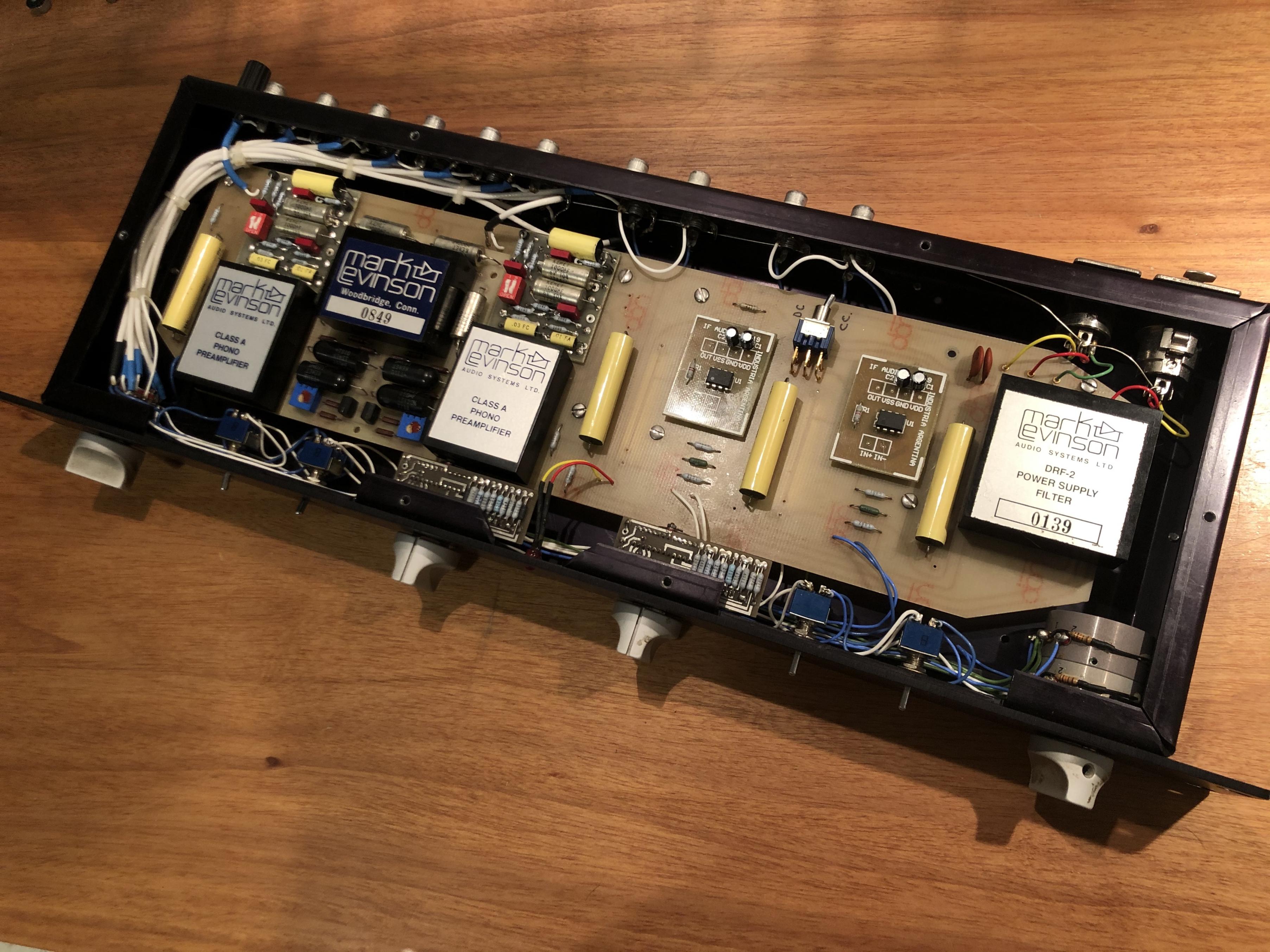

Hi Georg!
Thanks a lot for your comments and info!
So if im not mistaken, from the image attached the module framed in green is the MC head-amp, and the modules in red are the gain/impedance modules, though im not sure if they are the D5 or D6 ones.
Since my cartridge is .25mv do you know how should I set them? I apologize for my huge ignorance in the matter
Regards!

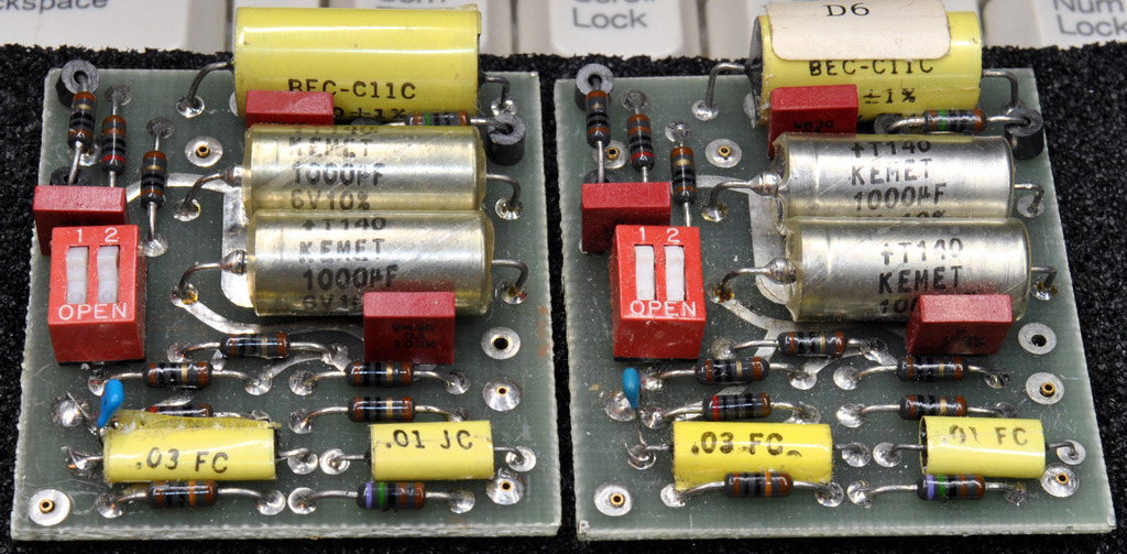

yes the green framed part is the MC head amp. I myself dont own the headamp and have an A4E card but from the photo I guess yours is the D6 (see attachment). Normally these cards have a little sticker glued on where the type is noted.
Personally I would leave switch 1 open (CRC out).
For a nominal .25mv input 60dB (switch 2 open) will give 250mV out and 66dB (switch 2 closed) will give 500mV out. Both values are sufficient but you can try both settings to see which one is a better match for the level of your other sources. At any rate, always turn the volume completely down before operating this switch.
