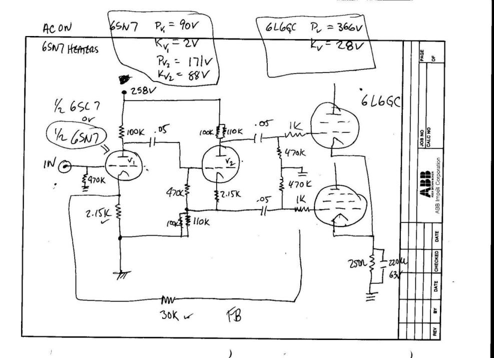

I have an Aikido Pre (Bas' boards with power supply) and it is near complete. I am in the middle of a cross country move and my life is in a standstill at the moment.
Question is this - can I make an amp with the Aikido front end connecting directly to a tube output stage? SE or PP?
Is there a schematic?

I have available to me a Hammond 1650N Transformer (2 actually).
I would need the phase splitter in front of the PP and after the aikido. Hmmm...
Is this worth the trouble? Do you think it would sound good?
Currently have a 6SL7 (or 6SN7 - long story) driving the 6L6GC...

http://imageshack.us
upload the image full size and use the "thumbnail for forums" option, copy and paste the link into your post, so we can read it then we can talk about it
