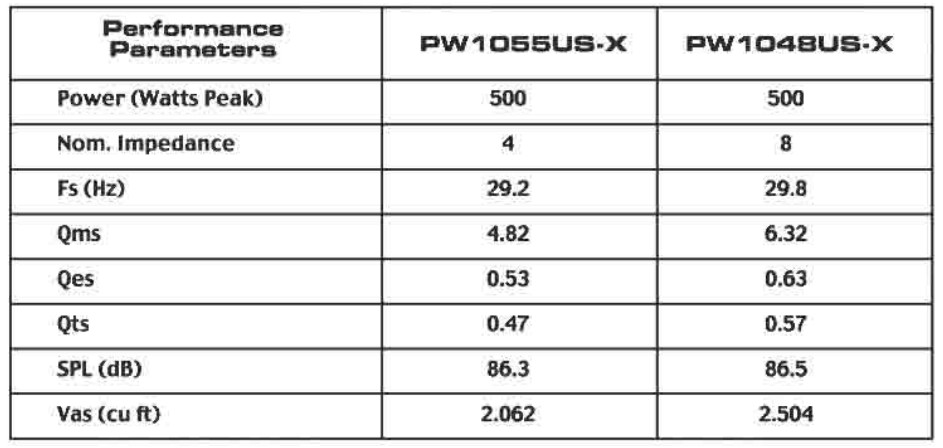

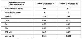

Can i use this driver for home subwoofer?
Link here for some T/S parameters. Go to where it says - Manual Download
Pyramid - PW1048USX - 10'' 500 Watt High Performance 8 Ohm Subwoofer

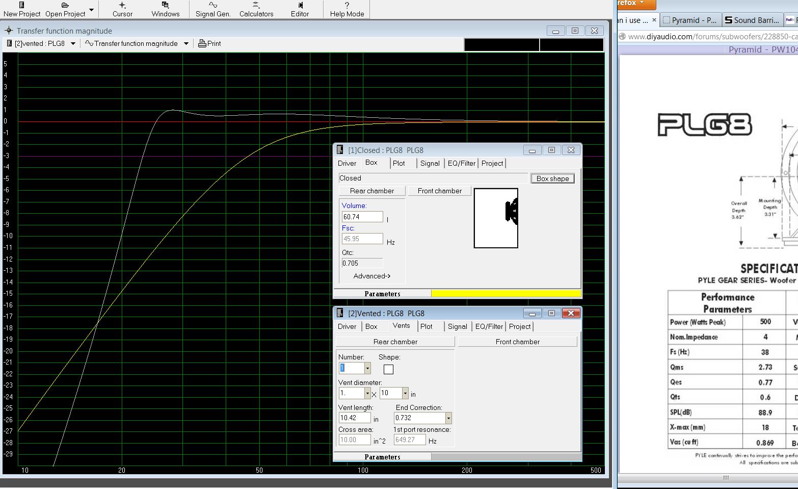

Download WinISD, you'll be glad you did!

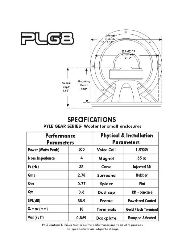

One 8" car woofer for a HT probably won't float your boat for HT. (how many do you have?)
Sealed looks the best choice, but the woofer may just be a one note thumper no mater what you do.
Vented box is 80L/27Hz
