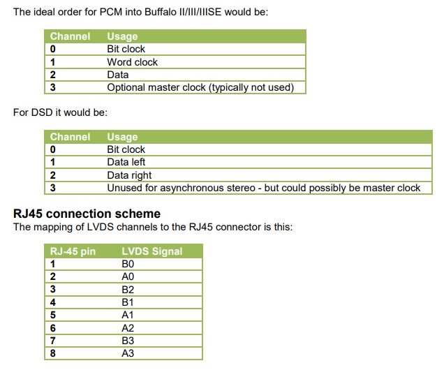

The teleporter has 4 channels - just enough for PCM plus an external master clock. If you used the Buffalo 3's onboard master clock in asynchronous configuration then the free teleporter channel could carry DSD. But if you want to use an external master for synchronous PCM on the Buffalo3, it seems as if your options are either a second pair of teleporters or perhaps some kind of mux (Otto?) into and from a single teleporter pair. Controlling the mux for 'on the fly' switching between DSD and PCM might be possible by modding DimDim's code - he would be the best person to help there... Good luck with the project!

Sorry, I'm so used to I2S with left-right data combined! For two channels of normal DSD you would, in fact, need either a mux or a second teleporter. I'd personally go with the the simpler solution of two Teleporter pairs. They are small, efficient, and simple to power.

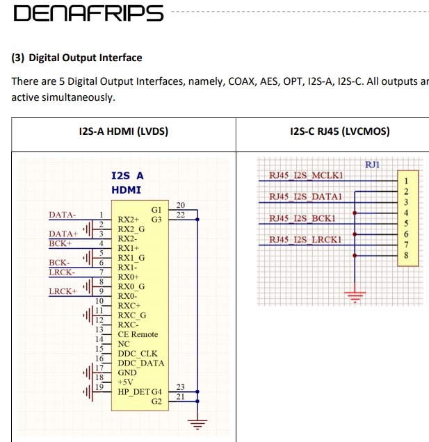

But hold on. I peeked at the Denafrips Iris specs and I suggest you be sure you understand its outputs. link here. Re: DSD output, the specs say: a) DSD64 (DoP) on Coax/AES/Opt Input & Output; b) Up to DSD512 On USB Input & I²S Output. It seems the Iris only does DoP, which is a format standard for DSD data. Read more here. The ESS Pro DAC chips happily manage DoP format data 'on-the fly' and therefore it appears the Denafrips Iris only needs the I2S connection to the DAC - no separate DSD connection. [So that also also raises the question of why and how you will implement and use the Arduino code, a separate issue.]
Bottom line: It seems you would be good with only a I2S connection to the DAC. The next question is efficient wiring and note that the Iris HDMI connector, labeled I2S-A, uses a LVDS format (low voltage differential signal). Teleporter uses LVDS as well and wouldn't it be cool to "get them talking'? Note Teleporter LVDS transceiver chip photo below, and I believe the correct data sheet is this one. I suggest you contact Denafrips and get to one of their engineers. Have them advise you on the compatability of their LVDS transceiver to the Teleporter's. Also note the useful Teleporter configuration information in the first post of the Teleporter thread: https://www.diyaudio.com/community/threads/introducing-the-bit-teleporter.201106/#post-2793604

Background thought processes goin' on here - I don't see any MCLK in the HDMI connection, so while the HDMI LVDS would probably work into a single Teleporter, the Buffalo would be limited to asynchronous mode. That's not bad, but if you are a boundary-pusher with high definition analog gear I have a suggestion for using the Buffalo in synchronous mode. Use the normal two teleporters (send and receive), and hook up the one into the Iris using one of these: https://www.adafruit.com/product/2913. Nearby power for the teleporter could come from pins 17 & 18 of the HDMI jack. This jack source is supposedly good for up to 300mA - plenty of juice for the Teleporter.
