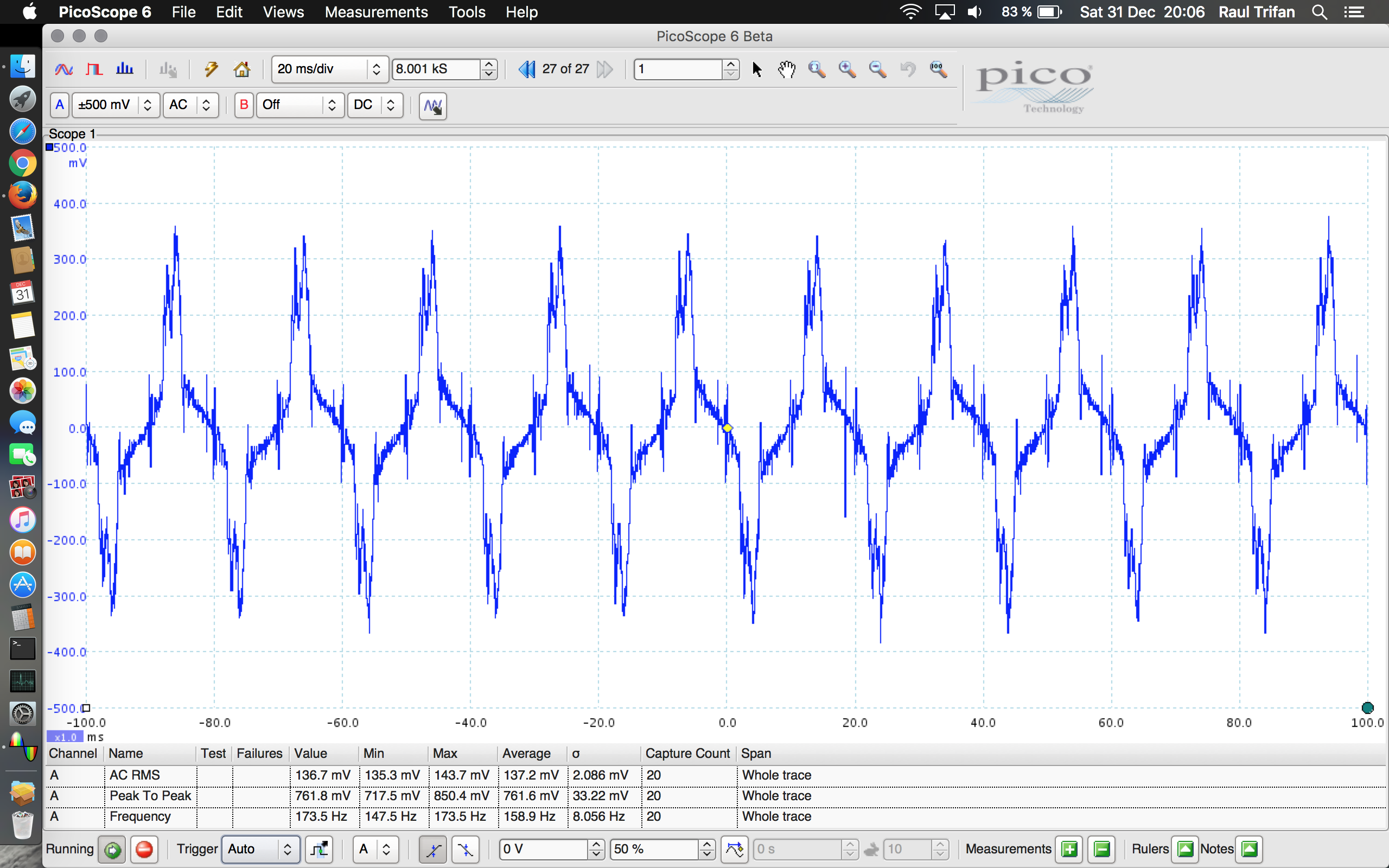

I've used my PicoScope 2204A to measure how my home AC lines look like. Because scope inputs are not isolated (cheap scope, I know, but it helps me a lot) the scope was inserted into the USB port of my laptop running on internal battery; this way I'm sure I won't burn anything, because scope and laptop are isolated from mains now.

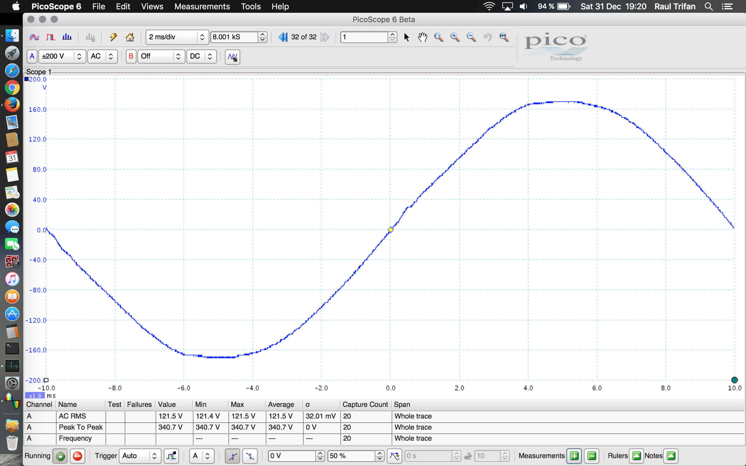

I've also used a 230V to 120V transformer, because max. input voltage for this scope should not exceed 20V and by using a 10X probe that translates into a max. of just 200V.
1st pic shows the mains AC sine-wave (not perfectly sine, but still looking good I's say).

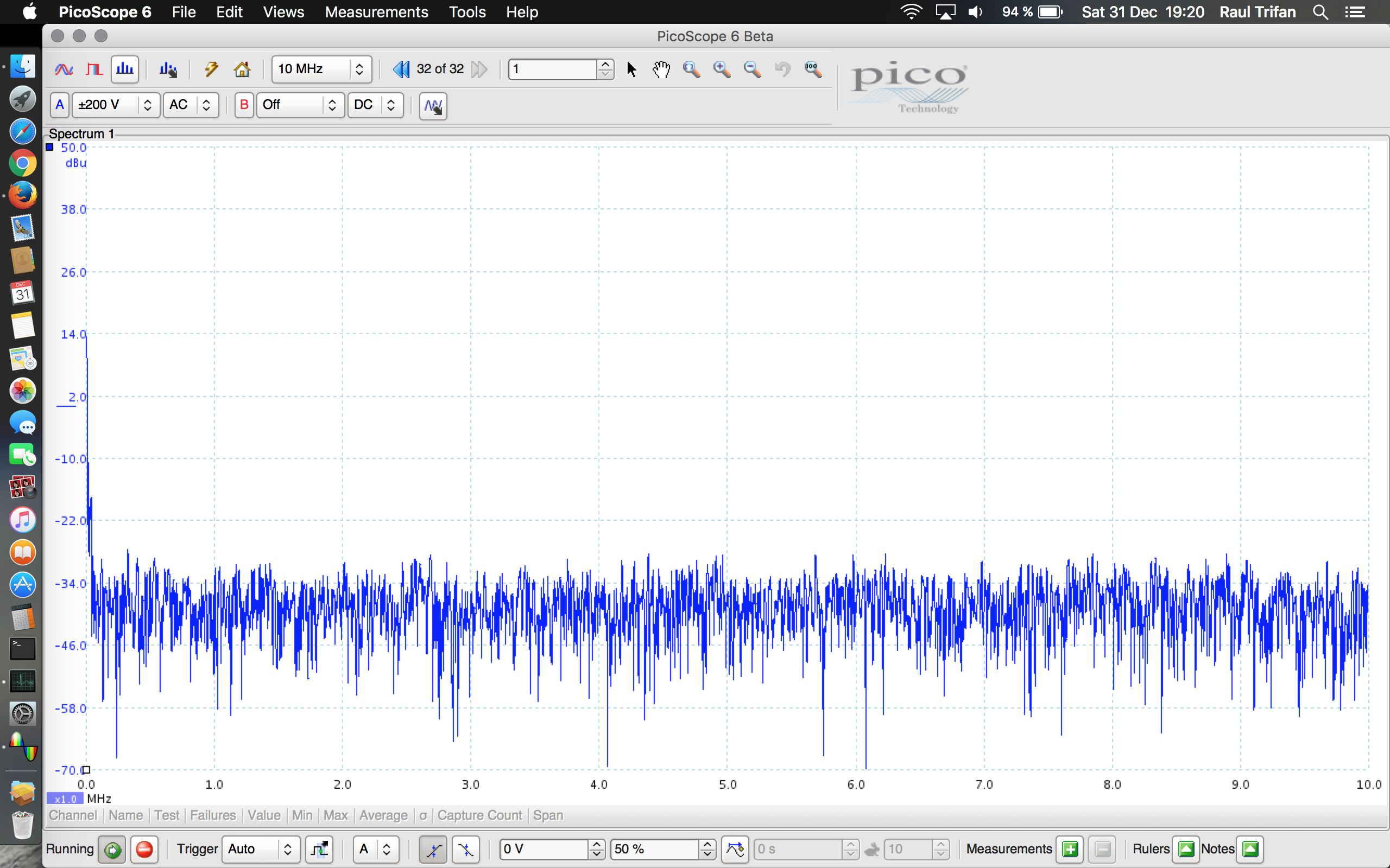

2nd pic shows AC noise up to 10MHz.

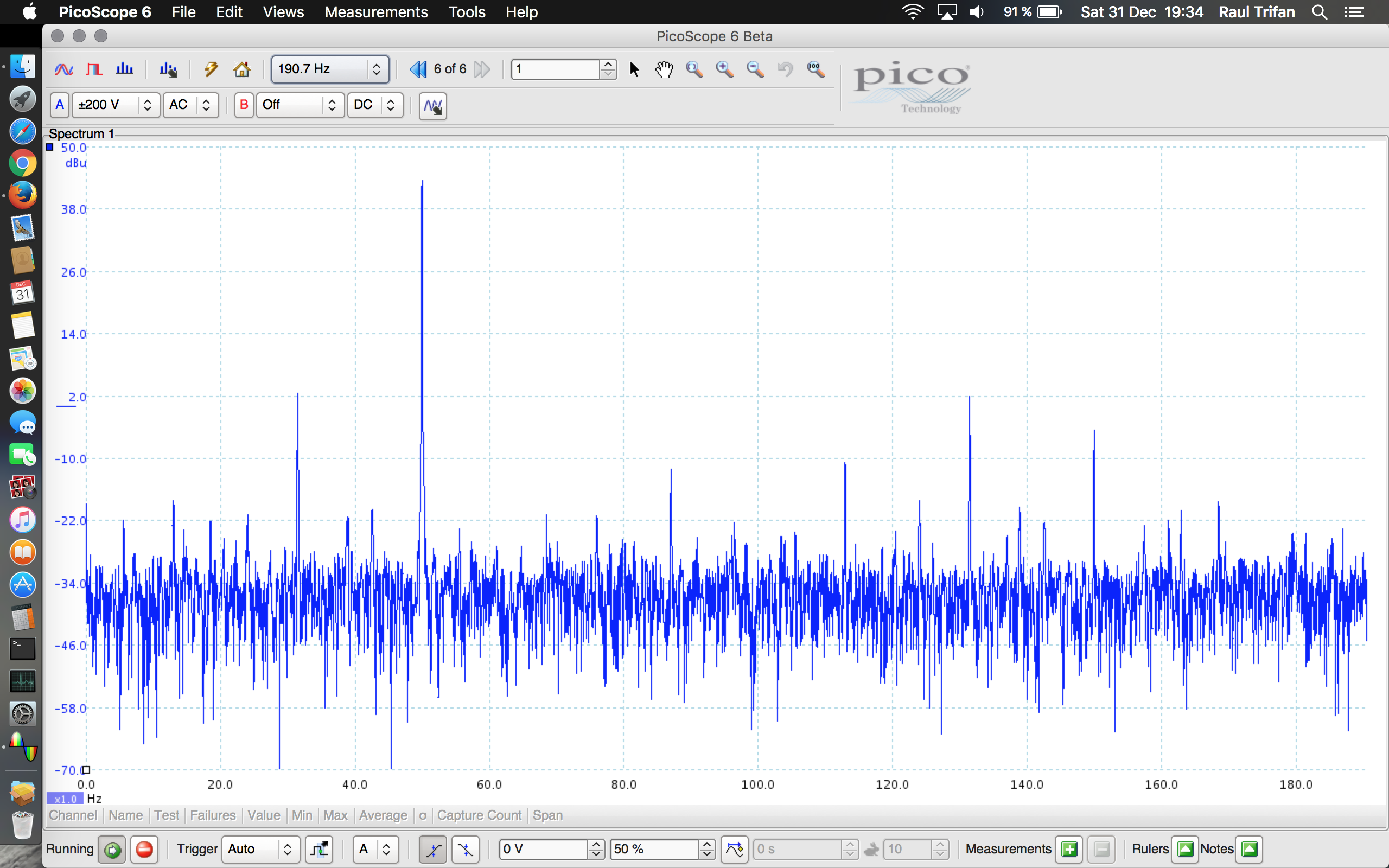

3rd pic shows AC noise up to 190Hz.
4th pic shows "average" AC noise up to 10MHz.

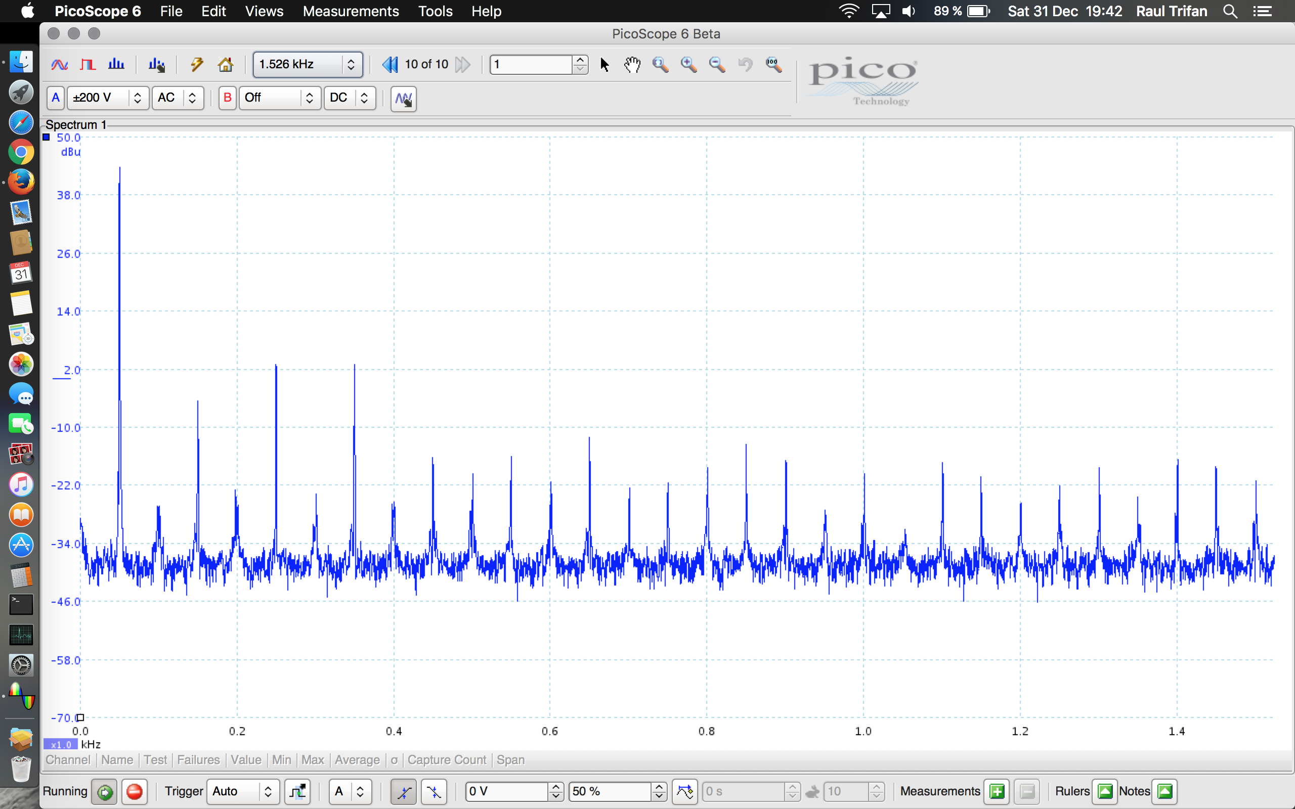

6th pic shows AC harmonics up to 1.5KHz.

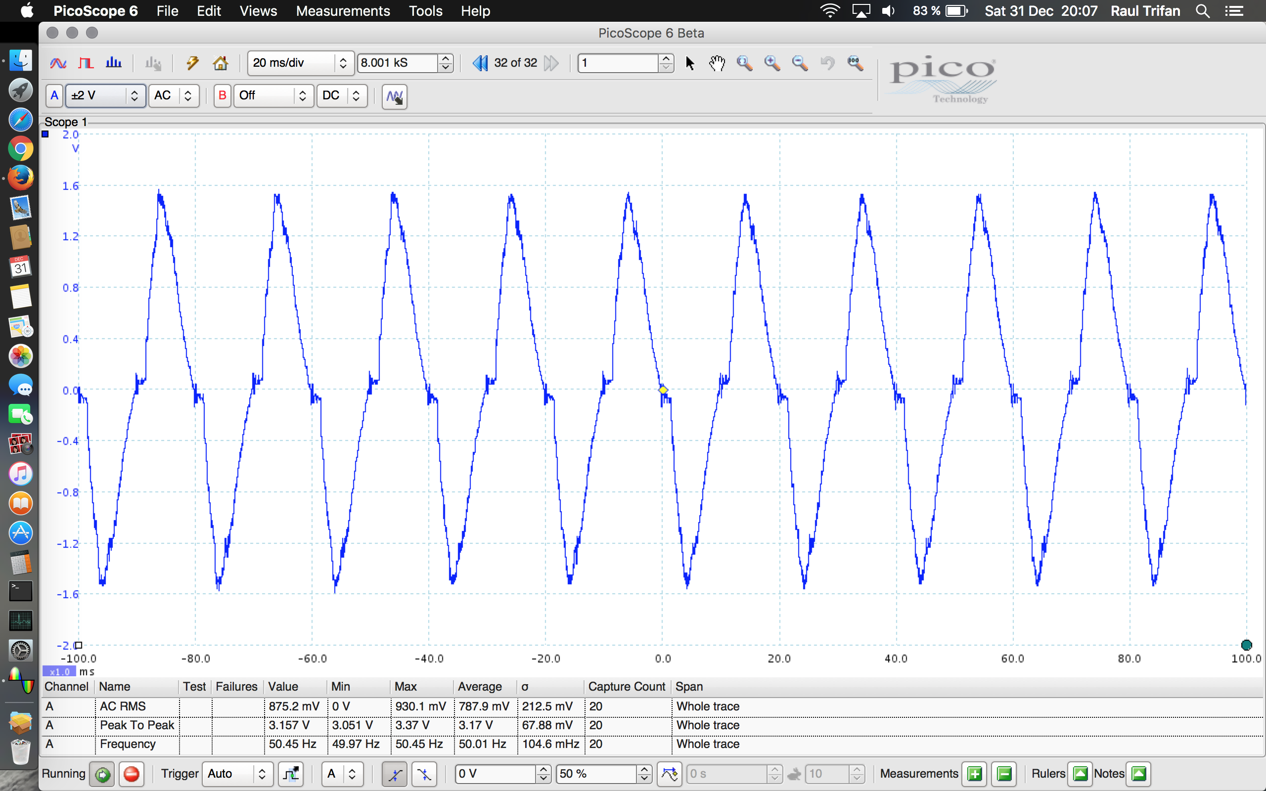

The last 2 pics are showing the noise measured between GND and Neutral: 1st pic without anything connected to that circuit (136.7 mV RMS AC noise) and 2nd pic after connecting a vacuum cleaner (875.2 mV RMS AC noise). Looks like ground pollution by electronic appliances from our homes are indeed much trouble to our audio chain.
I've tried to lower the ground noise by using noise suppression filters, but of course I couldn't. The only way to lower the GND noise was to lift the ground correctly, not just lifting the GND pin (people might die because of this!), instead by using powerful diodes and caps between GND of the Hi-Fi equipment and the GND of the mains. This is similar with what Hum-X or other devices do and should be quite safe if using properly.
Note: While measuring the noise between Ground/Earth and Neutral I've swapped Neutral with Live and 230V got into my scope (I can't remember if I was using the 1X or the 10X probe). I'm happy that scope didn't broke and nor my MacBook Pro, so don't try using your scope probes directly into mains unless scope was designed for this task!
