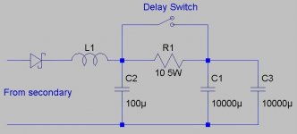

Hi Carlos,
You so exited! Did my explanation really meet your expectation?
But don't afraid when you test your modified PSU at first time and the PSU did not started. It the only possibility caused by short circuit protection, that triggered by rush current. It may caused by your diode that fast enough. It may caused by big charging capacitor. or your output shorted. Don't think complex such as your your control circuit failed since the PSU was works before modified.
For delay caps it is just simple delay. See attachment. Use simple delay relay will work. Another trick is you can connect the relay coil parallel to the DC protection relay coil that usually also have delay to avoid 'dug' at switched on if you have it. Remember that you still have 12V existing voltage to do this job, ok!
Oh yes... almost forget, remove the ceramic cap at the mains input to ground, unless otherwise your amp chassis is always grounded.
You can not increase the power max. because your PSU size transformer usually as ETD34 that arround 400W capacity. Hence the existing part is no need to modified. I have idea to try with bigger transformer and fets with small modification for current sensor. But I have no time yet. If you have time to try, it will be good to heard for other DIYer. It may you will the first people.

If you are worried about your huge caps activating the short circuit protection on the output, use a wirewound resistor in series with output to start, then clamp with a relay after a second or so.
In my experiences I've noticed even as low as 0.1 ohm will work fine, and that's low enough to not really need a relay, but you can still use one.
That circuit posted above is a perfect example. Of course, you can change the resistor, or delay to your preference.
Have fun, and post results when you get it working!
