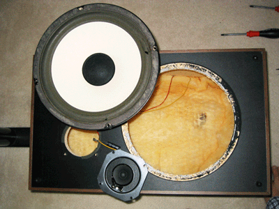

I got a pair of 20year old AKAI speakers (10" woofer and 3/4" tweeter set), when I rip if open I only saw one 8uf cap as xover...the sound is terribly bad and all surroundings on the woofer is wore off. Since it is impossible for me to do the box myself I think I might reuse the enclosures to make a new pair (10"woofer and 1" tweeter), the enclosure is about 1.1cu. My questions are: Is is practical to do them? Is there a design for this type of combination out there?

Ok, Let me rephrase it this way: I have a pair of enclosures with front opening for one 10" and one 3/4", it's about 1.16cu. now I am going to buy a new 10" woofer and a new 3/4" tweeter (budgetary line), How can I get a crossover design? I am pretty sure that these kind of combination (10" + 3/4") is pretty rare nowadays....this AKAI had only one 8uf cap on the tweeter side as its crossover, imagine in the good old days...

The enclosure has no brace inside, only a piece around 10" disk stick to the rare wall behind the tweeter (looks like the 10" cutout from the woofer), and it is made out of 3/4" or 7/8" plywood. I think adding some braces inside is a good idea because it is quite big in volume...
My recommendation would be to just glue/fasten a piece of plywood over the front (baffle). Then use some existing 2 way design, maybe even a kit, and cut new mounting holes for the drivers. I would try for a sealed design, covering any vent that was in the enclosure. Otherwise, you'll have to do a whole bunch of work to reverse-design drivers and crossovers for that enclosure, and you'll probably spend more than you thought it would cost.

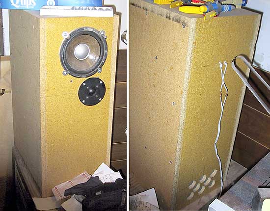

Depends entirely on what 6" you use. I did just this with a 2.3 cu ft box that had a 12" stuffed into it. Took a 6" i had salvaged, tricked it up, added some open-back Audax tweeters i had laying around -- used a simple cap XO at about 6k. In the end i had to make the box aperiodic because the 6's Q in the big box was still a bit high (it started out high), and got something surprisingly good (the 6s were originally stuffed into a MUCH smaller box where they didn't work nearly as well). One of these days i'll actually finish them off (my brother is using them and won't let me take them away)

I popped over to my bro's and snapped a couple pics. I was able to peel off the old vinyl wrap on these. You will also note the high level of detailing -- the stripped screw that is now just filling the hole on the 6", the high performance natural partical board un-finish, and the budget speaker terminals on the back :D
These are called J1s (J is for junk), but they will cream many a speaker that people actually spent money to buy.

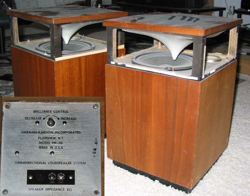

Your project has me thinking about the flea market speakers that I picked up for $2. At the time, the web had just barely begun and there wasn't nearly the DIY support there is today.
I would just go for it. You could learn alot by playing with a less expensive woofer and plugging the specs into the calculators and seeing what happens. You could even cut a port. All you need is a hand drill or even a rotozip.
I want to build a pair of speakers but have really no experience so for experimental purposes, I bought a pair of 8" MCM aluminum woofers. I don't have drivers laying around. I plan to build some different enclosures and compare them: sealed, ported, and transmission line.
The worst you could end up with is a pair of speakers for the garage...or a relative. ;)
