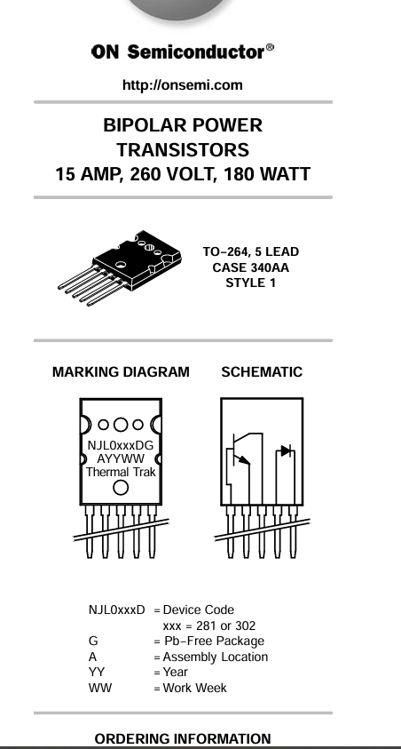

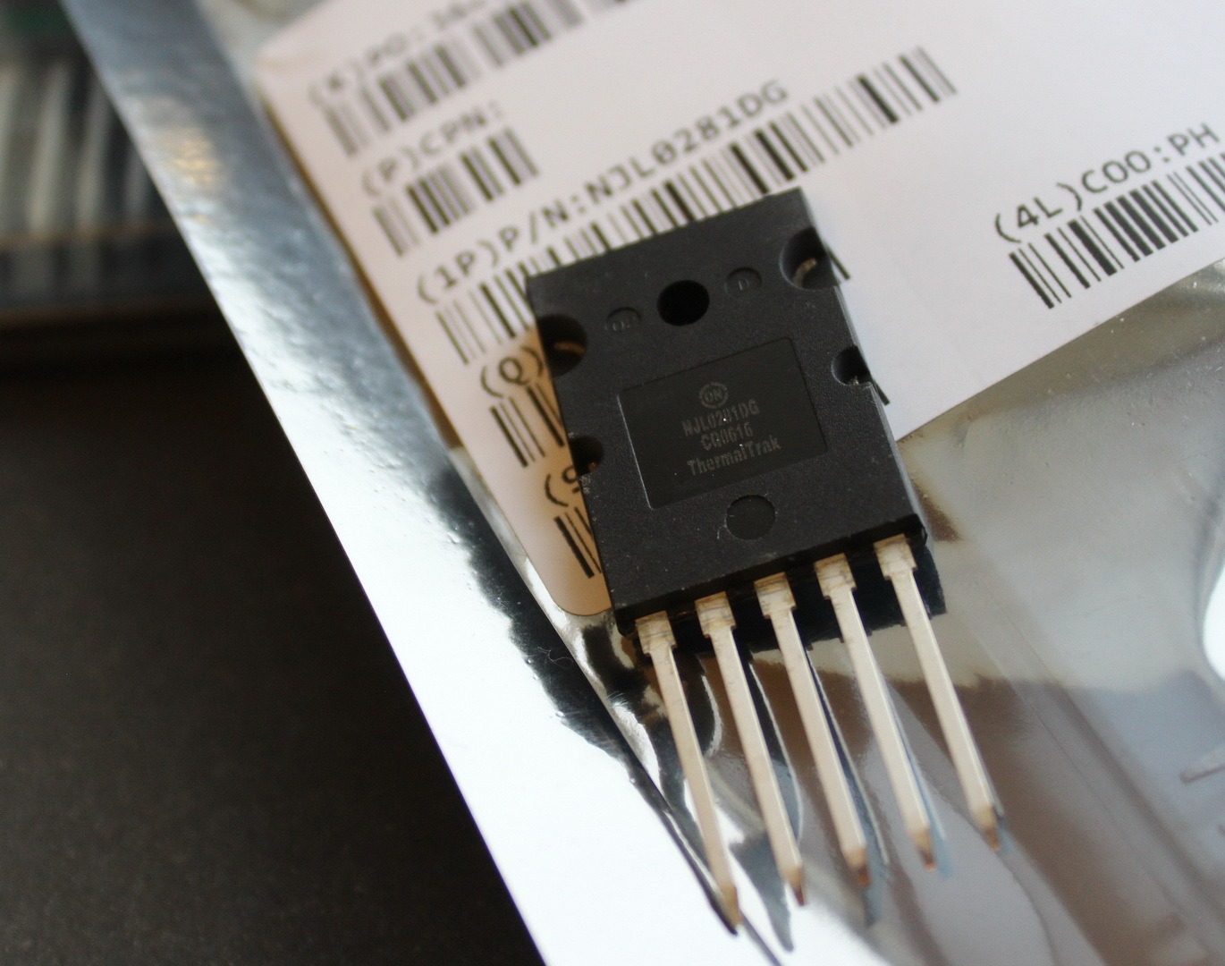

CQ=Assembly Location according to documents this is probably the Philippines
0616 06 is the year 2006
small marking font

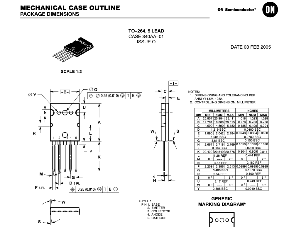

According to the drawing, the leads have the same size and shape
small marking font

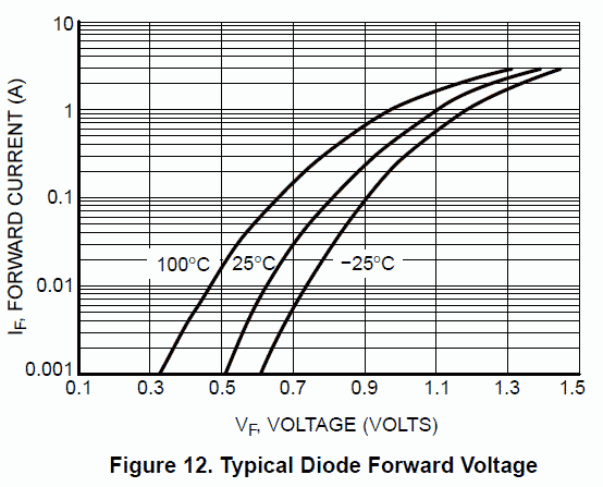

From 2007 datasheet diode voltage at 25C and 1mA is around 0.5V +/-20mV. A DMM diode test should read around 480mV at 25C.... you could begin with diode checks to see how far from any working original parts, their expected measurements are.
Bob measured 570mV at 12.5mA at 25C (Book Fig 17.30 2nd Ed) and datasheet is just over 600mV.

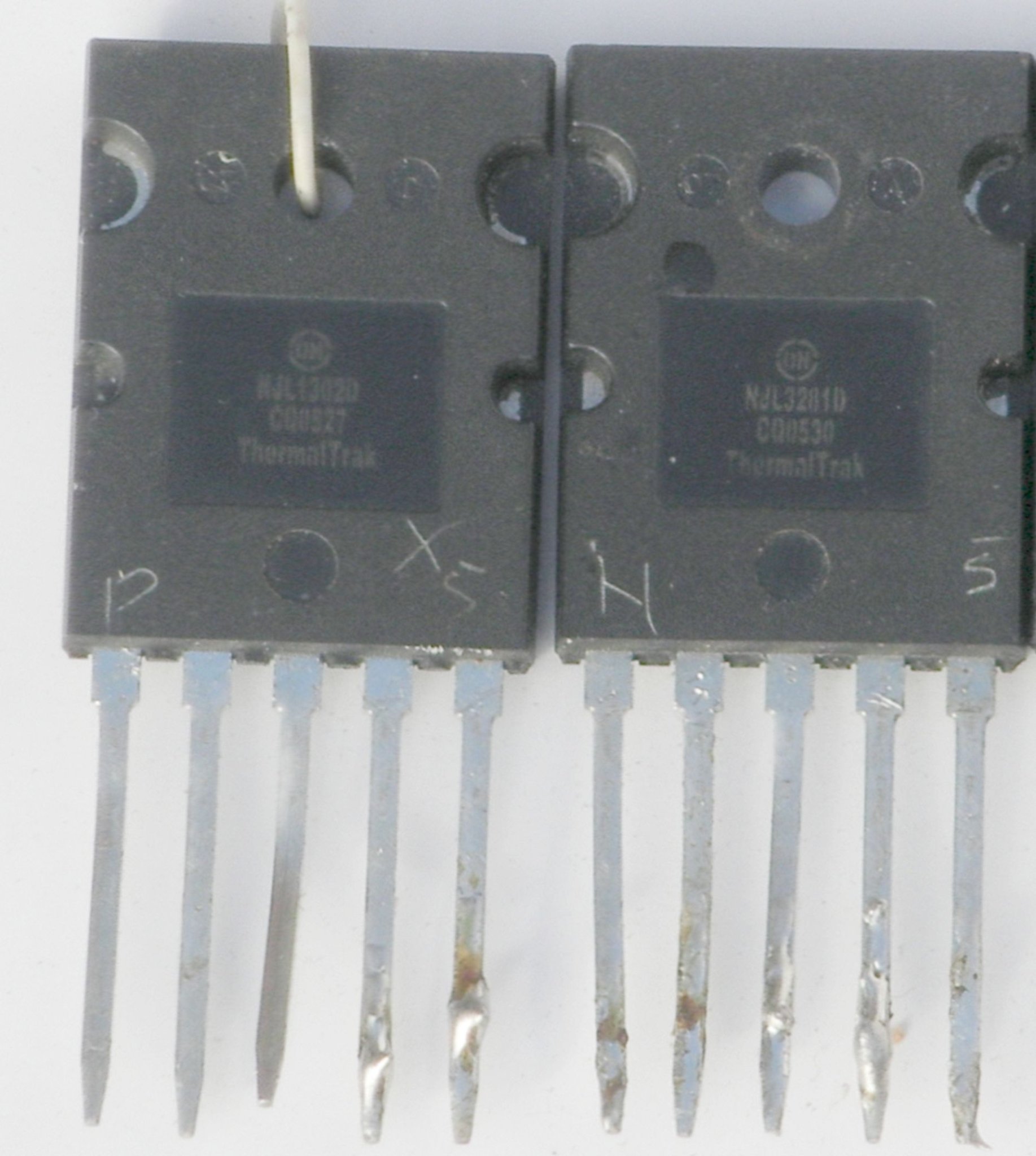

I have one new ThermalTrak diode that's way out of spec. It reads 120mV higher than all my others (and the datasheet). It is NJL1302D marked CQ0527.
It was supplied in a kit (Silicon Chip Aug 2008 kit KC5470) and its complement shown which has a similar date but its diode was within spec.
This kit was withdrawn after some amps failed due to excessive idle current (since they did not use a Vbe multiplier or trimpot, relying on the ThermalTrak diodes being consistent). The next SC version amp had a quiescent trimpot.
I didn't find any explanation from OnSemi or SC as to why some ThermalTrak diodes were so far out of spec. and I haven't heard of any later out of spec diodes. Has anyone else here come across any genuine ThermalTraks that had diodes way out of spec?

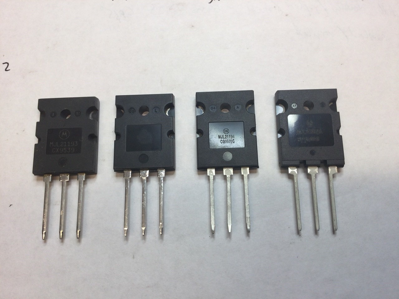

On Semi is what the discrete part of Motorola became, and Motorola used the X prefix to designate prototype/pre-production parts. It is entirely possible that Arcam were supplied with early parts before full production was running, but surprising that they used them in production amplifiers. That would also explain differences in the package too.
These are the boundary values of the graph. This diode should be used at a current of 10mA.diode voltage at 25C and 1mA is around 0.5V +/-20mV
