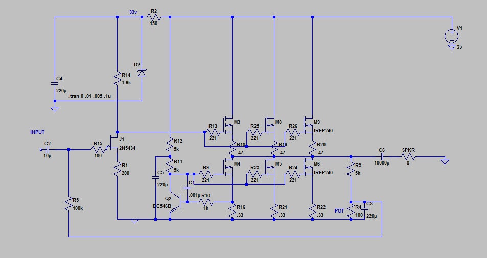

Well I've been fiddling a little more and have come up with the attached circuit as a possible fallback if the CCS input doesn't work out. The input has a set gain of 8x. Not sure how well it will work but it simms OK. It loses a little voltage swing due to the 33v zener but it's not too bad.
Going to lash up a few more CCS circuits now and take some measurements as I'm hoping I can keep the CCS input. Will keep you updated.
Oh, by the way, I'll only be running 2 pairs of output fets, not 3 as indicated on the diagram.

Yes you're right. I think I'm going to stick to my original topology. Anyway, here it is in the flesh for testing....on much too small a heatsink :) It's running pretty hot at 2 amps idle current per fet... have to run it in a shallow dish of water if I want it on for more than a minute. Final version will have a much larger heatsink...
Having made this board I can now see how much space I wasted. Version 2 will be much neater and more compact.

Bias is set to 2A per device. Confirm.
Total bias is 6A. Confirm.
How can your 5A PSU supply a continuous 6A of bias current?
Test load is 8r0. Confirm.
Test voltage is 15Vpp = 7.5Vpk = ~5Vac Confirm.
Is the test load returned to ground or returned to +ve supply.
The current demand on the PSU is completely different for these two load return topologies.

Bias is 2A per device, total bias is 4A (4 fets total)
Rail voltage = 30vdc.
Load = 7R.
Test voltage is as you determined (5VAC or thereabouts).
Speaker is returned to ground, though as you mentioned I should try returning it to v+ to ensure constant 4A current draw. That may solve my problem so I will give it a go.

7.5Vpk across 7r0 draws just over 1Apk.
The supply rail current will vary around 4A+-1A, i.e. from 2.93A to 5.07A even when the amplifier and the load are still working in ClassA.
Reduce your device bias to 1.5A and try again.
Reduce to 1A bias and try again.
Now move the load to the +ve rail and repeat all 3 experiments.

Dropped the bias to 1A. Problem solved as expected.
