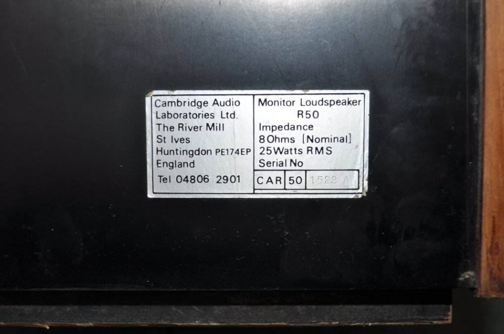

Hooray I won the complete speakers I wanted and then double checked the maker's Museum pages to discover that the speakers were rated at 15 Ohms, oh b***er I said to myself several times. Never mind they only cost me £25.00 plus £15.00 postage, less than the £45.00 before postage for the 2 I didn't win.

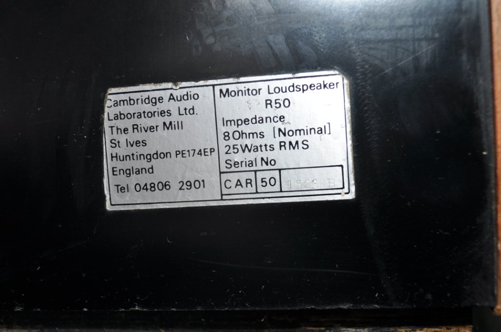

They arrived today, connected them up and for the size of the cabinet sounded quite good. Lets have a look inside, so undo all the screws and take off the backs remove the loft insulation and what do I see..... a lovely sticker that says 8 Ohms, someone is smiling on me at the moment. All shiny and as good as new!

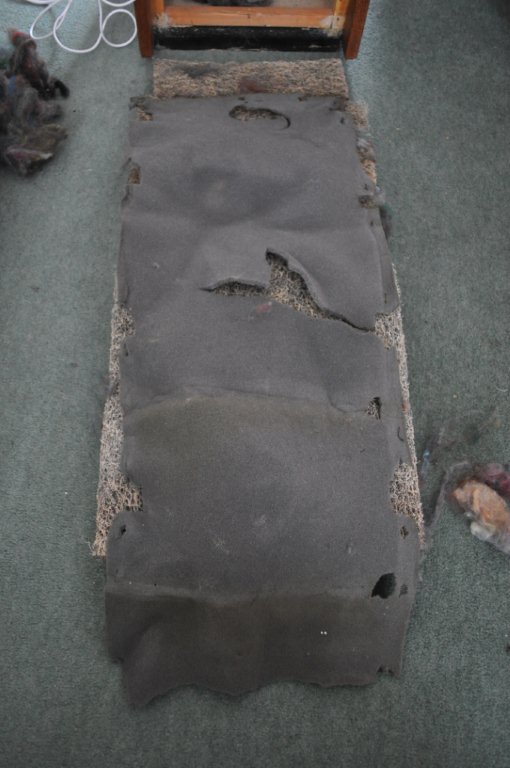

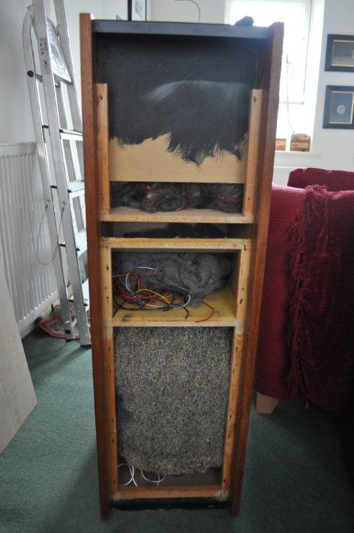

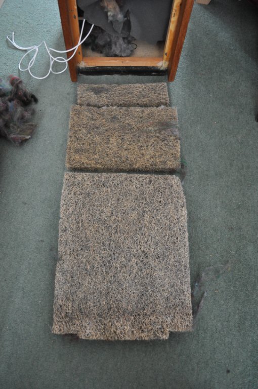

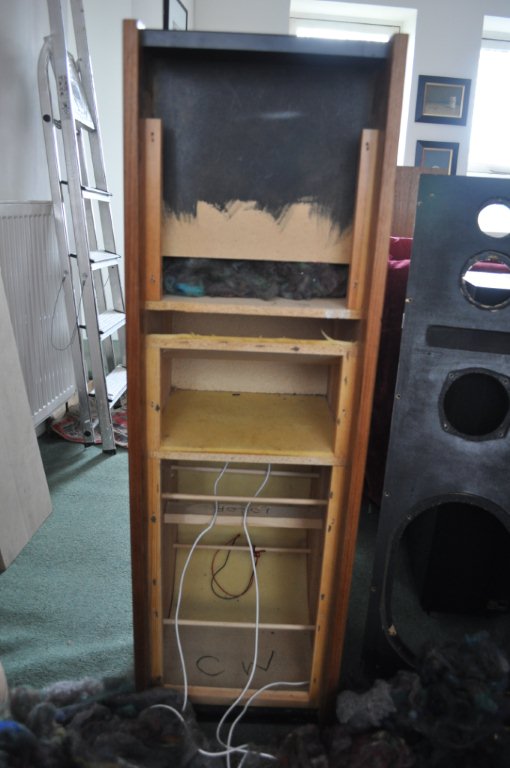

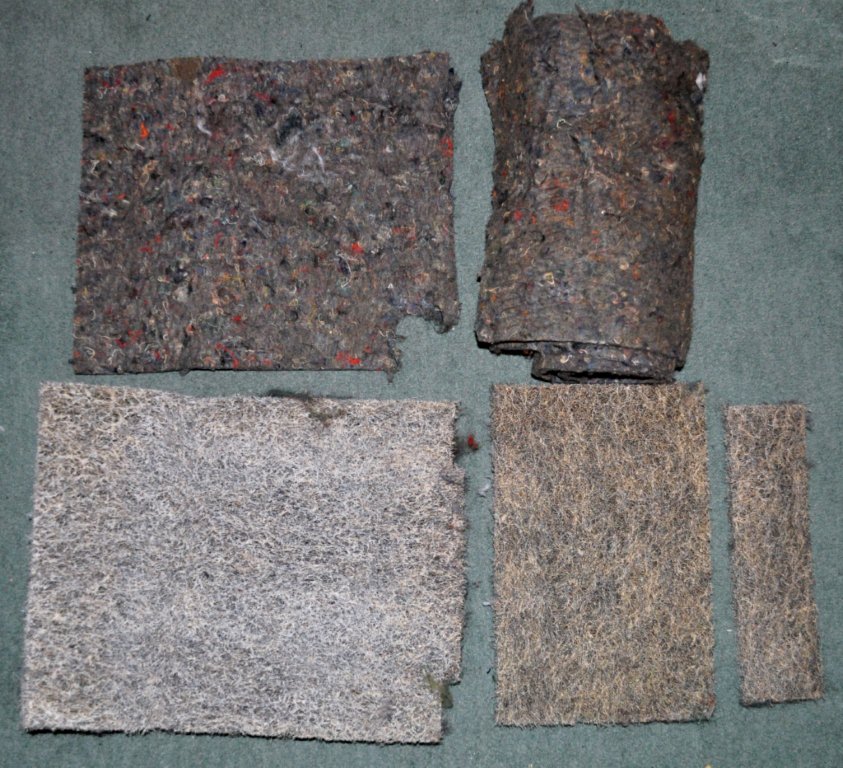

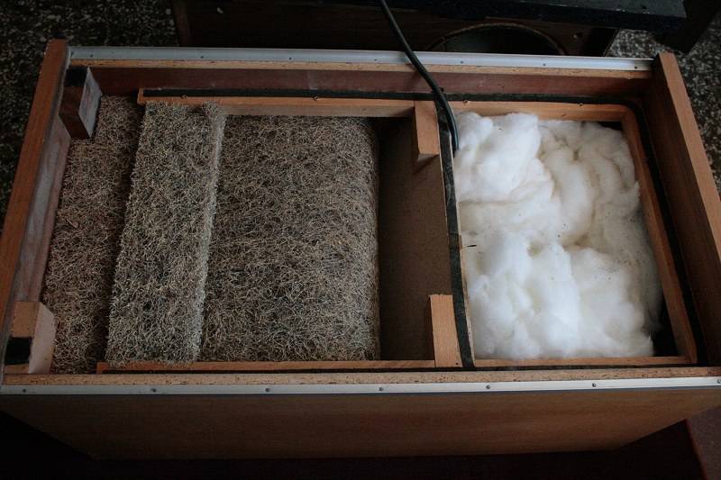

The R50 is the B.J. Webb TLS and according toe Webb one kg of lambs wool per cabinet evenly distributed is the damping. The Webb design states that a plug of open foam should complety fill the opening of the midrange pipe. No qualities or measures are given but on the drawing the plug appear to be about 6 cm deep
With the whole pipe filled the design will work as a closed box with some resisitive venting. And clearing the last half of the pipe of damping material will not give that much of quarter wave behavior as the final section is only 1/3 of the driver area I expect the pipe itself to have substantial resistive losses.

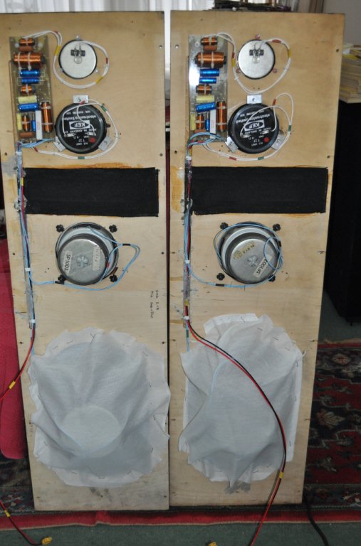

Thanks. It appears that, as the cabinets were built, not by Cambridge, that just the space behind the B139 and the last part of the line has wool in. The first part of the line has a thin layer of foam attached to the rear of the cabinet. I intend to staple foam carpet felt to the side walls and botton of the lower chamber in the hope it will help. I am still hoping that someone will answer my requests for pics of the inside of good R50s to help, lets wait and see.

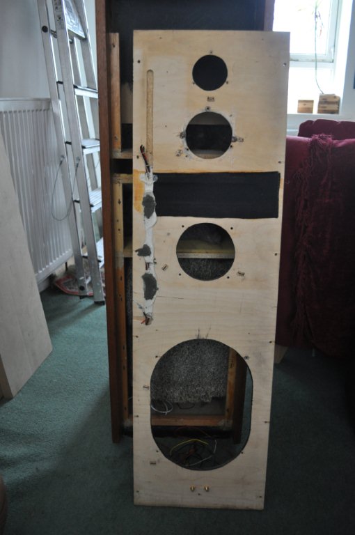

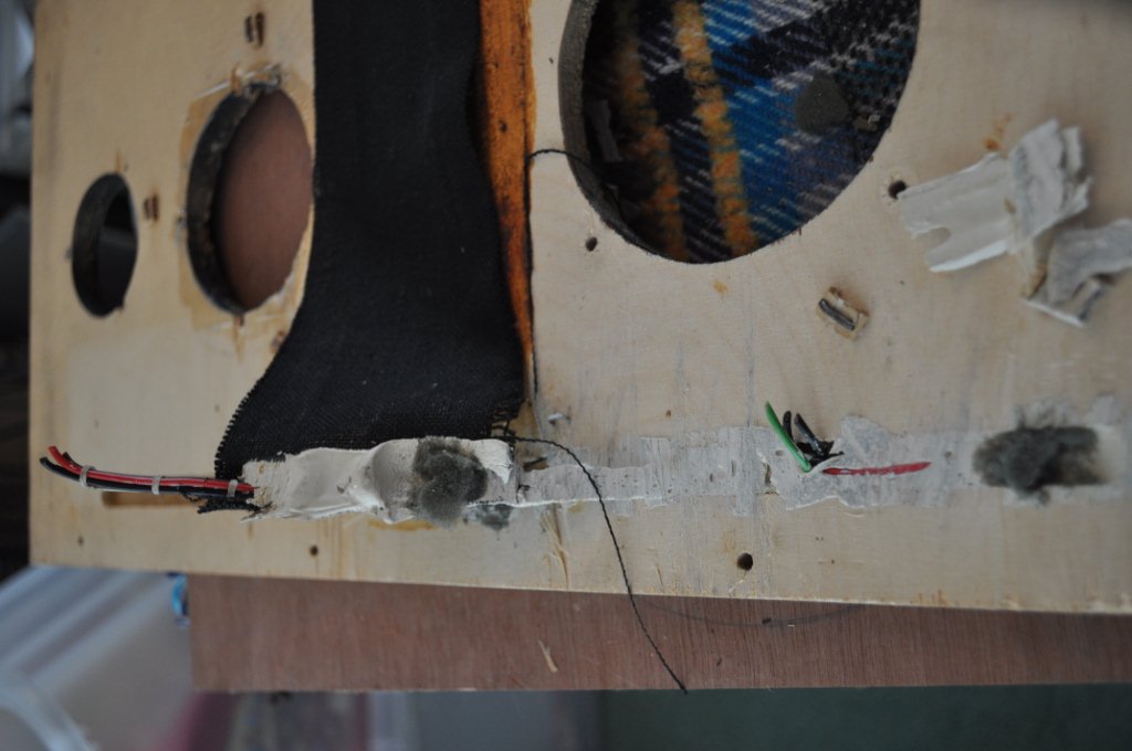

Managed to clean up the baffle boards, getting the old wiring loom out of the slot cut for it was a pain, but I have managed to keep the cloth from the vents for the B110 ports. The wiring looms were pretty well built all neatly tied together.

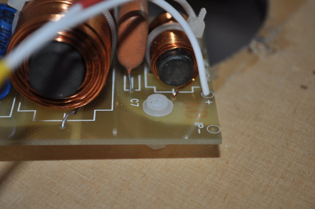

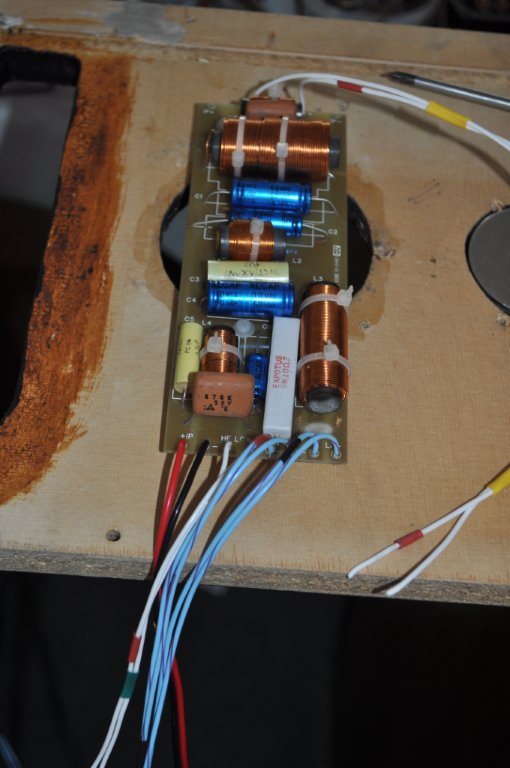

I have now built up the new crossover from Falcon and started to put together the wiring while I get the drive units.

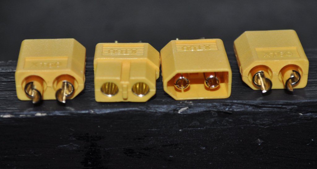

I have decided to make sure the baffle can be easily removed from the speaker so have bought some XT60 connectors. I think they are used in RC models bit are a gold plated and appear to have a very good current rating. Photos below.
Still looking for Kef B110s at sensible prices so, pehaps foolishly, I have ordered a pair of MONACOR SPH-135C units, but they were inexpensive. I can see myself getting a pair of new B110s from Falcon if all else fails and perhaps some new Coles 4001 as well.

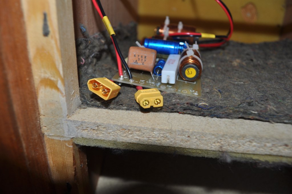

Wired the crossover with 16 AWG silver plated copper wire for Bass units and 18 AWG silver plated copper for the high frequency units all held together with heat shrink and +ves marked.

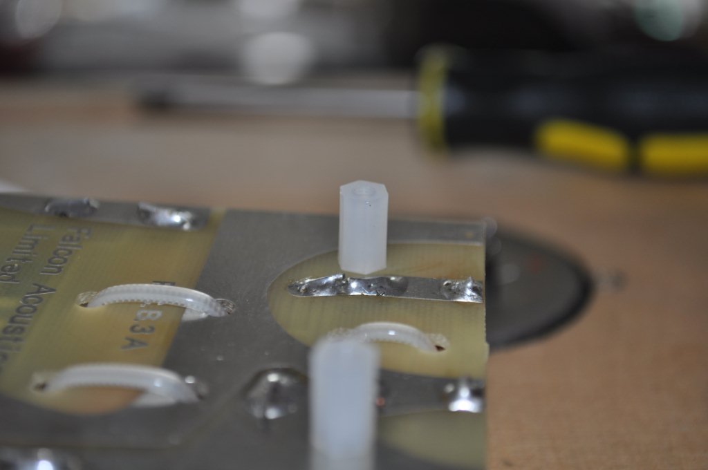

Decided to try to be clever fitting the ctossovers so bought some M3 nylon standoffs and nylon short bolts for the crossovers and fitted to baffle with metal M3 bolts, no chance of shorts and seems to work well.

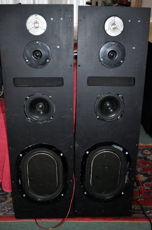

I have managed to keep the original baffles, that were nearly murdered while with Baobab but have been rescued with the help of my son who made up some little threaded plates used to hold the T27s. Even the little bits of cloth covering the B110 ports is original.
I couldn't wait to complete the work on the cabinets so they went back together yesterday. Very different sound to my Paralabs, the top end on the R50s is more forward and not as delicate and the bass seems so much better and faster. I will live with them for a while and see if they grow on me. They sound better, this morning, than they did yesterday.
