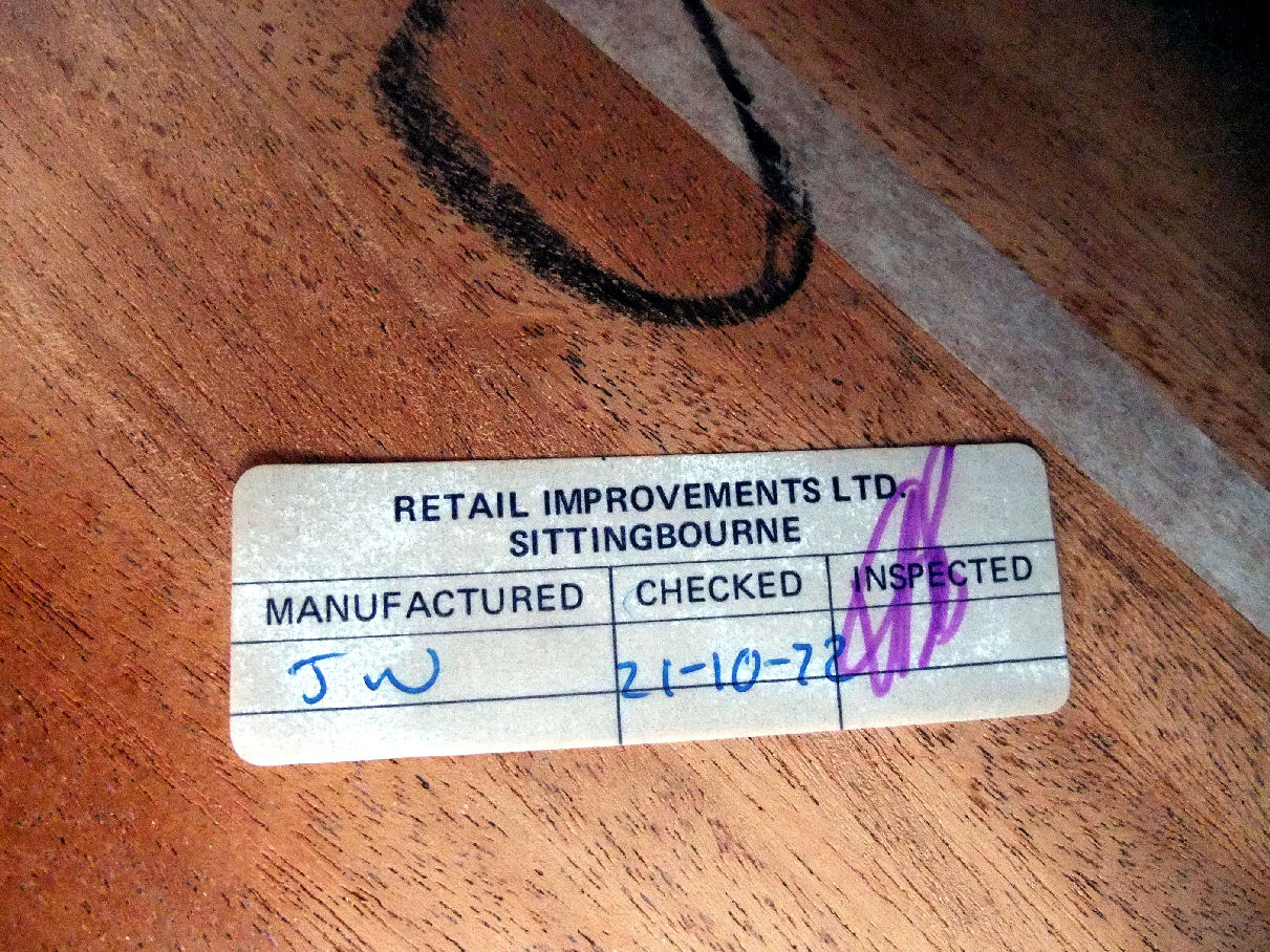

I was fortunate at the age of 24yrs in 1972 working at a shopfitting company in Sittingbourne Kent UK was able to cut and assemble these R40 & R50 speaker cabinets for the Cambridge loudspeaker company.
I am now 65yrs and 41yrs further on i had to wait to only just obtain my first pair of original R50`s.
When each person assembled these speakers when finished there initials were written inside on the bottom and mine have JW and John worked on the bench next to myself so i would of helped him take these speakers to our large press when assembly was complete and the glue was all wet ready for it to cure which took about 2 1/2 hours, the press was right next to our heater so curing in all weathers was no problem.
My initials are KG so some of you may have those written on the inside of your own speakers cabinets.

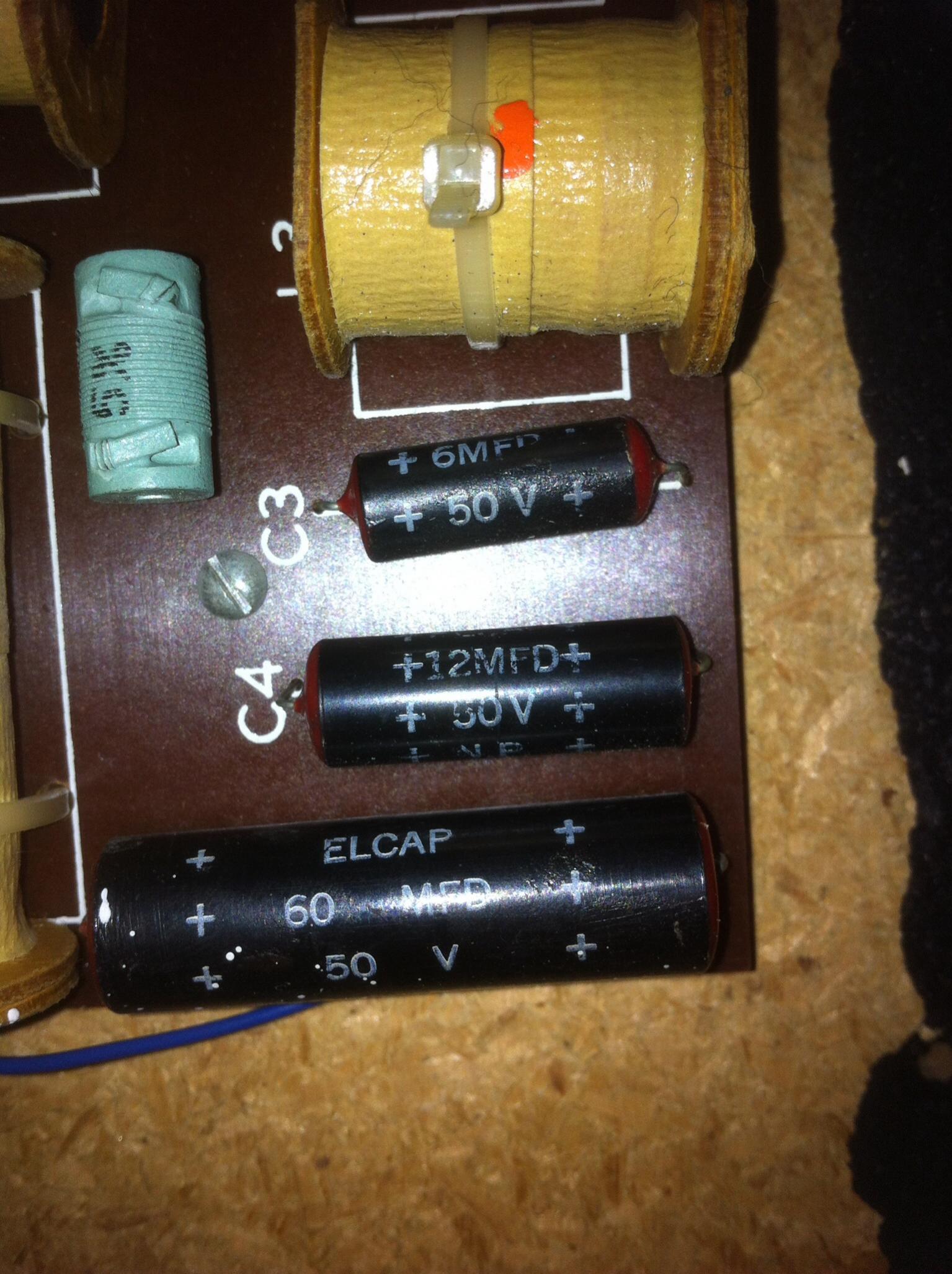

I was very interested to hear that you made the cabinets for the R50s in the 70s. I recently bought a pair myself but they are not up to the standard of the Cambridge Audio made version. The main panels are white melamine faced while the sides and backs (where showing) are just painted gloss white. The front is not a single panel but split into two, one for the two HF units and one for the mid and bass, the gap between them forming the end port of the mid line, this being the full width of the speaker. Inside it does have the right wool filling and uses chicken wire to keep off the bass driver.
Now the seller told me he got them off a friend who worked for Cambridge Audio in the 70s and they were a prototype. I didn't think much of this story when I looked at them as they were very much home-made. However when I managed to get to the crossover I found that the capacitor values were not the same as those on the circuit diagram and I think it's unlikely that someone who made them up at home would go to the length of playing with the crossovers, so I think there may be some mileage in the story after all. Perhaps Cambridge played with changing the values before going into full production. I was
wondering if you were aware of the existence of any such prototype speakers from your work with Cambridge.
Incidentally rather than change back to the standard values (as the inductor values are unmarked this could potentially have a very strange effect on the crossover points) I replaced all the caps with individual equivalents from Wilmslow audio and they sound lovely. The nicotine staining on the melamine could not be cleaned well and hence I took the decision to cover them in wood effect vinyl as a temporary measure while I consider other potential options in the long term.
Thanks, Lawrence

It was a shame that your speakers were painted on the sides but i do understand that as even when we were making these the bought in panels the teak veneer was so thin that we often used to just sand through in places and the polisher had to colour them in!...it was very difficult. All was sanded by hand and not by large drum sanders.

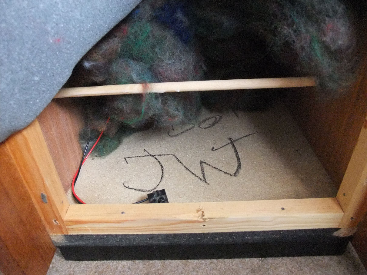

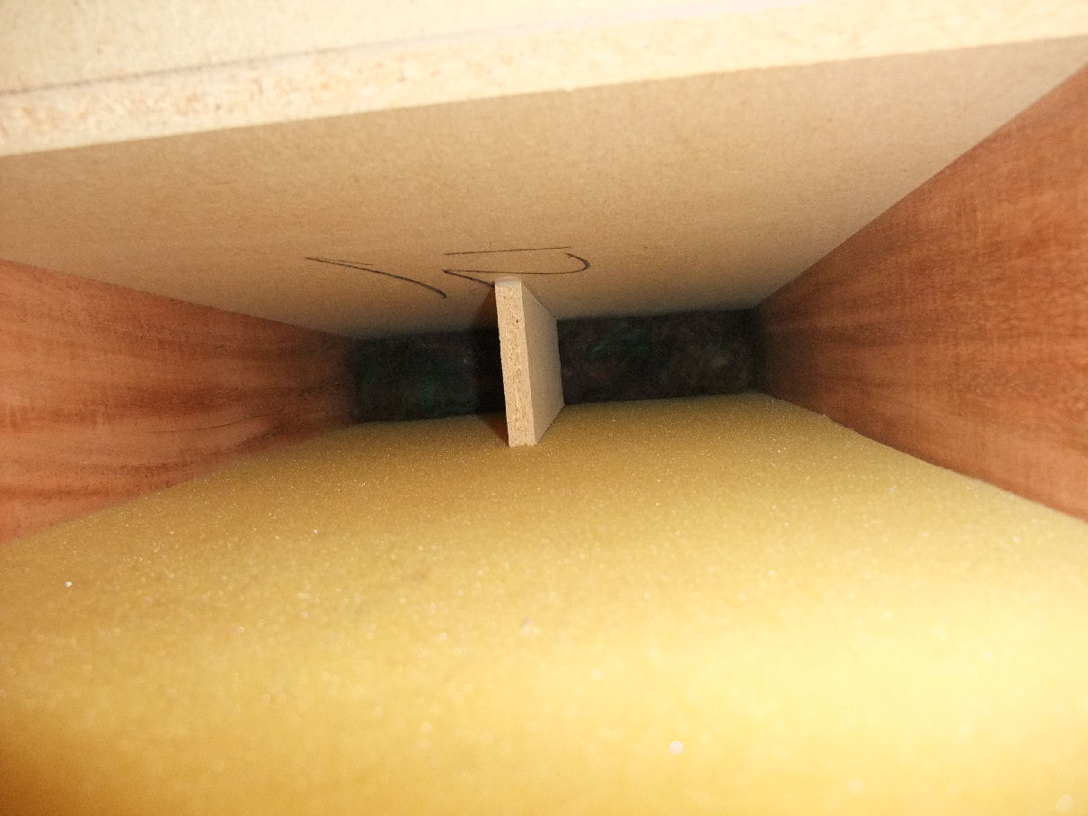

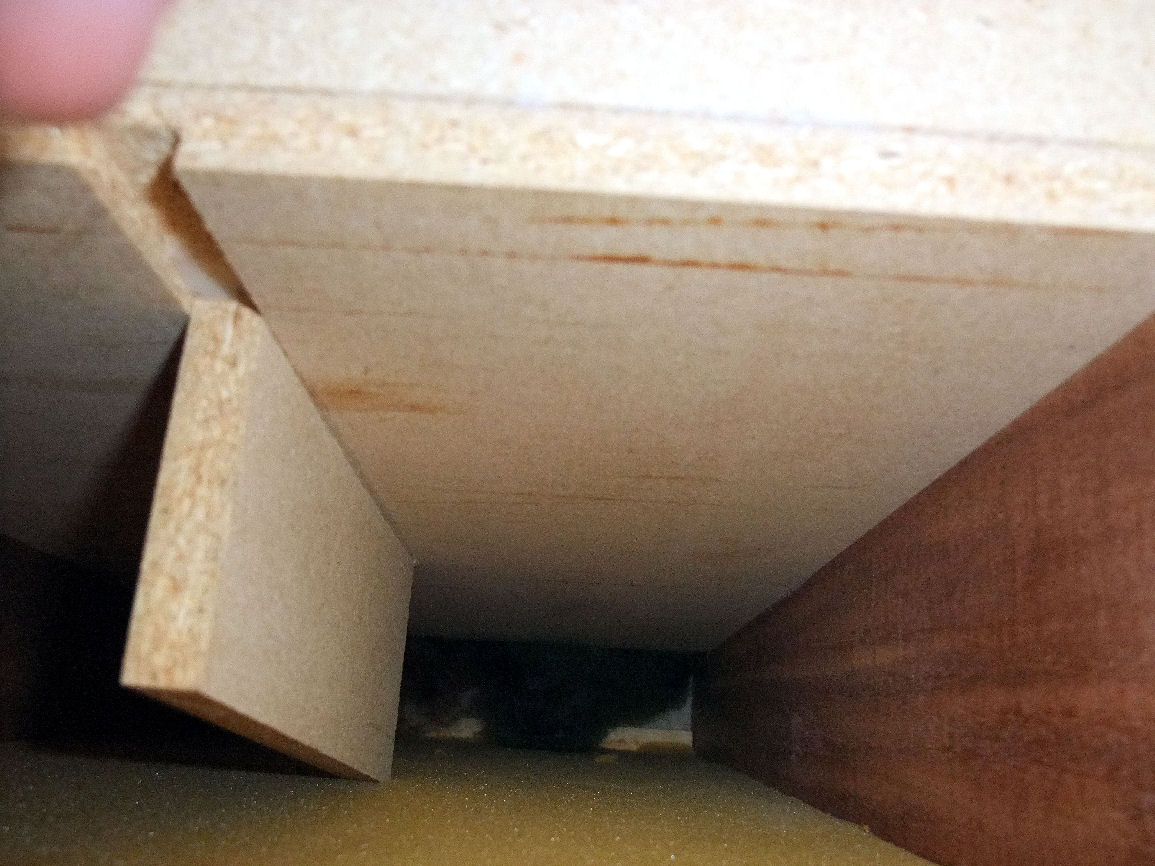

The mention of a prototype i have never heard of but i do know that the pair i have are about the 2nd pair ever made.......they were given to John to assemble as he was a known good cabinet maker but the parts and shapes of the board inside the speakers are ALL different and when assembling he made a mistake and put a piece in the wrong way around.....one is correct and the other incorrect...but they were always kept in pairs where ever they went so i have them now after all these years.....and whats more i can prove that they are the earliest ones by the pictures of the insides and also the label with it`s date. John`s bench was next to mine so i heard and also witnessed the conversation between the foreman and himself.....i talked to him after and saw first hand what he had done so as not to make the mistake myself. Of course as you can imagine loads of pieces of board all dripping with glue during assembly one just carries on and assembles hence the difference.
You can see the piece of wood right inside the tapered rear tunnel where it is the wrong way around compared to the other.
You can also see the lambs wool right at the top of the tunnel where it goes through the various tunneling to the front of the speaker...of course this was all laid in upon assembly....there was no wool in the large rear tapered tunnel but just from the mid range and around the base speaker compartment.
When i opened mine up the wool had clumped and dropped due to the vibrations and so was all teased out again on assembly....i did keep the same wool and the amount is important as we had to weigh it before inserting so the correct amount was in each one.

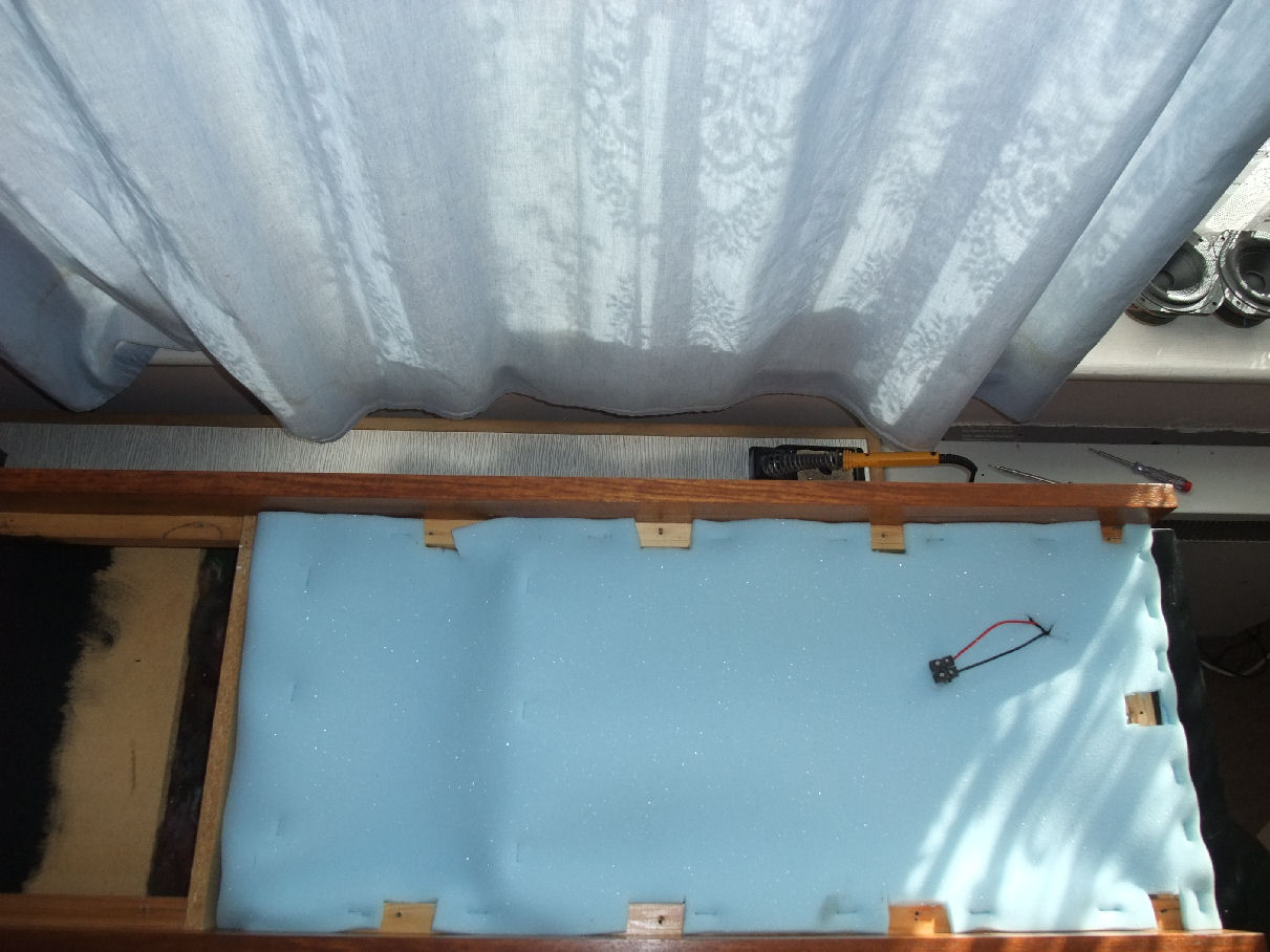

I did replace my foam though with the blue....there has to be a cut out around each screw hole otherwise when screwing the front panel on the screws will grab the foam and spin it around and tear it but you won`t know until you remove it again!
Dear Keith i am in the process of restoring a a pair of 1976 Cambridge Audio TL100 (The export version of the r40).
When i opened the cabinets i found out that the foam was cut behind the speakers possibly from the guy who replaced some caps in the crossovers in the 80's or 90's when my Dad had these.
Now i was looking for a replacement and didnt know what type of foam to use so i ordered a 5mm (same as original) acoustic transparent foam .
Is this the right type or i need another type ?
