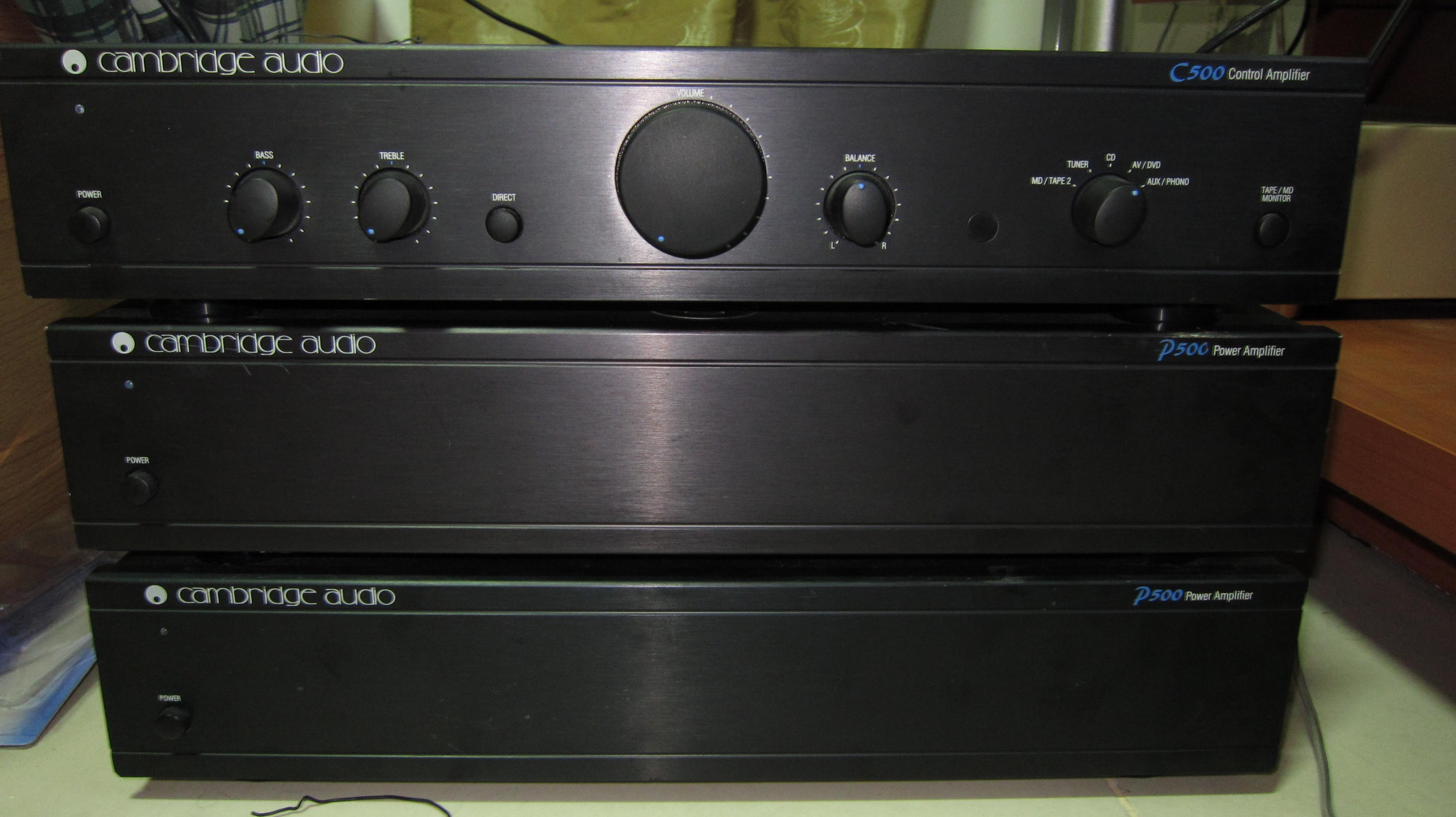

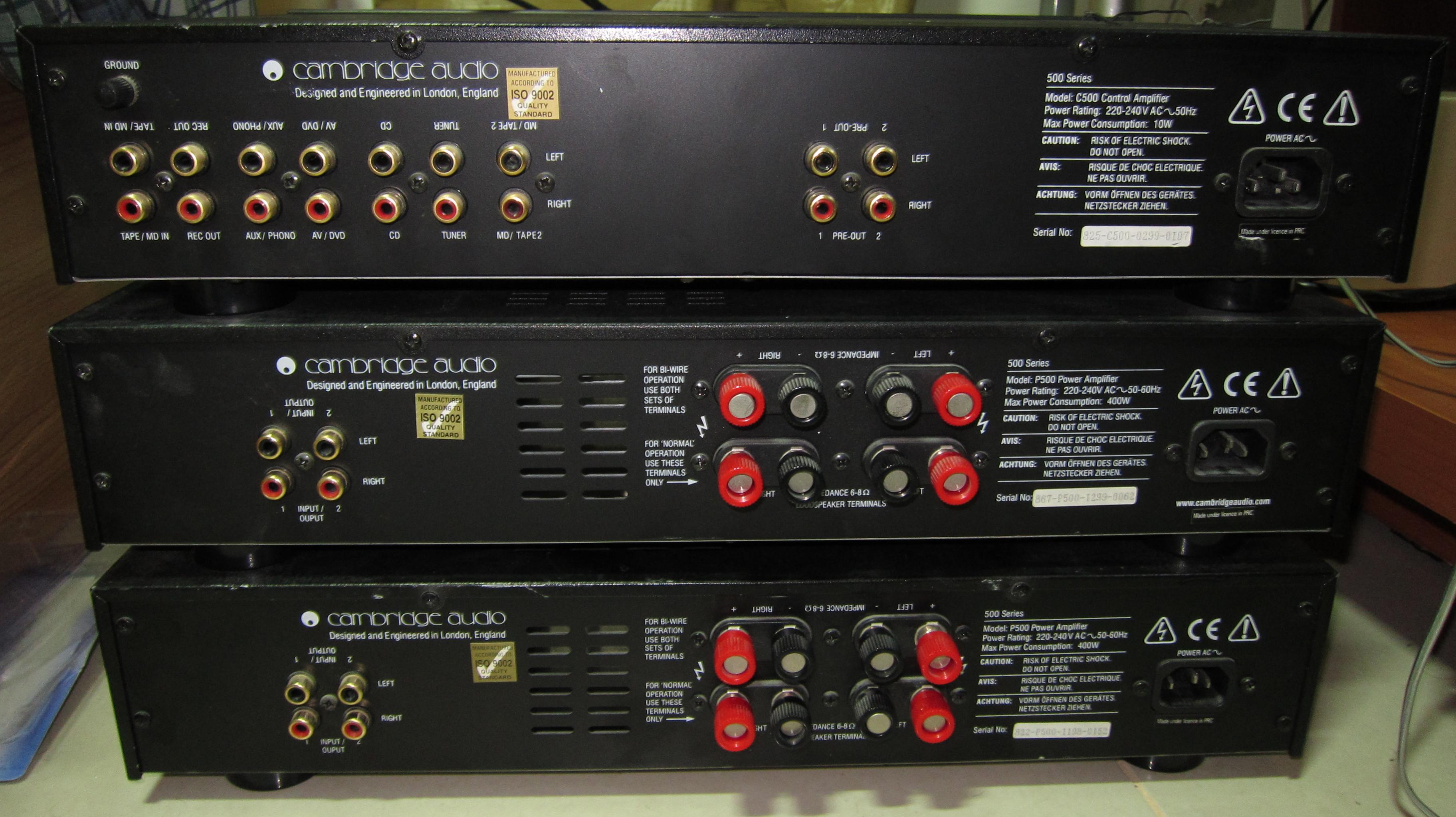

I got a cambridge audio c500 pre amplifier and two cambridge p500 power amplifier from a garage sale. I dont know how how to connect this amps and also i am afraid to connect by my own with out any idea . I will be happy if anybody can provide me the user manual or diagram or photo to interface the system. I could able to find the user manual of this classic audio system thank you.
I have attached the front and back photos of the amplifiers. Thank you

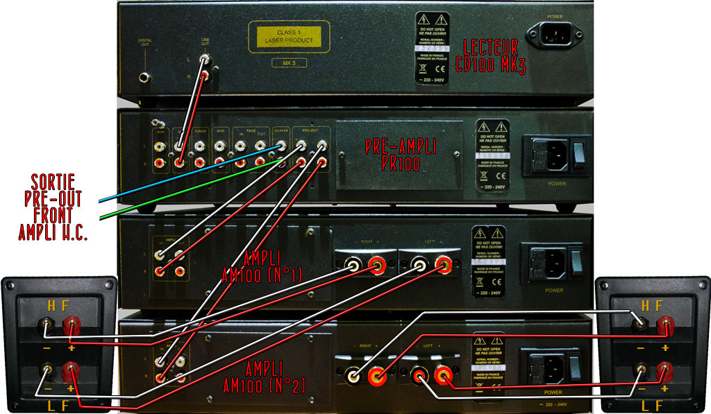

I did the same but there is no sound in speakers. Is it possible to hear the click sound of relay switch inside when switching on? i can see the green LED glowing
i followed the procedure from the image attached.
There are no relays in the P500.
The green LED means that there is mains voltage present. This does not mean that the amps will be working correctly. Do you know that these amps are capable of producing sound?
Have you checked that the tape monitor button is not connected? If so this would not allow the CD input to function.
